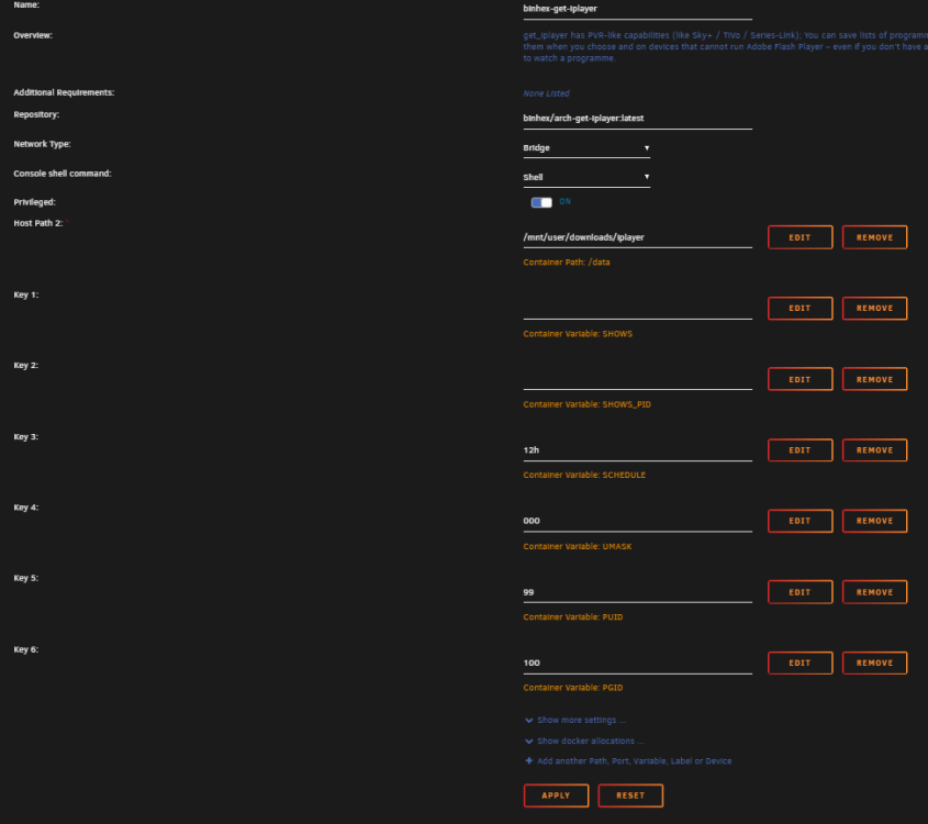

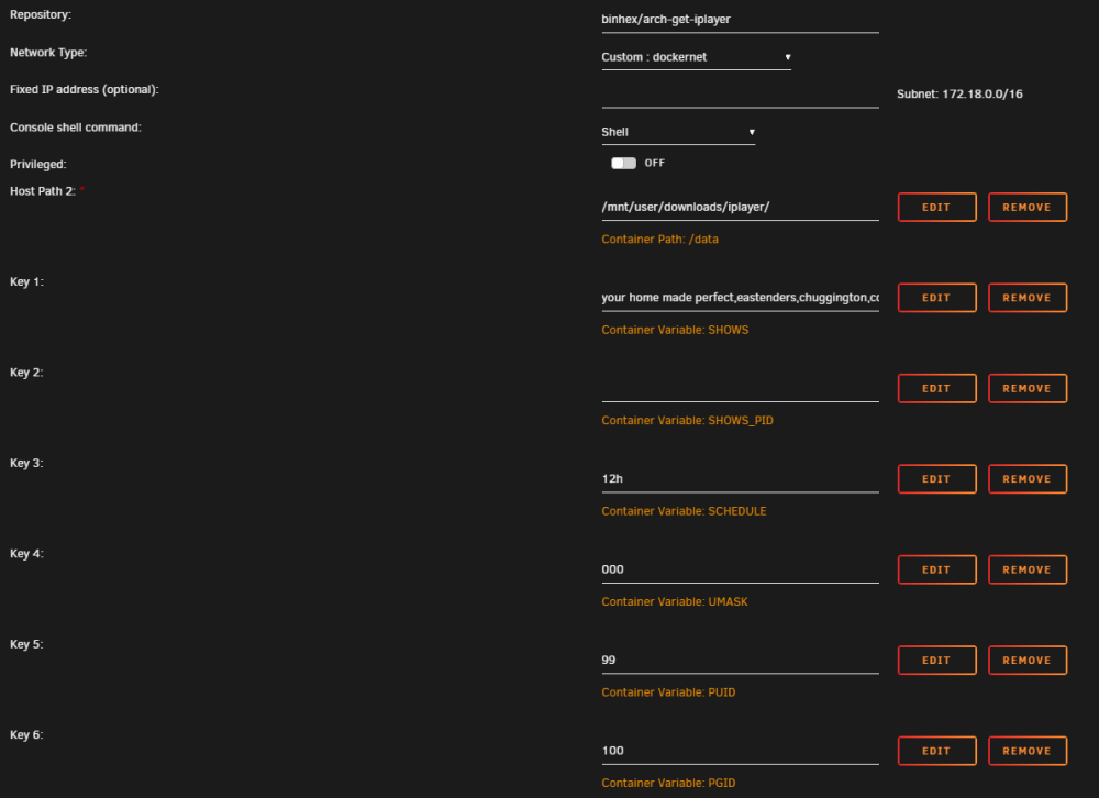

I'm very green when it comes to linux and docker and I'm having difficulty setting up up this container. I've set my config (appdata on the cache drv) and data (media directory within the array) locations, but when I select install, nothing happens. I'm guessing it's waiting for another bit of setup info???  I selected HOST for the network bit. Should it be bridged? If so, what port (default)?
Thanks!!
Bobby
UPDATE: Disregard. I did not have advanced view selected and thus didn't have the environment variables set.
