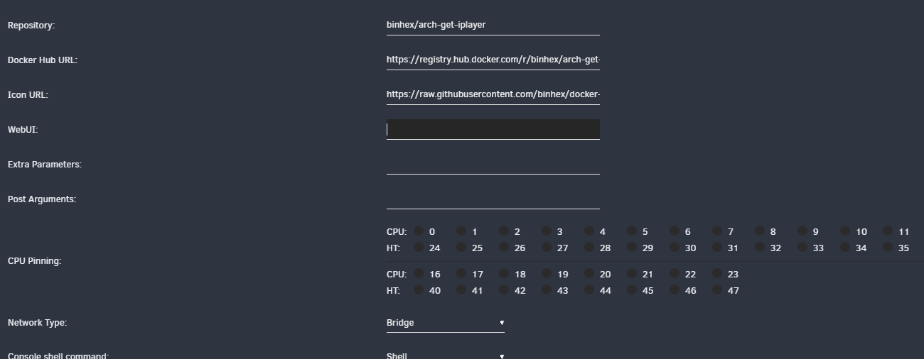

How is the WebUI activated as its currently blank on mine?
Does anyone know how to use a webgui with this??
there is no web ui for this image, you simply define the shows you want via the env var value for key "SHOWS" with a comma to seperate the list and get-iplayer then monitors and downloads any matching shows.
