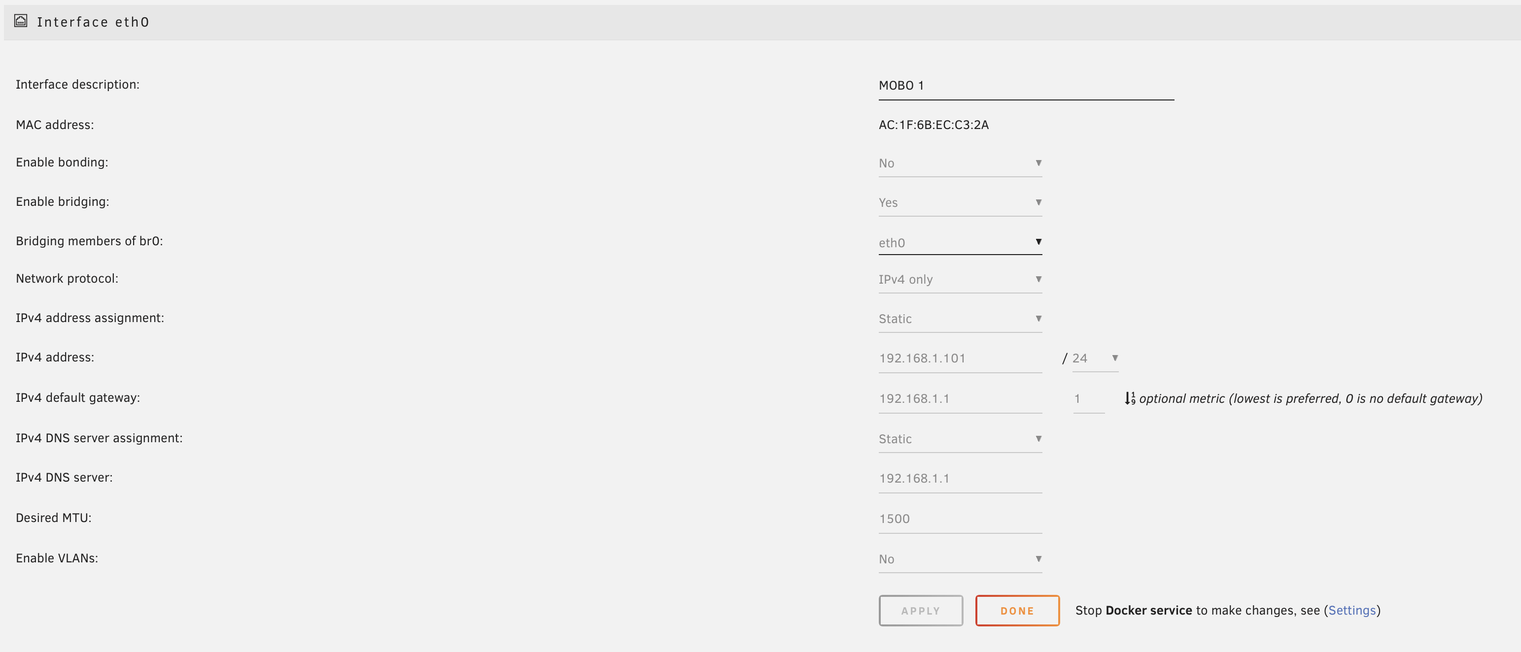

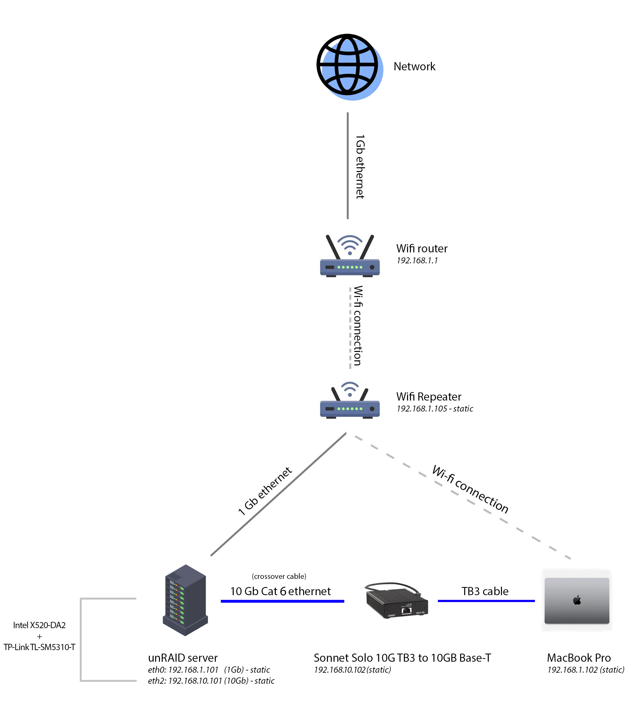

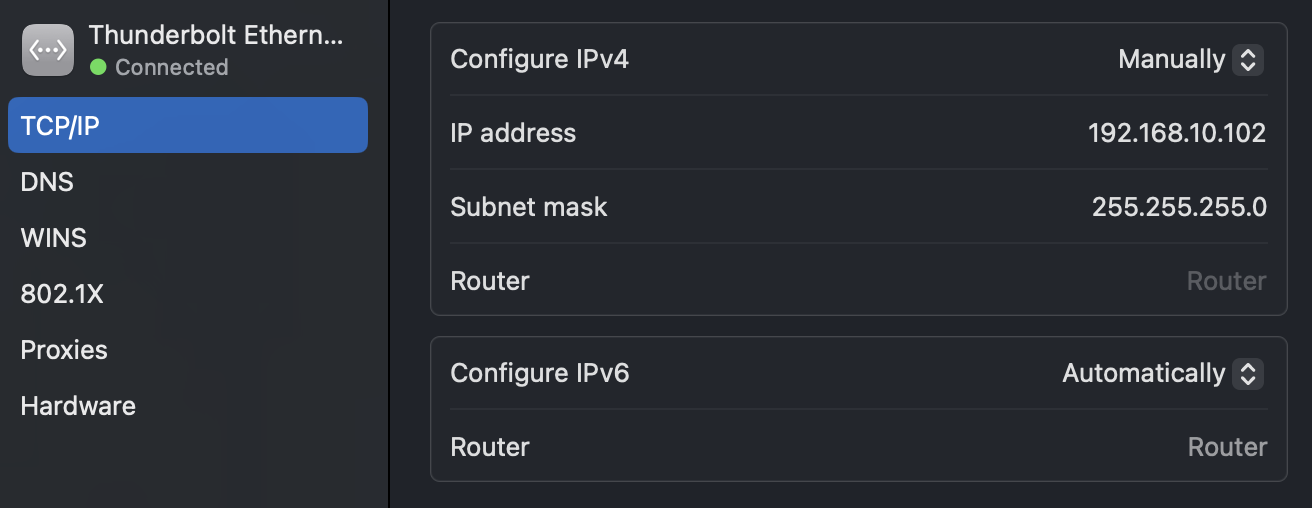

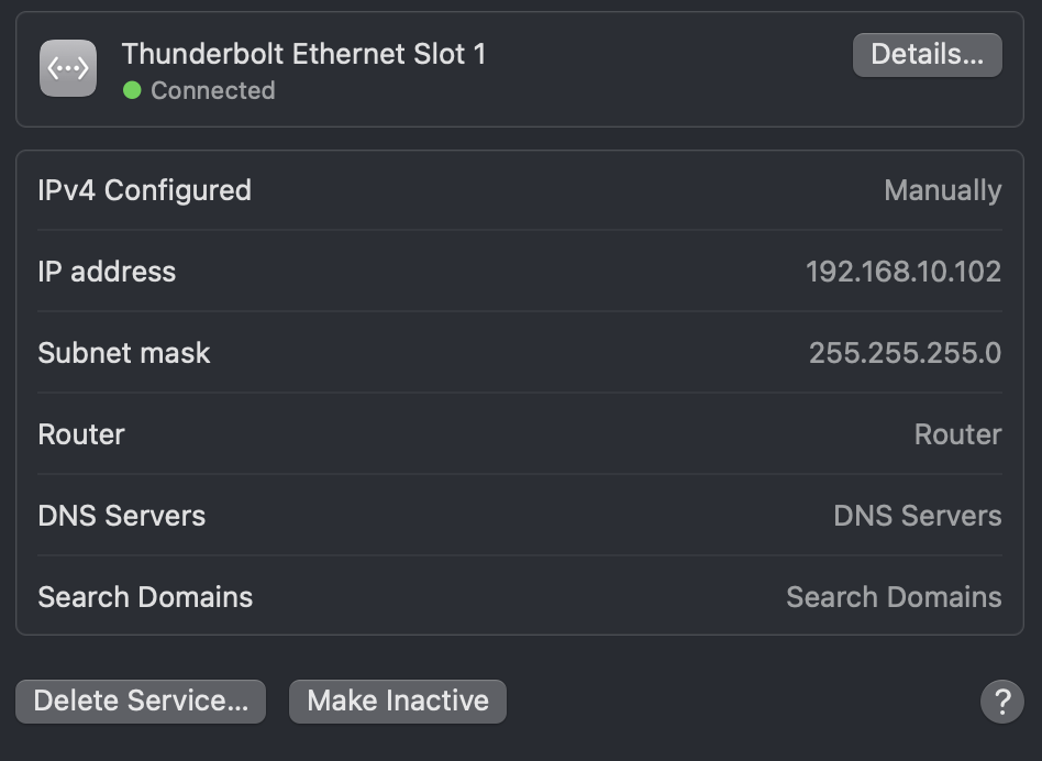

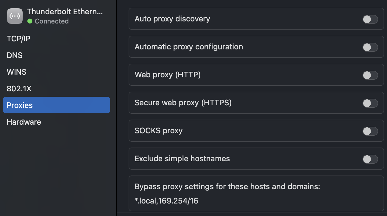

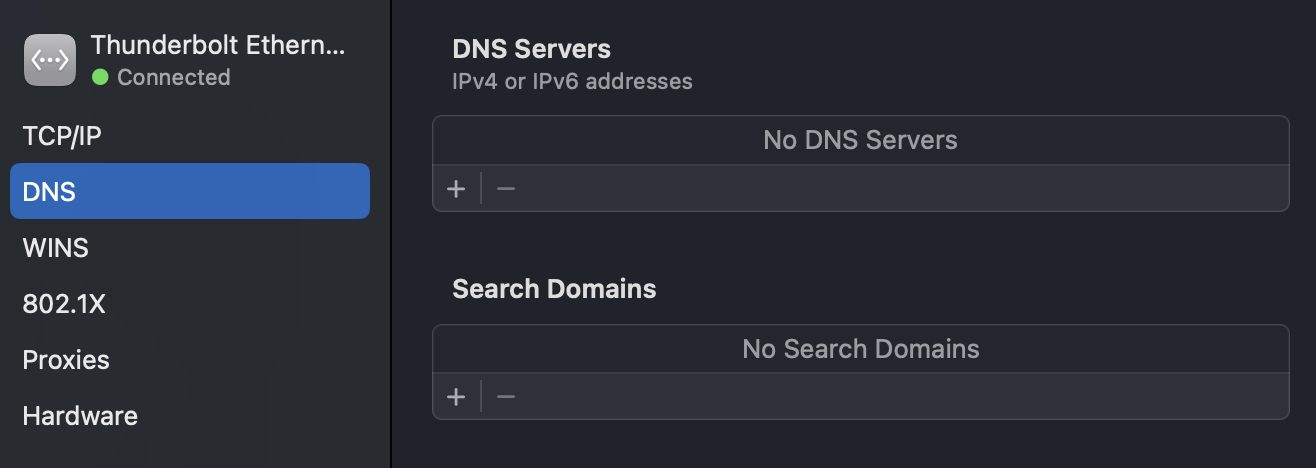

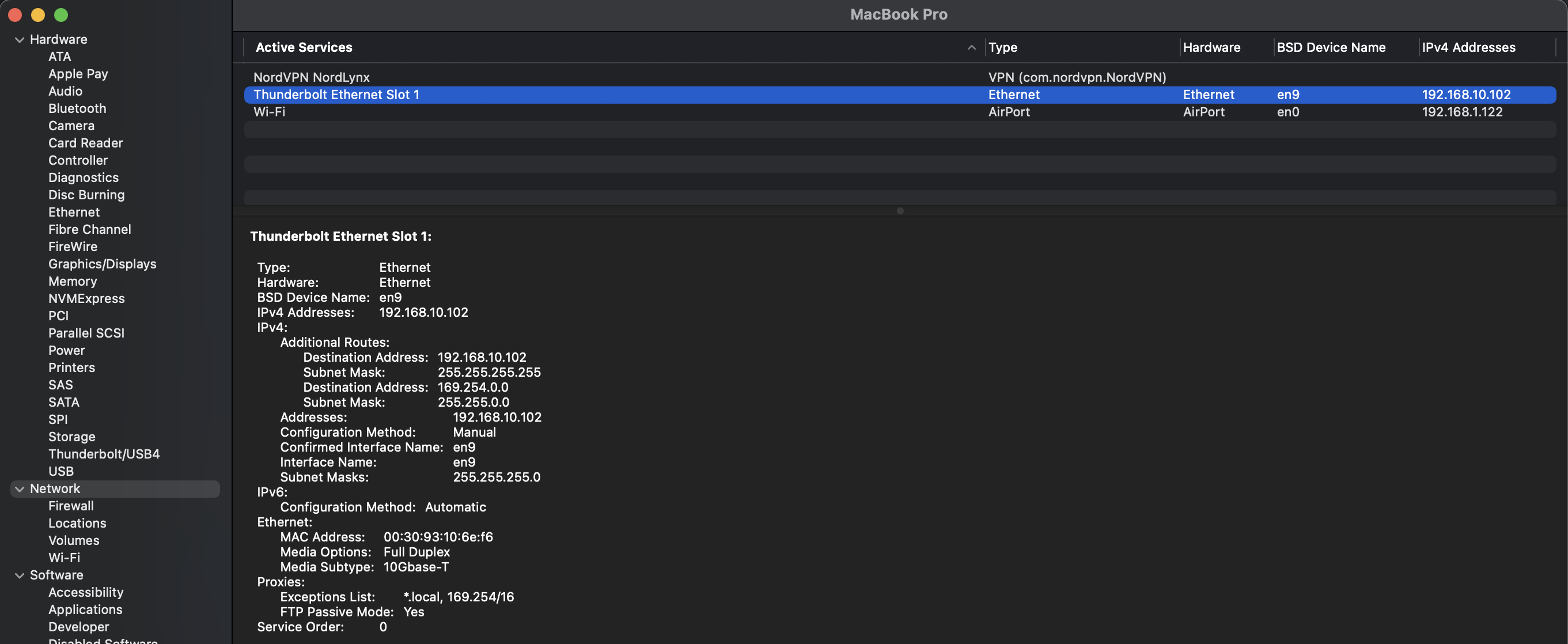

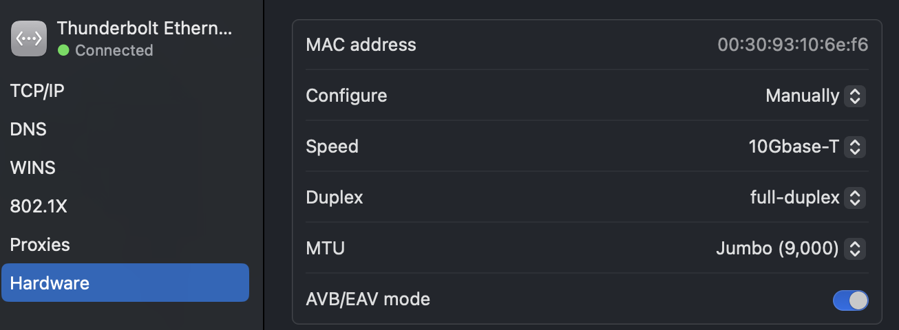

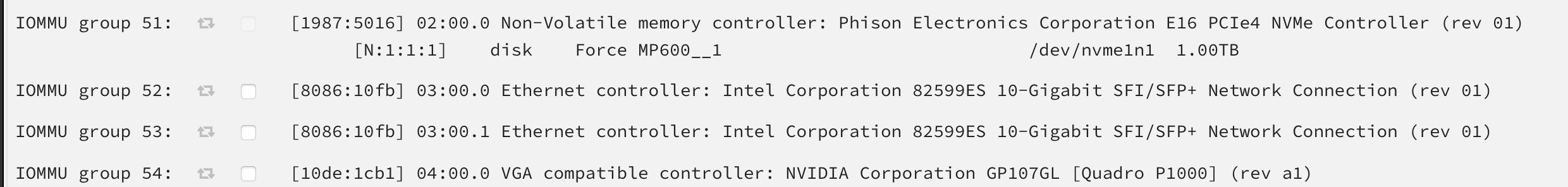

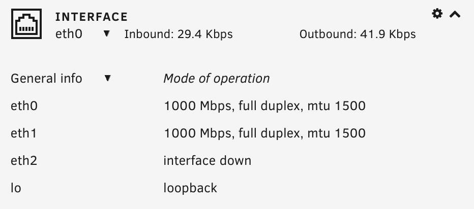

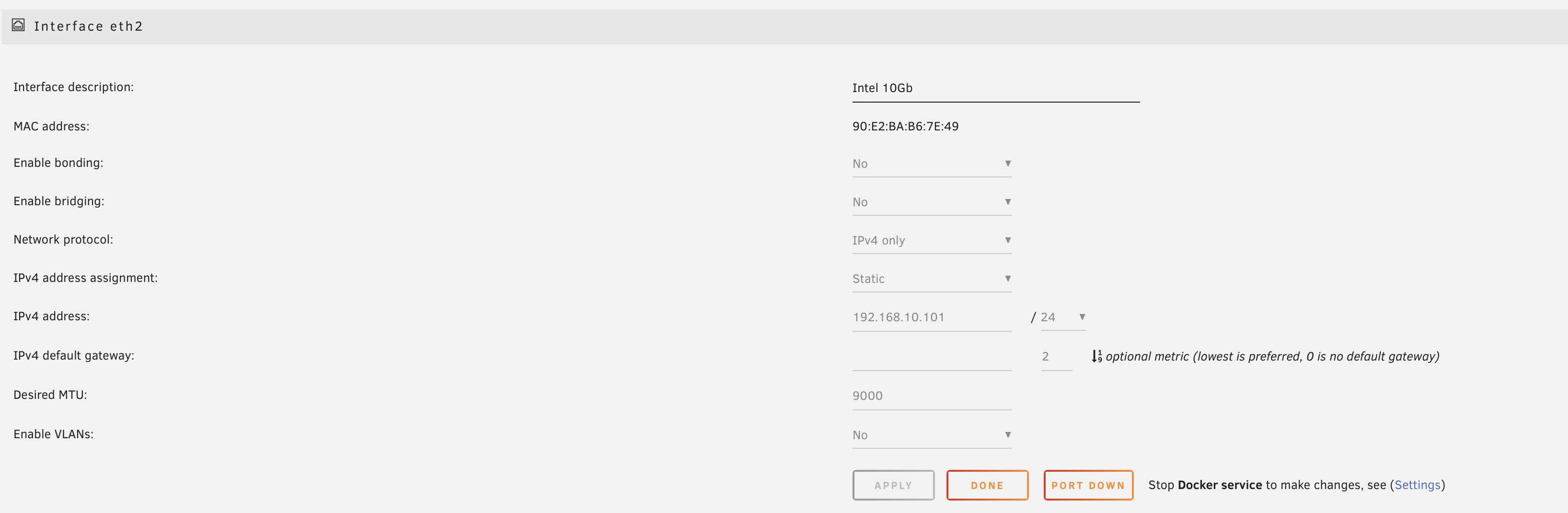

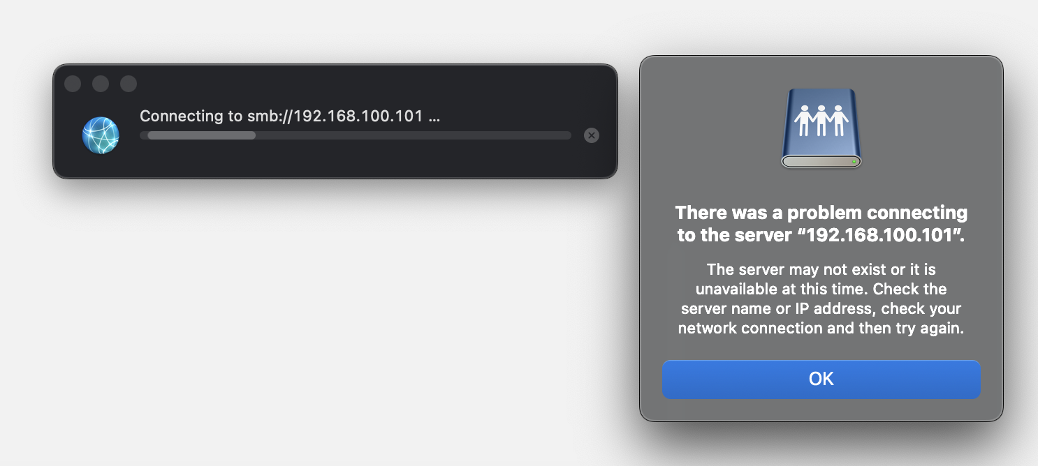

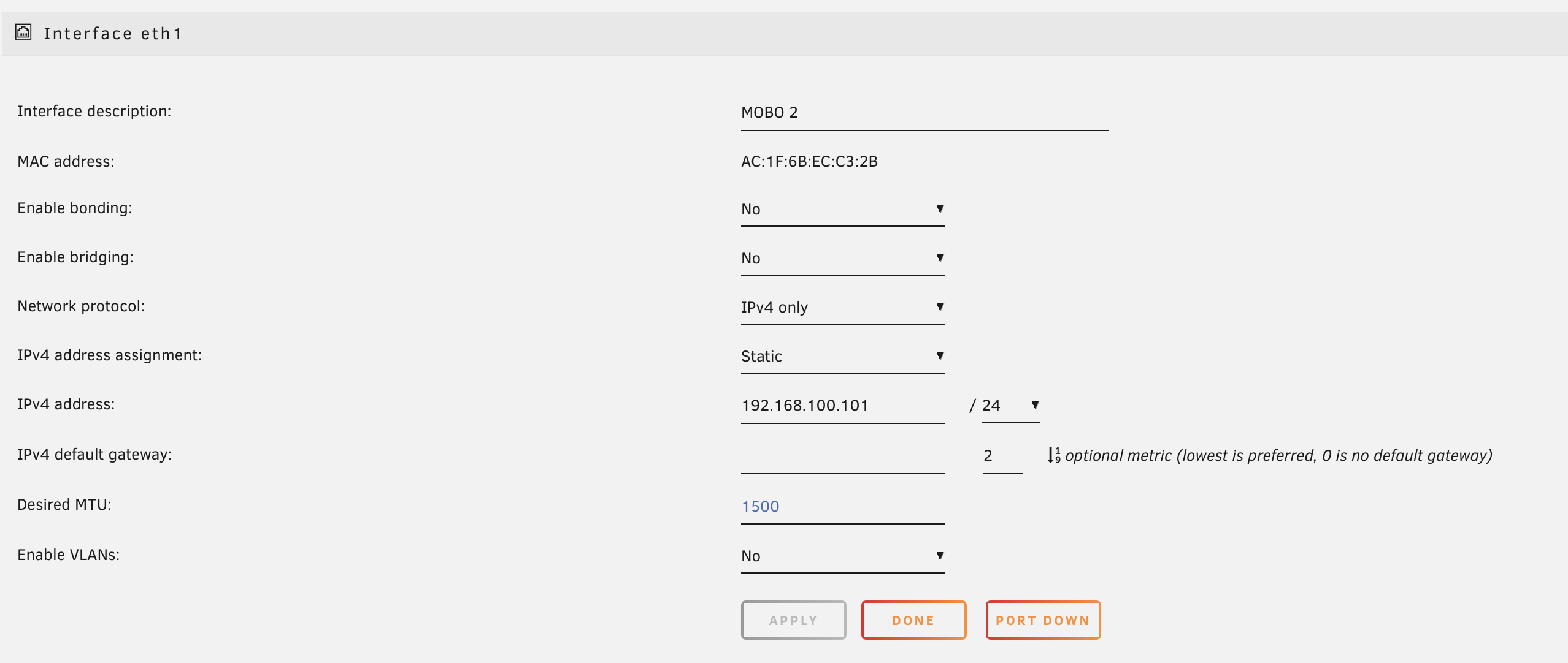

  1. When I connect it to one of the 1G slots it still doesn't work to connect to the server from macOS. However, the TB3 LEDs work, green for the active link, and it correctly detects its 1G (orange led). Also it correctly detects when its connected to 10G link to the Intel NIC (green led). The difference is however, that in UNRAID dashboard the connection via 1G is detected and says 1000 Mbps ... Whereas through the eth2 (Intel NIC) it still marks as interface down (even though the TB3 has led on marking active link). Also as pointed out, the connection to the router via TB3 works as I can access the WAN.

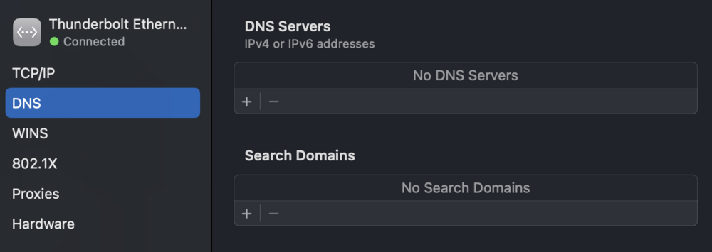

  2. I tried that. Also I tried to connect via ethernet to the router using the TB3 device and that works fine. Via TP-Link TL-SM5310-T and Crossover Cat 6 cable. I believe the IPs are different, one ends with 10.101 and the other 1.101
  3. I am sorry fo inconsistency, the second command I ran without wifi on. This is the correct version:
  4. It appears to be, ifconfig results: netstat results:
  5. adam@Adams-MacBook-Pro ~ % traceroute 192.168.10.101 traceroute: findsaddr: write: No such process adam@Adams-MacBook-Pro ~ %

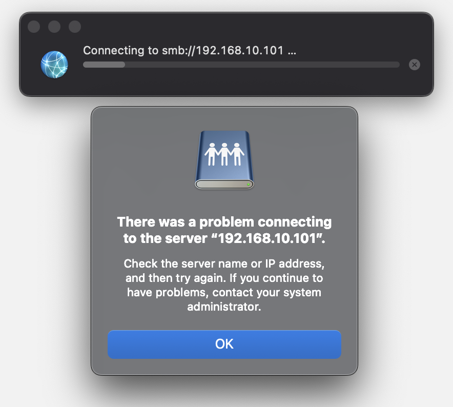

  6. Last login: Fri Jul 26 15:05:00 on ttys000 adam@Adams-MacBook-Pro ~ % ping -c 1 192.168.10.101 PING 192.168.10.101 (192.168.10.101): 56 data bytes ping: sendto: No route to host --- 192.168.10.101 ping statistics --- 1 packets transmitted, 0 packets received, 100.0% packet loss adam@Adams-MacBook-Pro ~ %
  7. I decided to upgade the components in my UNRAID that would allow me to directly link via ethernet cable between my Macbook and UNRAID for faster transfers. I followed the tutorial on YouTube by Space Invader One which is very good, however no matter what I try it just doesn't work. I first tried to solve this on Reddit, where two suggestions were helpful. First I seemed to have the wrong Mask set, this was fixed. I was also advised to change cable. I replaced the Cat 8 to Crossover Cat 6. None of these fixed the problem. The original post is here: https://shorturl.at/SptsL I am attaching below the network topography as well as all relevant settings. I am not sure what I am missing. The components seem to work correctly as they are detected in UNRAID and macOS. I am a beginner when it comes to servers. I am really looking for any suggestions to make it work, because the upgrade was not cheap and didn't bring any results. Thank you! PS.: I tried to connection to UNRAID with both Wi-Fi on and off.

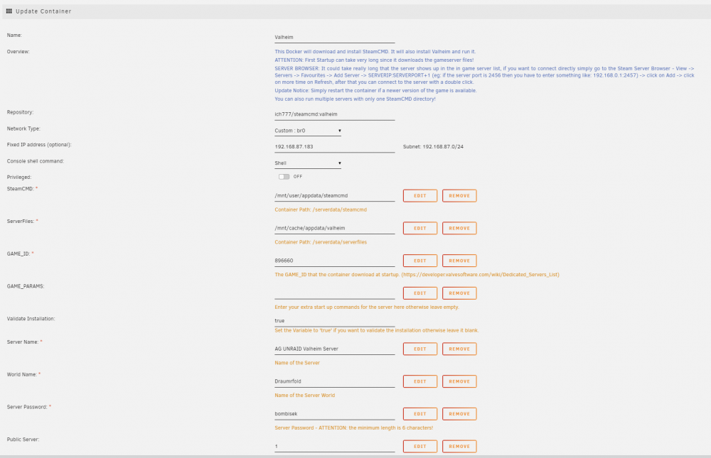

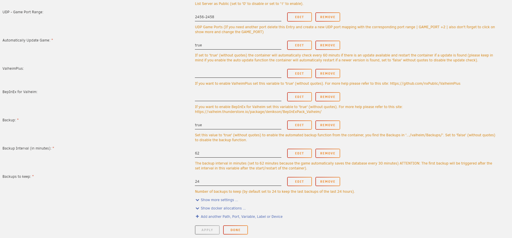

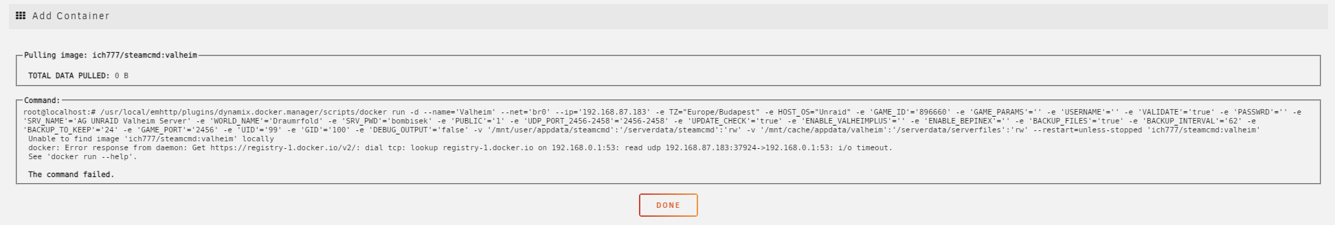

  8. That seems to be right, successfully installed container now. However, cant seem to make the Docker start. Tried rebooting server.
