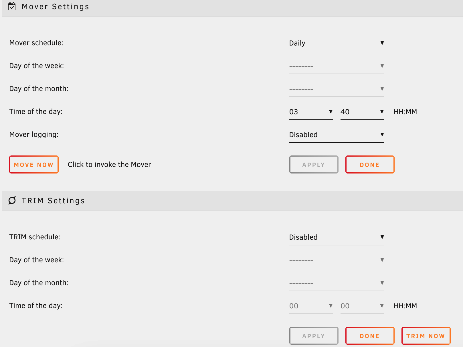

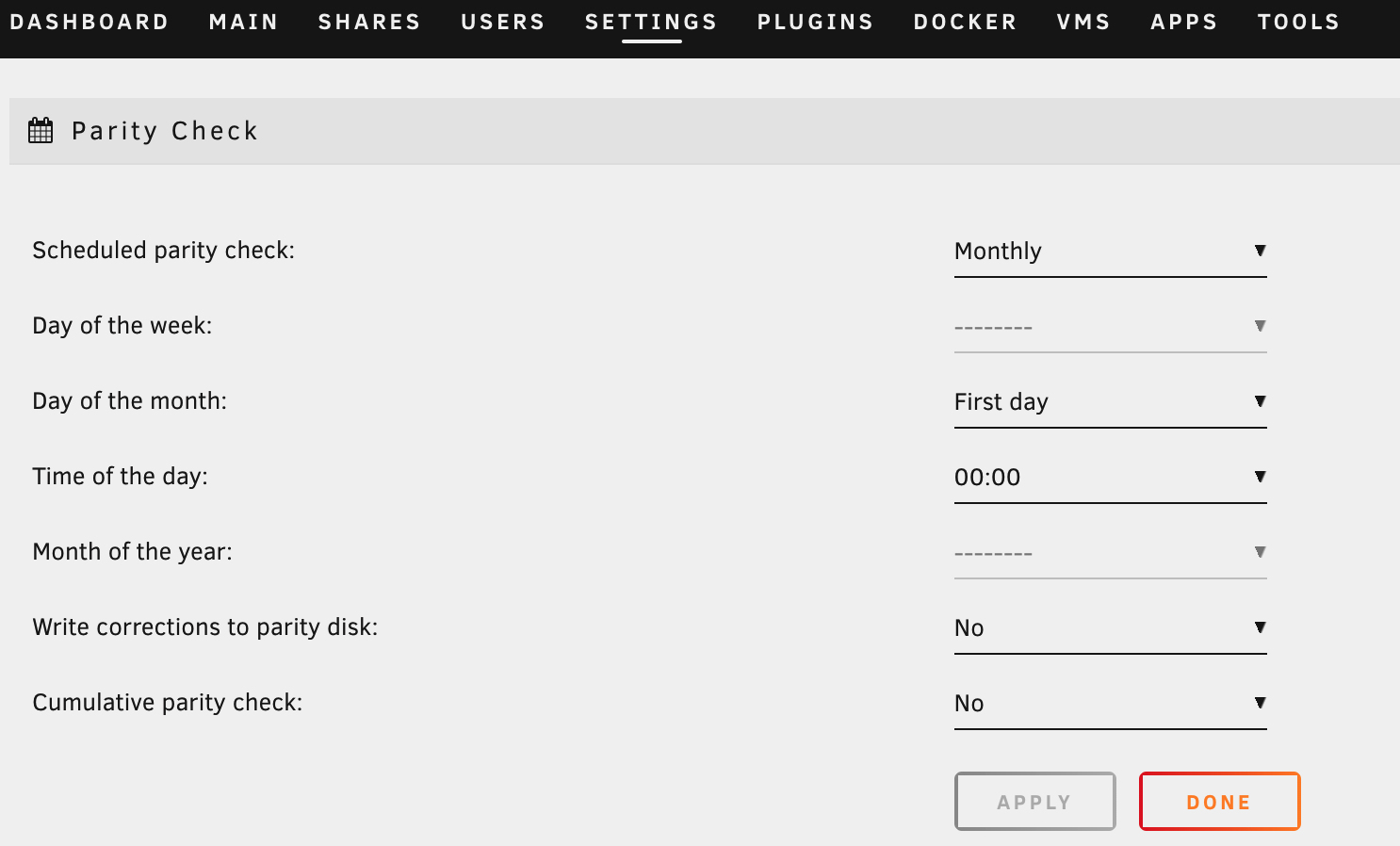

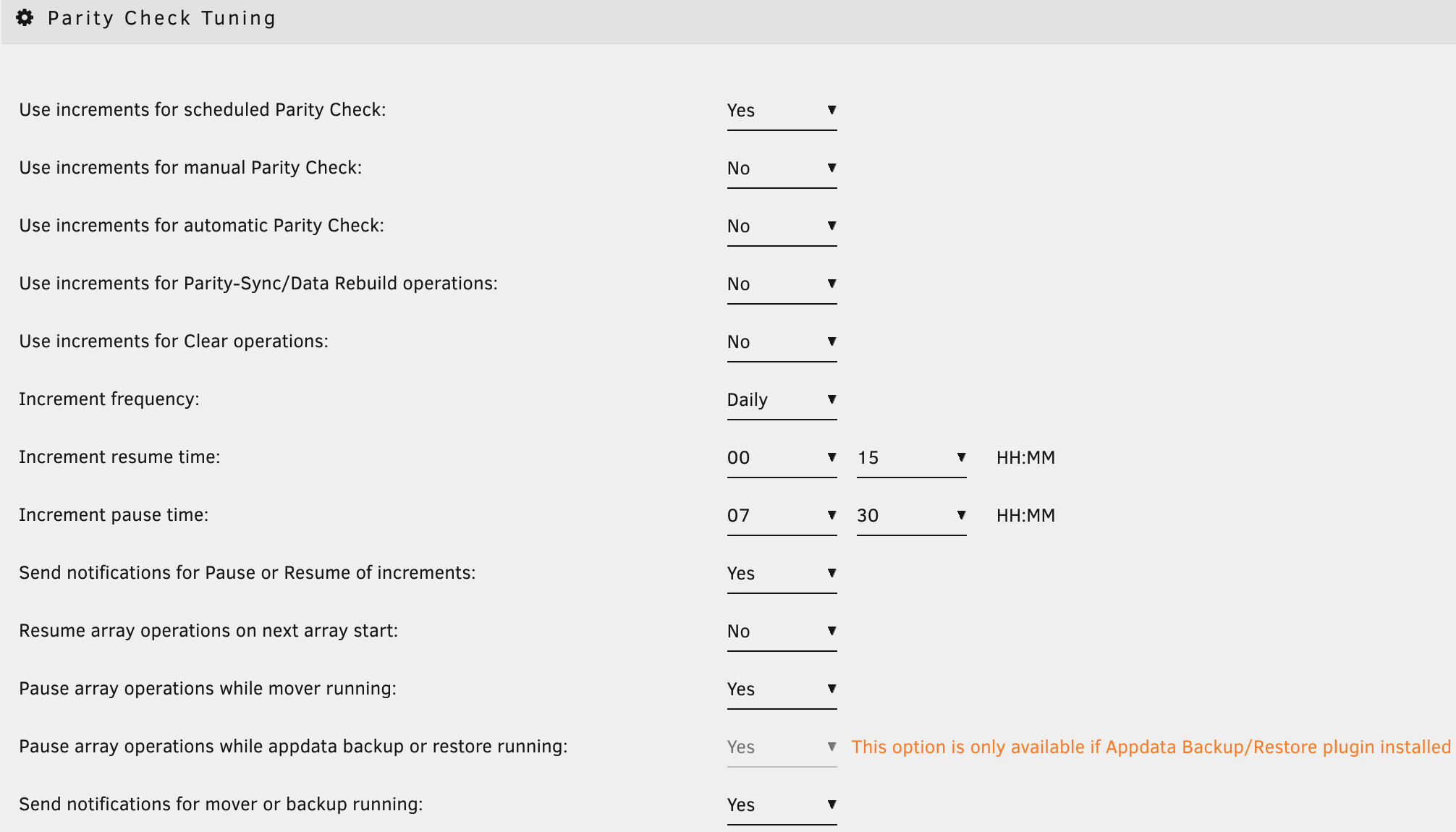

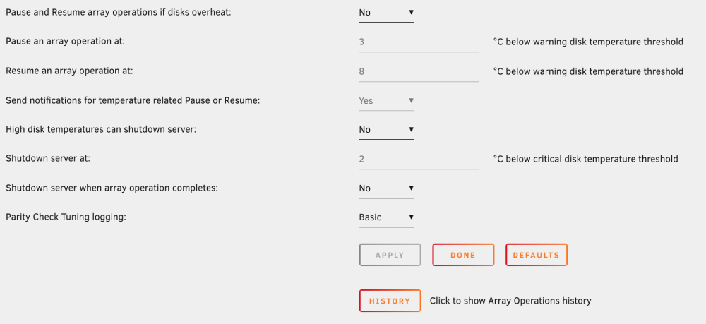

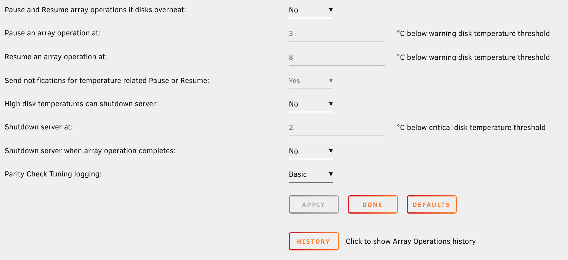

  7. Thank you for the suggestions. Please find attached the screenshots from the Scheduler. Also below is the output from cron: root@Tower:~# cat /etc/cron.d/root # Generated docker monitoring schedule: 10 0 * * 1 /usr/local/emhttp/plugins/dynamix.docker.manager/scripts/dockerupdate check &> /dev/null # Generated system monitoring schedule: */1 * * * * /usr/local/emhttp/plugins/dynamix/scripts/monitor &> /dev/null # Generated mover schedule: 40 3 * * * /usr/local/sbin/mover &> /dev/null # Generated parity check schedule: * * * * * /usr/local/sbin/mdcmd check NOCORRECT &> /dev/null # Generated plugins version check schedule: 10 0 * * 1 /usr/local/emhttp/plugins/dynamix.plugin.manager/scripts/plugincheck &> /dev/null # Generated array status check schedule: 20 0 * * 1 /usr/local/emhttp/plugins/dynamix/scripts/statuscheck &> /dev/null # Generated Unraid OS update check schedule: 11 0 1 * * /usr/local/emhttp/plugins/dynamix.plugin.manager/scripts/unraidcheck &> /dev/null # CRON for CA background scanning of applications 30 * * * * php /usr/local/emhttp/plugins/community.applications/scripts/notices.php > /dev/null 2>&1 # Generated schedules for parity.check.tuning 15 0 * * * /usr/local/emhttp/plugins/parity.check.tuning/parity.check.tuning.php "resume" &> /dev/null 30 7 * * * /usr/local/emhttp/plugins/parity.check.tuning/parity.check.tuning.php "pause" &> /dev/null */17 * * * * /usr/local/emhttp/plugins/parity.check.tuning/parity.check.tuning.php "monitor" &>/dev/null From the cron job I noticed one of the jobs show run all the time: # Generated parity check schedule: * * * * * /usr/local/sbin/mdcmd check NOCORRECT &> /dev/null Would it this be this? UPDATE: I changed the Parity Check to Disable, re-checked /etc/cron.d/root, the entry disappeared. I re-enabled Parity Check to Monthly and it looks correct now. # Generated parity check schedule: 0 0 1 * * /usr/local/sbin/mdcmd check NOCORRECT &> /dev/null I'll wait till the current Parity Check completes to confirm if this worked. Thank you for pointing me in the right direction on where to look!
  8. My understanding is that if the parity-check completes with zero errors, the system will kick off the next parity-check at the next configured Schedule in the Settings. My server has run parity-checks three times in a row (with a few seconds pause) and each parity-check resulted with zero errors. The system has not rebooted and the array has not stopped or started. All drives are green with zero errors. I cannot explain. Do I let UNRAID keep doing it's thing until this stops? UPDATE: SMART short self tests on all drives completed without errors. Attached are the diagnostics. Thanks. tower-diagnostics-20240306-1459.zip
