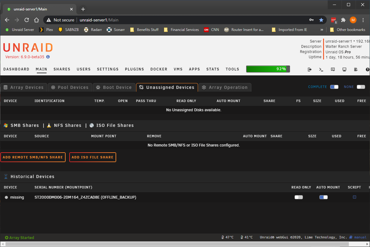

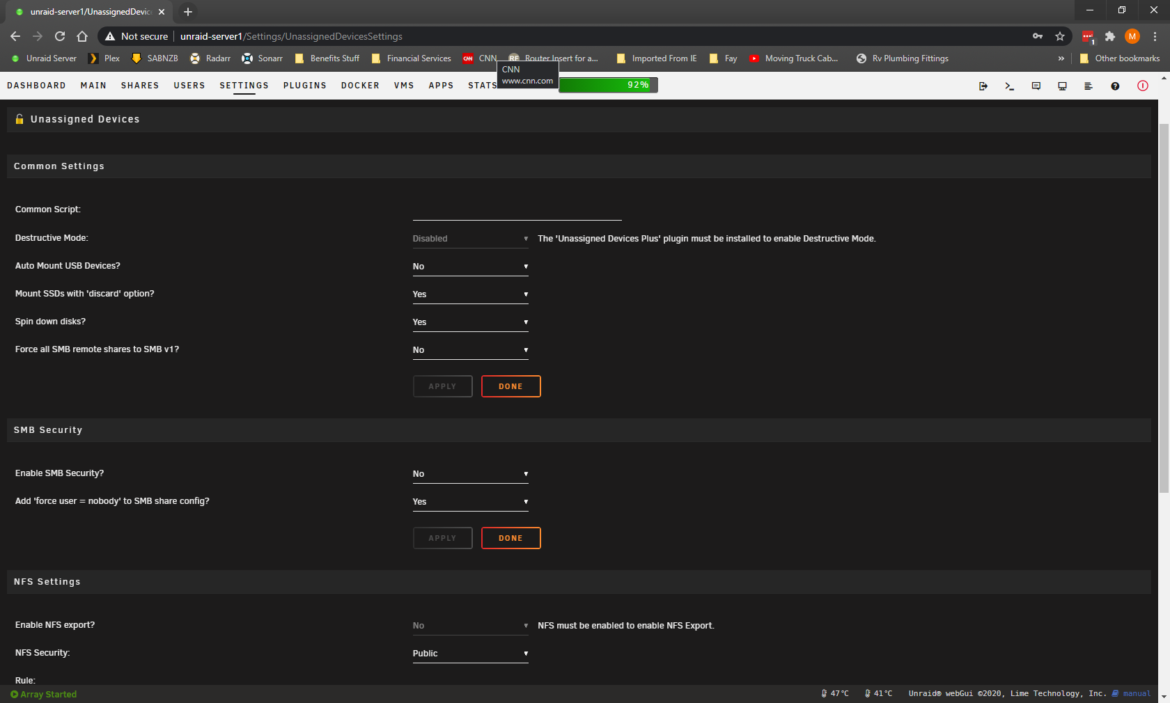

Here are my diagnostics and a screen shots. I wasn't sure if you wanted the UD config page (I believe I left everything at the default) or the page showing the UD tab from main. I have one drive that is used for offline backups, so it isn't typically connected, but is still shown/remembered. unraid-server1-diagnostics-20201116-1320.zip
