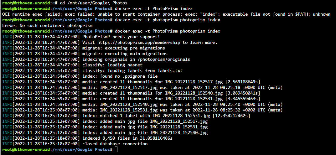

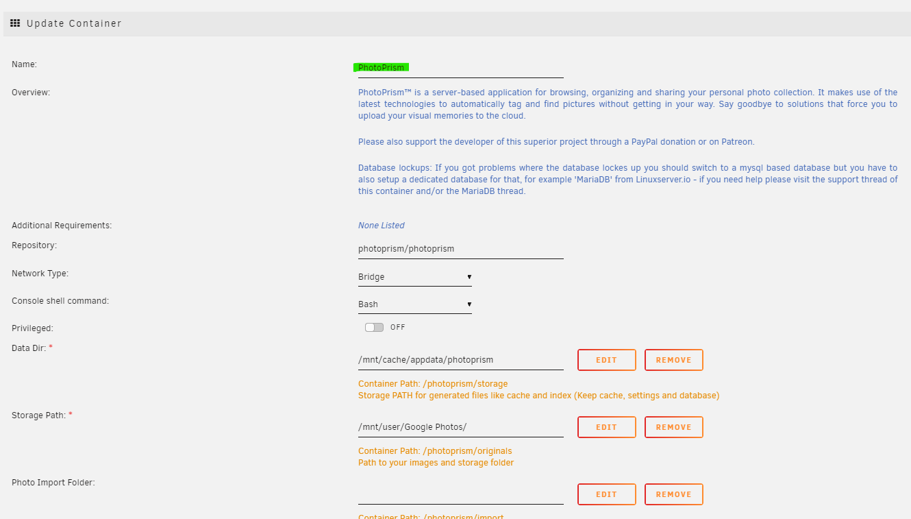

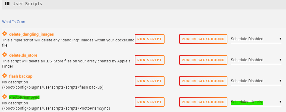

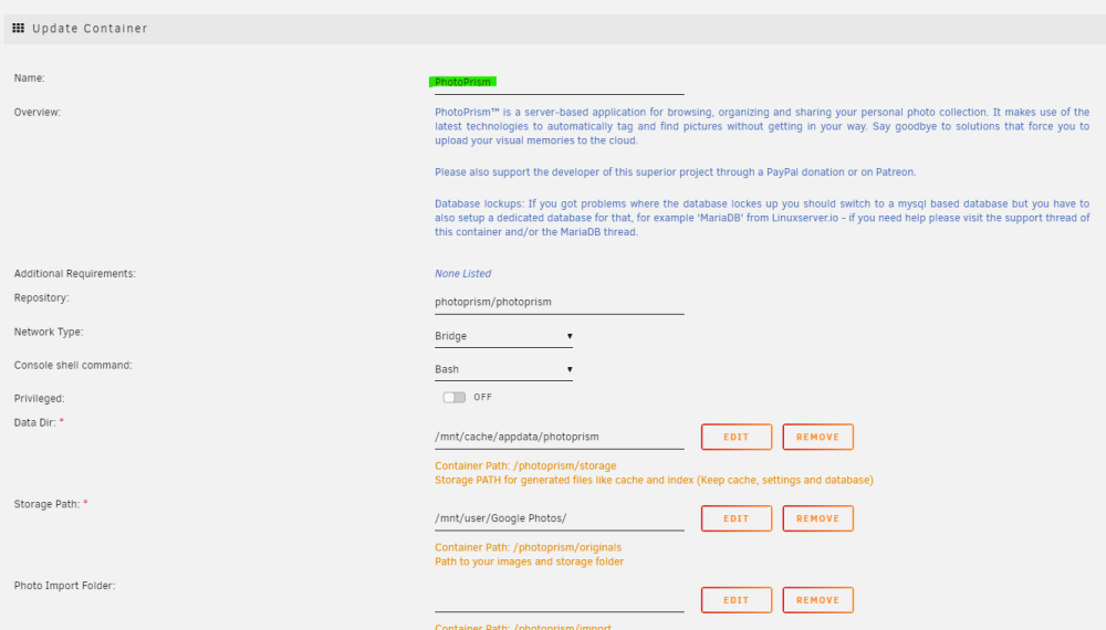

PhotoPrism - How I use a simple User Script to automate scheduled sync (without webdav)
Objective: to automatically perform indexing, every hour, for new photos in my PhotoPrism original folder, without using an import folder or WebDAV in PhotoPrism. I already have a shared folder on my Unraid, name 'Google Photos', which allows SMB share. I'm using a FolderSync app on my Android phone to sync, one way, photos on my phone every hour to 'Google Photos' folder on my Unraid. I also have another phone which also runs Foldersync app which also syncs, one way, to the same 'Google Photos' folder on my Unraid. So basically, my 'Google Photos' contains all photos originated from my mobile phones. After I started using PhotoPrism by specifying 'Google Photos' as its original folder (or 'Storage Path' on Unraid docker webui), I had a 'complete Rescan' once to index all the existing photos/videos. Since then, I've been struggling to find a way to automate a scheduled rescan for only changes in my 'Google Photos' folder. As PhotoPrism only supports such feature with WebDAV sharing folder only, and Unraid does not support WebDAV share, I can only do it manually on it webui (Libraray sidebar --> Index tab --> Start button). So I need to find another way. The solution is to run 'photoprism index' command in the PhotoStream container and scheduling its run with a cron job. The command is basically the same as when you manually rescan the folder with PhotoPrism webui (Libraray sidebar --> Index tab --> Start button) If you don't have a 'User Scripts', you have to install it first from Unraid APPs repositories, and we will have a webui to create a bash script and a new schedule. It's just a webui for easy bash script and cron job creation. Pls see the attached screenshots For my PhotoPrism container, the bash script will be: #bin/sh cd /mnt/user/Google\ Photos docker exec -t PhotoPrism photoprism index where '/mnt/user/Google\ Photos' is my 'Google Photos' shared folder containing all photos/videos (need back slash behind 'Google' because I have a space in my folder name 'Google Photos'. I should rename it to 'Google_Photos') 'PhotoPrism' is my PhotoPrism container name (what you input as 'Name:' when you define the docker via Unraid Webui, see the attached screenshot) 'photoprism index' is a PhotoPrism known command to perform the indexing again. Or what the bash script does is performing indexing of photos/videos inside /mnt/user/Google Photos/ folder, by looking for only the changes in the folder. Note: your PhotoPrism docker must be running/started for this to work. If you have only a few new photos added to 'Google Photos' folder, it took only less than a minute to sync/index. Hope this helps. Screenshot: Docker parameter User Scripts 'PhotoPrismSync' How it works behind the scene:

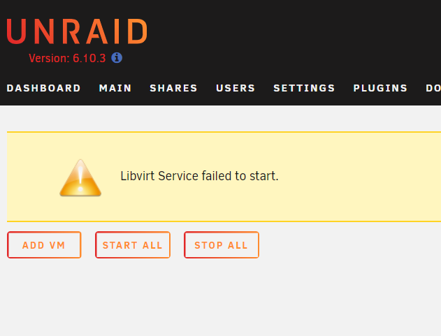

Since upgraded to 6.10.3, from time to time, all my VMs disappear from the dashboard, though all of them are still running. The VM tab shows like this. I've never shutdown my unraid. I therefore can't maintain my VM config and can't backup with my scheduled VMbackup. I have to reboot my unraid to get it back properly. Anyone has the same problem? Any permanent or workaround solution without having to reboot my unraid? Thanks. bthoven-unraid-diagnostics-20220721-1003.zip
