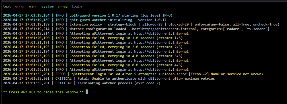

Has anyone else been having this issue? This container was working perfectly before, but then it just randomly stopped.

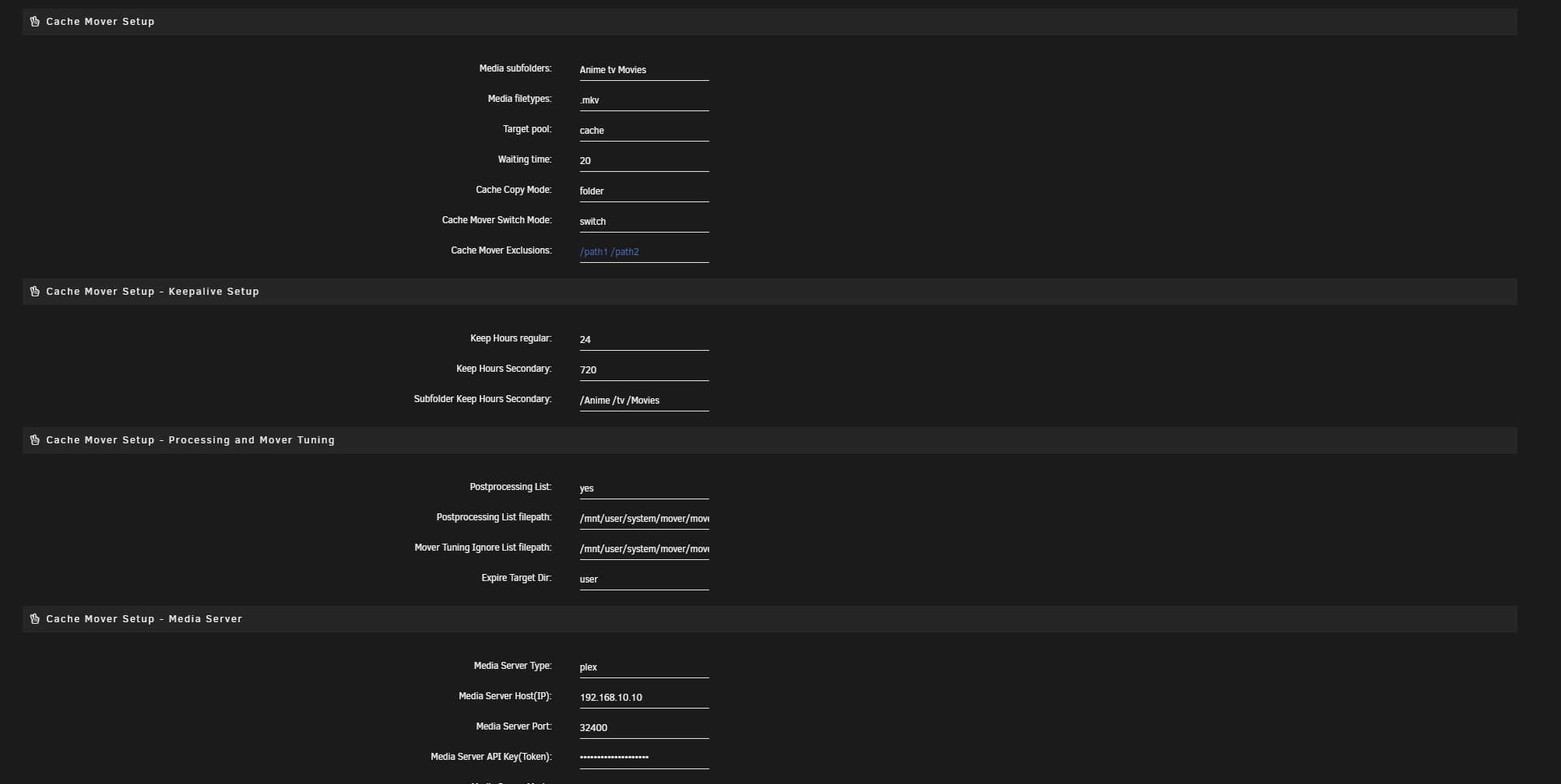

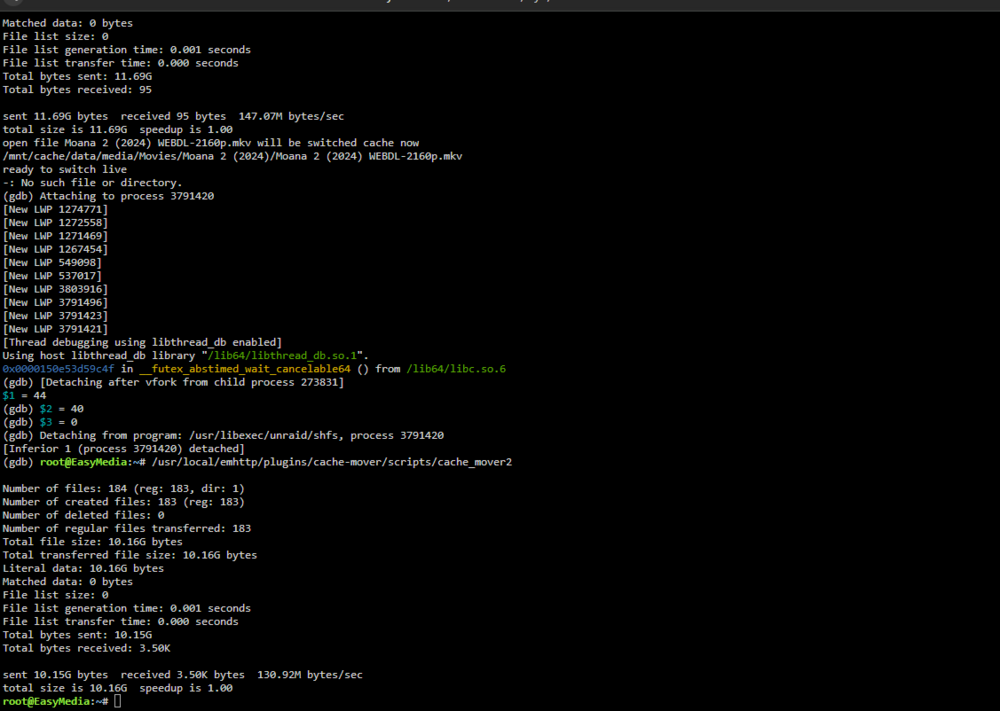

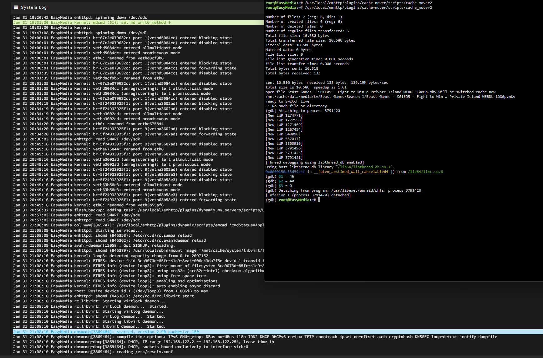

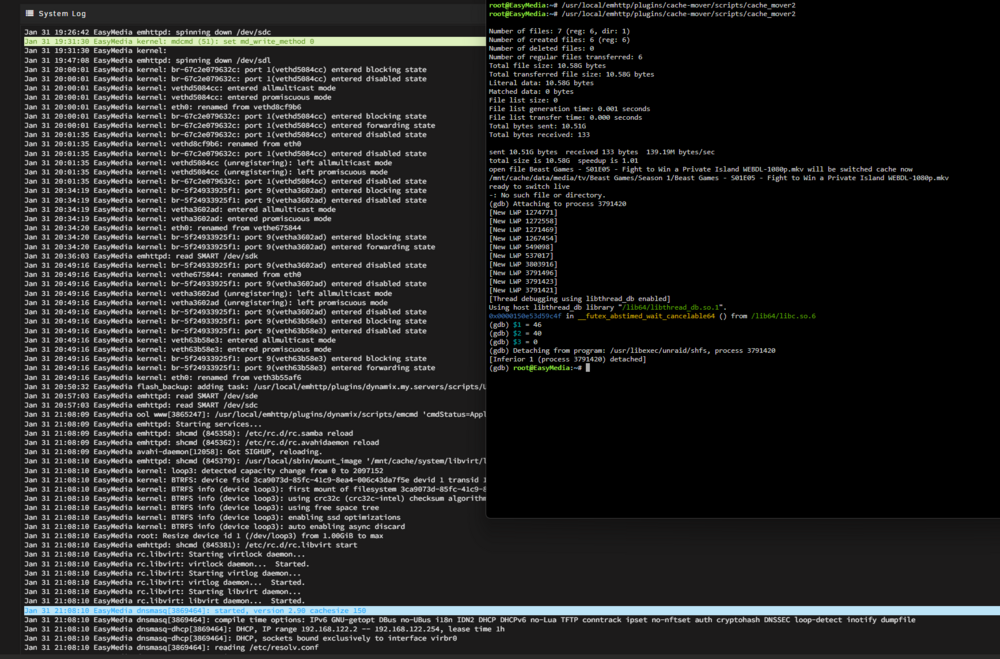

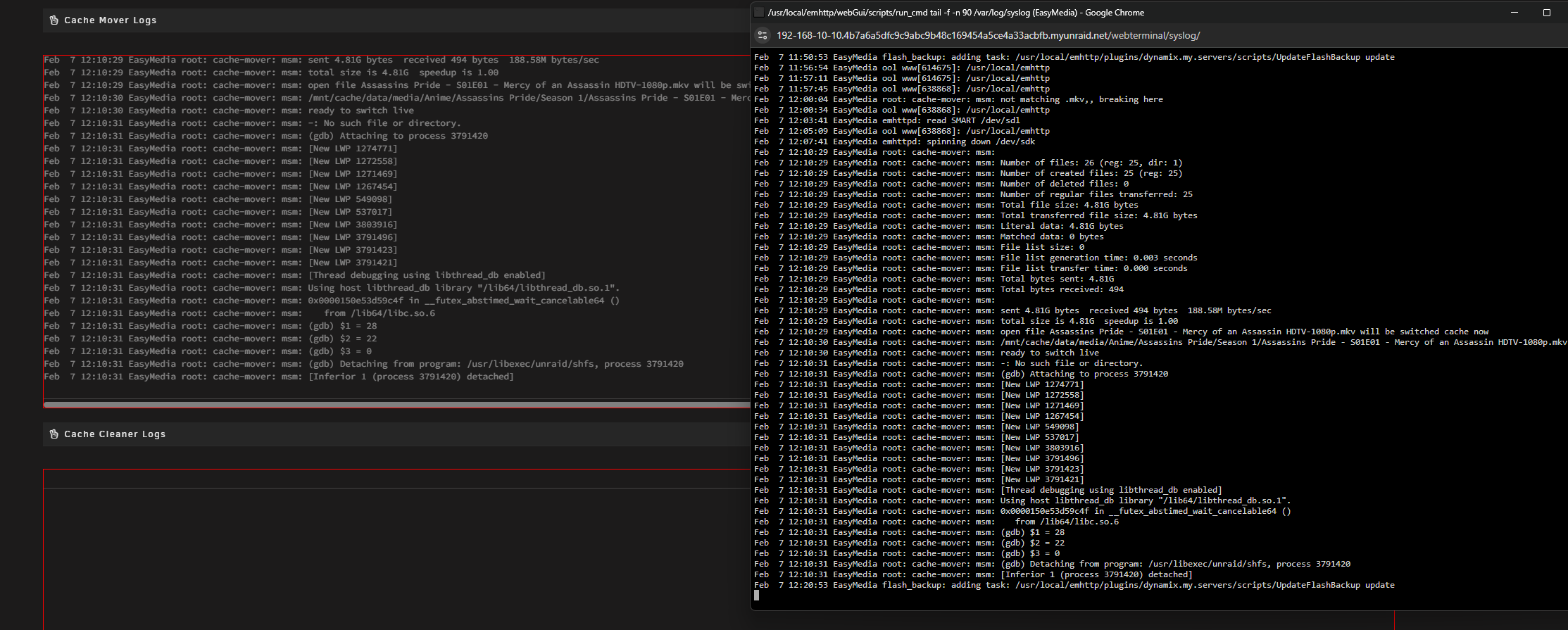

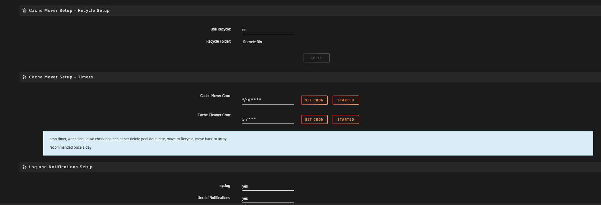

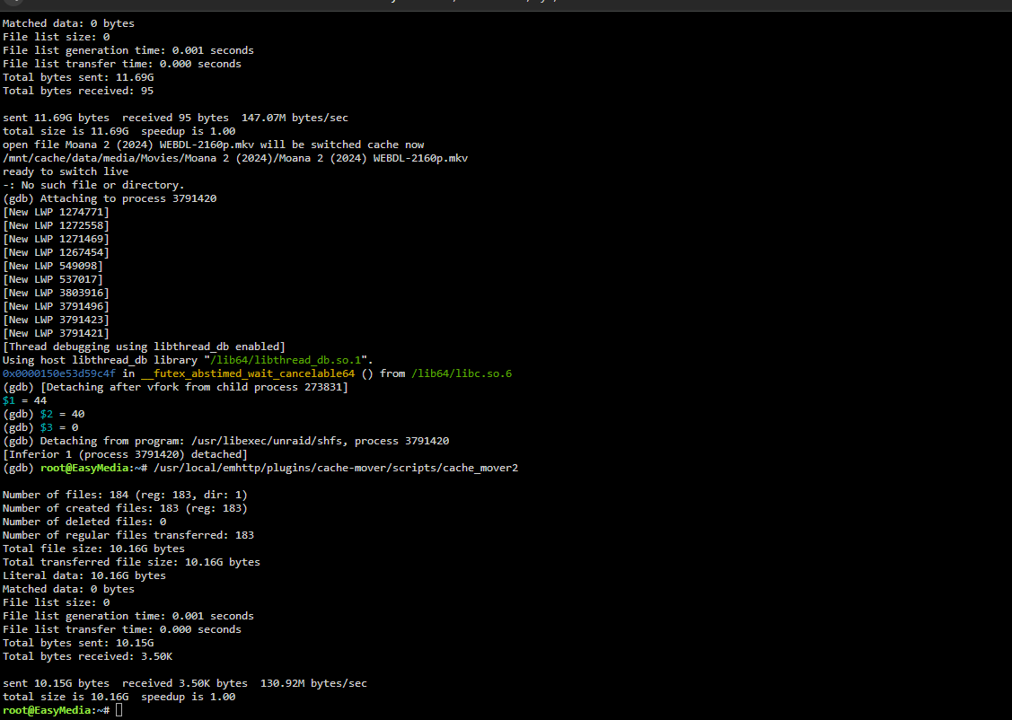

Hello, I discovered that there's a new option to use HTTPS with the Cache Mover plugin. Besides setting the Media Server URL (Type) to HTTPS, do I need to do anything else? I tested it using: curl -s "http://192.168.10.10:32400/status/sessions?X-Plex-Token=kjdscvioubcdksajcb" but nothing was returned. Then I tried: curl -k "https://192.168.10.10:32400/status/sessions?X-Plex-Token=kjdscvioubcdksajcb" and that worked. Also, /usr/local/emhttp/plugins/cache-mover/scripts/cache_mover2 doesn't display anything when using HTTPS.

Thanks a lot for your help! I found the problem, and it was not the plugin. It seems like you can only see the active streams for files that are on the array, and you’re unable to see the ones that are in the cache.

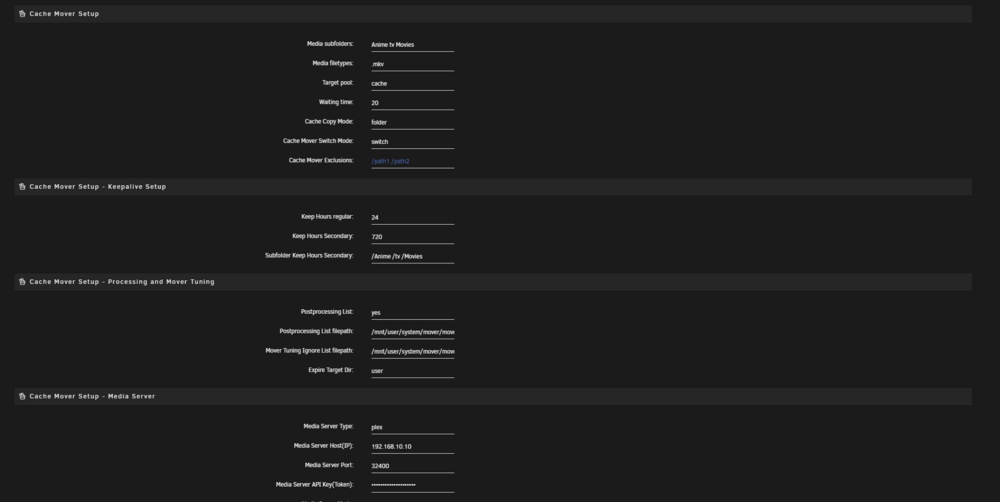

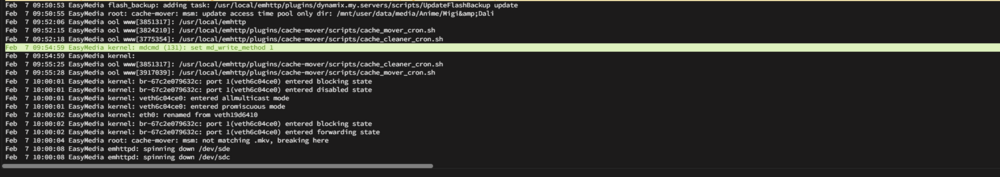

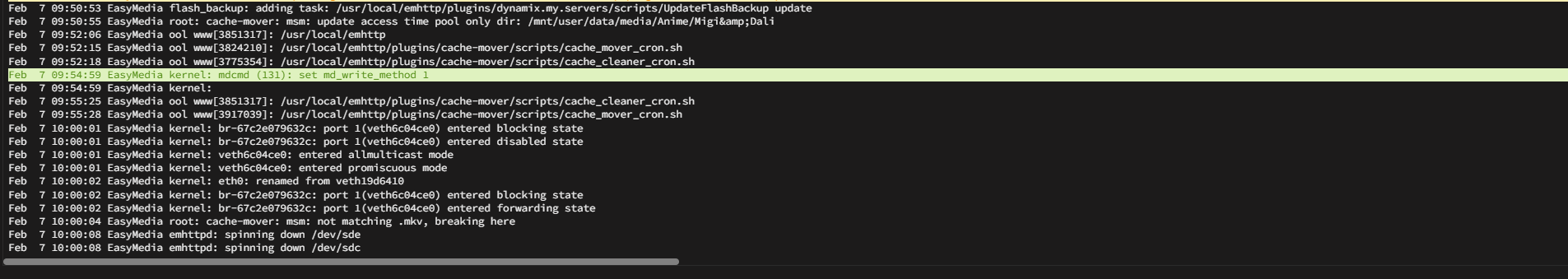

Honestly, I have no idea what I did to fix the problem. I had .mkv that was giving a breaking error, so I tried .mkv again, but that didn’t work. Then, I tried .mkv, .mp4, .ts, and for some reason, that worked. After that, I tried .mkv again, and it stopped working, giving the breaking error again. So, I typed .mkv in another window, copied it, and pasted it into the media file types. Now, I’m no longer getting the breaking error. Is there a way to save the settings or back up the config so I can restore them after uninstalling and reinstalling the plugin? I found another issue after adding this plugin, and I need to remove it temporarily to see if it's causing the problem.

root@EasyMedia:~# curl -s "http://192.168.10.10:32400/status/sessions?X-Plex-Token=xxxxxxxxxxxxx" <?xml version="1.0" encoding="UTF-8"?> <MediaContainer size="1"> <Video addedAt="1737461365" art="/library/metadata/113255/art/1738777190" audienceRating="9.5" audienceRatingImage="rottentomatoes://image.rating.upright" chapterSource="media" contentRating="PG" duration="6617361" guid="plex://movie/62112c9f3c1f196025283332" key="/library/metadata/113255" lastViewedAt="1738851985" librarySectionID="1" librarySectionKey="/library/sections/1" librarySectionTitle="Movies" originallyAvailableAt="2024-12-20" primaryExtraKey="/library/metadata/113256" rating="8.6" ratingImage="rottentomatoes://image.rating.ripe" ratingKey="113255" sessionKey="10" slug="sonic-the-hedgehog-3-2024" studio="Paramount Pictures" summary="Sonic, Knuckles, and Tails reunite against a powerful new adversary, Shadow, a mysterious villain with powers unlike anything they have faced before. With their abilities outmatched, Team Sonic must seek out an unlikely alliance." tagline="Try to keep up." thumb="/library/metadata/113255/thumb/1738777190" title="Sonic the Hedgehog 3" type="movie" updatedAt="1738777190" viewCount="8" viewOffset="1472638" year="2024"> <Media aspectRatio="2.35" audioChannels="6" audioCodec="aac" audioProfile="lc" bitrate="6388" container="mkv" duration="6617361" hasVoiceActivity="0" height="1600" id="190230" videoCodec="hevc" videoFrameRate="24p" videoProfile="main 10" videoResolution="4k" width="3840" selected="1"> <Part audioProfile="lc" container="mkv" duration="6617361" file="/data/media/Movies/Sonic the Hedgehog 3 (2024)/Sonic the Hedgehog 3 (2024) WEBDL-2160p.mkv" id="461767" key="/library/parts/461767/1737639641/file.mkv" size="5283643500" videoProfile="main 10" decision="directplay" selected="1"> <Stream bitDepth="10" bitrate="6388" chromaLocation="left" chromaSubsampling="4:2:0" codec="hevc" codedHeight="1600" codedWidth="3840" colorPrimaries="bt709" colorRange="tv" colorSpace="bt709" colorTrc="bt709" default="1" displayTitle="4K" extendedDisplayTitle="4K (HEVC Main 10)" frameRate="23.976" height="1600" id="2123261" index="0" level="150" original="1" profile="main 10" refFrames="1" scanType="progressive" streamType="1" width="3840" location="direct" /> <Stream audioChannelLayout="5.1" channels="6" codec="aac" default="1" displayTitle="Unknown (AAC 5.1)" extendedDisplayTitle="Unknown (AAC 5.1)" id="2123262" index="1" original="1" profile="lc" samplingRate="48000" selected="1" streamType="2" location="direct" /> <Stream canAutoSync="0" codec="srt" default="1" displayTitle="English Forced" extendedDisplayTitle="English Forced (SRT)" forced="1" id="2123263" index="2" language="English" languageCode="eng" languageTag="en" original="1" selected="1" streamType="3" location="direct" /> </Part> </Media> <UltraBlurColors bottomLeft="0f0e53" bottomRight="382782" topLeft="1b1f70" topRight="8d2c3a" /> <Genre count="686" filter="genre=85" id="85" tag="Action" /> <Genre count="643" filter="genre=86" id="86" tag="Adventure" /> <Genre count="535" filter="genre=90" id="90" tag="Comedy" /> <Genre count="328" filter="genre=1184" id="1184" tag="Family" /> <Genre count="455" filter="genre=89" id="89" tag="Fantasy" /> <Genre count="443" filter="genre=87" id="87" tag="Science Fiction" /> <Genre count="387" filter="genre=84" id="84" tag="Animation" /> <Country count="124" filter="country=185" id="185" tag="Japan" /> <Country count="1112" filter="country=51" id="51" tag="United States of America" /> <Rating count="1288" image="imdb://image.rating" type="audience" value="7.1" /> <Rating count="582" image="rottentomatoes://image.rating.ripe" type="critic" value="8.6" /> <Rating count="826" image="rottentomatoes://image.rating.upright" type="audience" value="9.5" /> <Rating count="1291" image="themoviedb://image.rating" type="audience" value="7.9" /> <Director count="3" filter="director=93557" id="93557" tag="Jeff Fowler" tagKey="5d77684fe6d55c0020410a13" thumb="https://metadata-static.plex.tv/iva/person/345708/e1b79e34e7df742a5f382a57c3a6435e.jpg" /> <Writer count="4" filter="writer=15840" id="15840" tag="Josh Miller" tagKey="5d7768342ec6b5001f6bbdc3" thumb="https://metadata-static.plex.tv/2/people/2742e5ee1cf021145fd69f3cb641de32.jpg" /> <Writer count="3" filter="writer=8011" id="8011" tag="John Whittington" tagKey="5dcfc4787a42e6001fd2bc0e" /> <Writer count="4" filter="writer=227280" id="227280" tag="Patrick Casey" tagKey="5d7768342ec6b5001f6bbdc2" /> <Writer count="2" filter="writer=227281" id="227281" tag="Yuji Naka" tagKey="5d776ada594b2b001e6c7d34" thumb="https://metadata-static.plex.tv/people/5d776ada594b2b001e6c7d34.jpg" /> <Writer filter="writer=238577" id="238577" tag="Naoto Ohshima" tagKey="5dd86f2b2247ae001d75d3a6" /> <Role count="10" filter="actor=6701" id="6701" role="Ivo Robotnik / Gerald Robotnik" tag="Jim Carrey" tagKey="5d776825880197001ec9030e" thumb="https://metadata-static.plex.tv/8/people/84d099dd5f4dcd85400afd13e1413c18.jpg" /> <Role count="9" filter="actor=8020" id="8020" role="Sonic (voice)" tag="Ben Schwartz" tagKey="5d776855594b2b001e688d1b" thumb="https://metadata-static.plex.tv/0/people/0850d30dbec0964b0d8f9a2880c30d6a.jpg" /> <Role count="11" filter="actor=1290" id="1290" role="Shadow (voice)" tag="Keanu Reeves" tagKey="5d77682685719b001f3a0bbf" thumb="https://metadata-static.plex.tv/6/people/6096a55d43b3460769303b51790d8ac8.jpg" /> <Role count="27" filter="actor=4356" id="4356" role="Knuckles (voice)" tag="Idris Elba" tagKey="5d77682a3c3c2a001fbcbd6d" thumb="https://metadata-static.plex.tv/d/people/d8acbdc65c2bd05f84c7324244e15f86.jpg" /> <Role count="6" filter="actor=15867" id="15867" role="Tails (voice)" tag="Colleen O'Shaughnessey" tagKey="5d77683554f42c001f8c46b2" thumb="https://metadata-static.plex.tv/7/cc68393fae/people/7d0d0776e233b90b7e591a9209175561.jpg" /> <Role count="12" filter="actor=4105" id="4105" role="Tom" tag="James Marsden" tagKey="5d77682a7e9a3c0020c6b199" thumb="https://metadata-static.plex.tv/b/people/b6d7bc293c22c4bd27886a0978317a61.jpg" /> <Role count="4" filter="actor=93561" id="93561" role="Maddie" tag="Tika Sumpter" tagKey="5d776855e870fd001f19e261" thumb="https://metadata-static.plex.tv/4/people/467b7ef8df4431face1e39e592ccaf85.jpg" /> <Role count="4" filter="actor=93562" id="93562" role="Agent Stone" tag="Lee Majdoub" tagKey="5d776892f617c900201557b3" thumb="https://metadata-static.plex.tv/7/people/7034dadc51339227f826d7452bcc036e.jpg" /> <Role filter="actor=238578" id="238578" role="Director Rockwell" tag="Krysten Ritter" tagKey="5d7768313c3c2a001fbcd246" thumb="https://metadata-static.plex.tv/a/people/ad738d2234d4e3d3cd87f4740acbb25a.jpg" /> <Role count="4" filter="actor=15846" id="15846" role="Wade" tag="Adam Pally" tagKey="5d7768422ec6b5001f6be492" thumb="https://metadata-static.plex.tv/1/cc68393fae/people/105de55ca2e6f8e9d26a0930a0c49280.jpg" /> <Role count="7" filter="actor=4555" id="4555" role="Rachel" tag="Natasha Rothwell" tagKey="5d776ba296b655001fe17909" thumb="https://metadata-static.plex.tv/3/people/3de0296f374ea01b75d9579d698c663e.jpg" /> <Role count="4" filter="actor=1104" id="1104" role="Randall" tag="Shemar Moore" tagKey="5d77683f8718ba001e316c49" thumb="https://metadata-static.plex.tv/c/people/c5d0ca10b1d1ff1ffb4a782995765f5a.jpg" /> <Role count="4" filter="actor=19945" id="19945" role="Maria" tag="Alyla Browne" tagKey="5e1659a3fef2d4003e8bc669" thumb="https://metadata-static.plex.tv/d/people/dbdfdcbe51a082fd572efbfb3c6cdca9.jpg" /> <Role count="6" filter="actor=15806" id="15806" role="Commander Walters" tag="Tom Butler" tagKey="5d77683185719b001f3a2b7b" thumb="https://metadata-static.plex.tv/people/5d77683185719b001f3a2b7b.jpg" /> <Role count="6" filter="actor=7375" id="7375" role="Kyle Lancebottom" tag="Jorma Taccone" tagKey="5d77683d61141d001fb16775" thumb="https://metadata-static.plex.tv/2/people/23b7d2721605c960c48d632be0870314.jpg" /> <Role filter="actor=144445" id="144445" role="Gabriella" tag="Sofia Pernas" tagKey="5d776868eb5d26001f1ea127" thumb="https://metadata-static.plex.tv/8/people/887e520c80811daff099d6dc6c43b8cf.jpg" /> <Role count="4" filter="actor=166925" id="166925" role="Pablo / Juan" tag="Cristo Fernández" tagKey="5eb80fc2591777004028b72b" thumb="https://metadata-static.plex.tv/0/people/008e0269a94733e9fdd35c030044b3ff.jpg" /> <Role filter="actor=55026" id="55026" role="Young Walters" tag="James Wolk" tagKey="5d77686d103a2d001f5714a7" thumb="https://metadata-static.plex.tv/4/people/4181ab0c65f364c9338a459ae49e3894.jpg" /> <Role count="2" filter="actor=94353" id="94353" role="Prison Guard" tag="Brett Tutor" tagKey="5f38efd95582d80041b47a0e" thumb="https://metadata-static.plex.tv/5/people/56aeeb790a8f2994a8867d3fb62713e2.jpg" /> <Role filter="actor=188704" id="188704" role="G.U.N. HQ Security Guard" tag="Richard Sutton" tagKey="5d776886374a5b001fec80b5" thumb="https://image.tmdb.org/t/p/original/nTzBbbqpl8DZOjtiGUKDU8LiIEf.jpg" /> <Role count="4" filter="actor=92792" id="92792" role="G.U.N. Heli Pilot" tag="Will Austin" tagKey="5d776b2b96b655001fe069cc" thumb="https://metadata-static.plex.tv/d/people/de6ee4c8cd7287f4962d9e1cb58da56b.jpg" /> <Role filter="actor=238579" id="238579" role="Military Man" tag="Bola Okun" tagKey="676566f67860acfdbba108fd" /> <Role filter="actor=238580" id="238580" role="Rockwell's Assistant" tag="Reggie Banigo" tagKey="65d5e69fb4a2a4fe97209402" /> <Role filter="actor=238581" id="238581" role="70s G.U.N. Soldier" tag="Barry Calvert" tagKey="63209249315d02c732077e6e" /> <Role count="2" filter="actor=121377" id="121377" role="Robotnik Proxy" tag="Brendan Murphy" tagKey="5d776d46ad5437001f7d1d47" thumb="https://metadata-static.plex.tv/2/people/2573ec472175685cf0d35f45f7d55d0c.jpg" /> <Role filter="actor=238582" id="238582" role="Japanese News Reporter" tag="Toru Nakahara" tagKey="5d776cc396b655001fe3a6fe" thumb="https://metadata-static.plex.tv/4/cc68393fae/people/482524e46d83d425163a841e7becbd38.jpg" /> <Producer count="24" filter="producer=454" id="454" tag="Neal H. Moritz" tagKey="5d7768275af944001f1f6abe" thumb="https://metadata-static.plex.tv/6/people/6f7d49e2b9387d57ac92617d147d8775.jpg" /> <Producer count="3" filter="producer=153184" id="153184" tag="Toby Ascher" tagKey="5dd86f2b2247ae001d75d394" thumb="https://metadata-static.plex.tv/6/people/679c84f5e67426534ddfb597aac52450.jpg" /> <Producer count="2" filter="producer=185054" id="185054" tag="Hitoshi Okuno" tagKey="5f3fea3f04a86500409a501d" /> <Producer count="3" filter="producer=153185" id="153185" tag="Toru Nakahara" tagKey="5d776cc396b655001fe3a6fe" thumb="https://metadata-static.plex.tv/4/cc68393fae/people/482524e46d83d425163a841e7becbd38.jpg" /> <User id="1136464761" thumb="https://plex.tv/users/ed6692afabd392b1/avatar?c=1738804820" title="treus" /> <Player address="192.168.10.46" device="iPad" machineIdentifier="F3sdf62E-608C-4DDD-8B4A-214B5B3D" model="11,2" platform="iOS" platformVersion="18.1.1" product="Plex for iOS" profile="iOS" remotePublicAddress=873.160.200.69" state="playing" title="iPad" vendor="Apple" version="8.43" local="1" relayed="0" secure="1" userID="1139144761" /> <Session id="F3CC162E-608dsfd4DDD-8B4A-214dfgfdAB5B3D" bandwidth="13415" location="lan" /> </Video> </MediaContainer> seems to be working - [Support] alturismo - Repos
