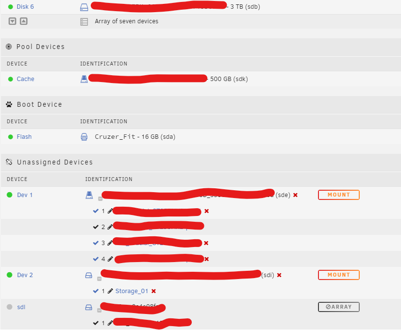

  1. Hi everyone, I recently had my one drive change from sdh to sdi without any physical changes being made to the server. The server is a separate area of the house which secured away from everyone so there was no chance of it being messed with or bumped/moved as it is in a 24U Dell Rack. My drive was originally sdh. Then I noticed a notification stating the drive has been changed to sdi. The drive in the array is now showing as disabled and emulated. I am able to access all the files from the emulated drive. The original drive which is now sdi is listed in the unassigned devices section. I am able to mount the drive and access all the files. I don't know why it changed from sdh to sdi. Even with the drive being changed from sdh to sdi in unraid, I thought the array would notice the serial number and still work. the drive label is still the same serial number it was as it's based on the actual drive serial number. I am currently rsyncing the data from the emulated drive to another drive in the array as a backup. This happened to me on Friday and did not notice the drive would not mount. I attempted to rebuild the drive and commenced to rebuild an unmountable drive and lost all the data that was on the drive. I was able to get almost 25% of the data back from other sources before it happened again. So, I am copying all the data to another drive to be safe when I attempt to rebuild the drive again. I have another drive on the way, as I am going to rebuild to a brand new drive. Then I will preclear the old drive as a way to test the drive that is suspect. If it is proven to be faulty, I will go the warranty route since the drive is only 2 months old and has a 5 year warranty since I registered it when I received it back in February. Does anyone know why the drive would have changed from sdh to sdi without actually being disconnected and then reconnected? Thanks.

  5. On the MAIN tab from the web GUI, can I click the red 'x' that is after the devices listed under the HISTORICAL DEVICES section and have them be removed from the list without losing any of the configurations? I want to remove them from the list, want to clean up the stuff that is displayed. I have all the devices being used in some way. They are unassigned to the ARRAY, but at passthrough to VMs. The red 'x' says 'Remove Device Configuration' and makes no mention if it safe to do so. So, I am trying to find out. Thanks for the help.

  9. the drives are given labels, this drive was given (sdl). there is not an updated process in the docs as of version 6.10.3. Apparently with the newer version there are differences in process and plugins then with previous versions. I just don't what this means?

  12. I am a worry wart, I am very sceptical about posting the *.zip file as it is not not completely anonymized. What exactly are you wanting to see? I can make sure its generic and provide it. thanks, for the reply
