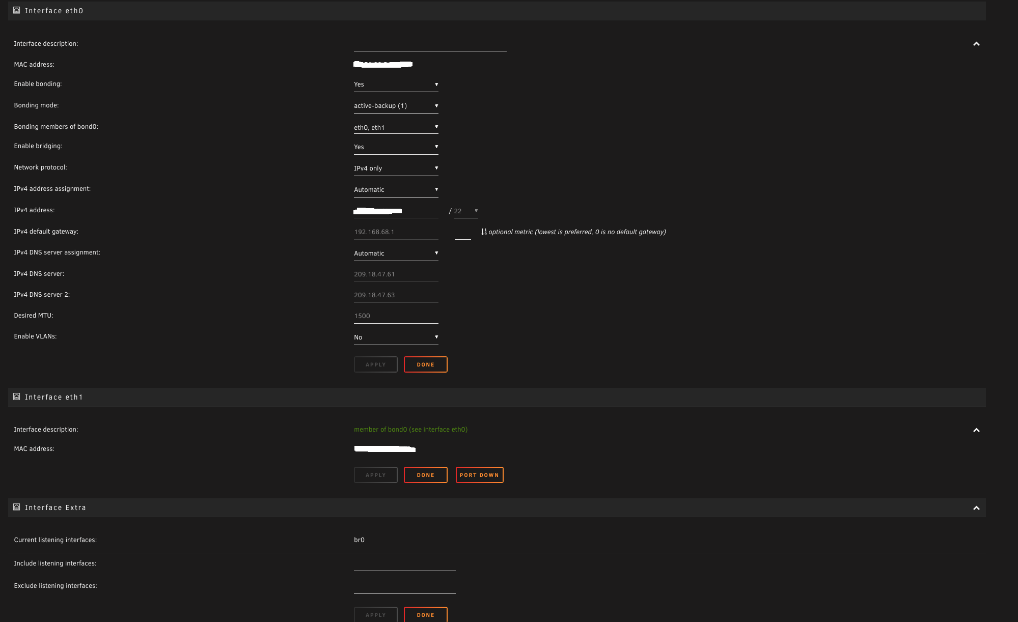

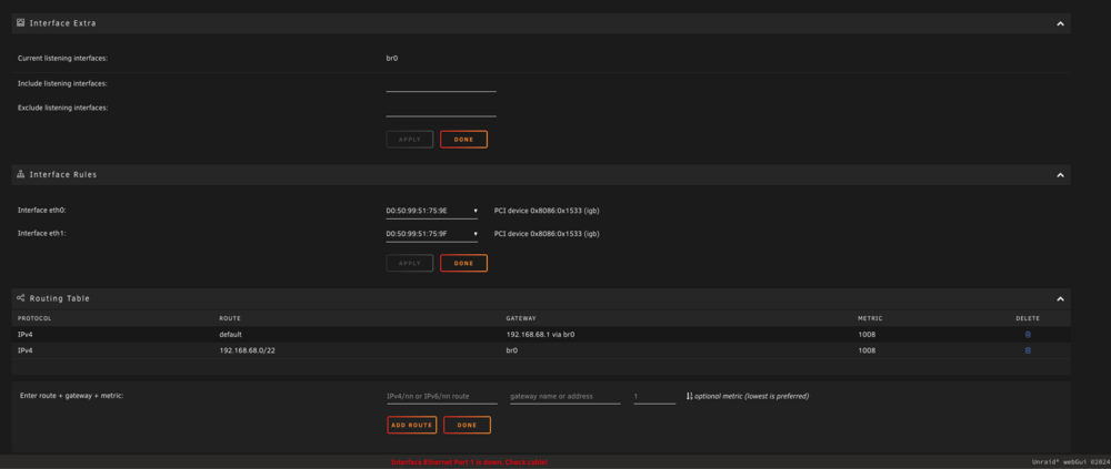

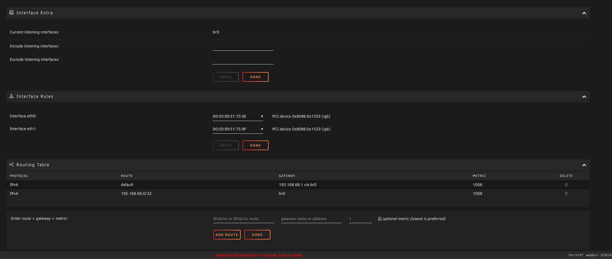

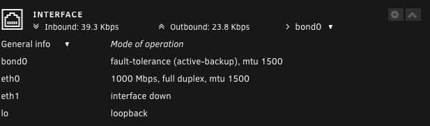

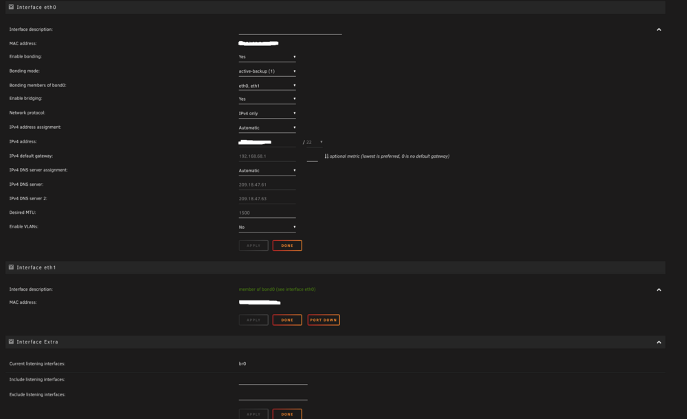

I was not able to get a signal to the monitor. My Unraid server reset and I was able to login for the time being. Attached are the diagnostics after the reset. The disk rebuild was cancelled but the drive is still in emulated mode. I don't want to re-initiate the disk rebuild until my network issue is fixed, just in case my server disappears again. Should I migrate my flash drive data onto a new one? Please advise. I have also attached images of my Unraid network settings, for reference. unraid-diagnostics-20241211-1940.zip

OK I believe I may be having 2 separate issues that popped up after installing 6.12.14. The other issue I've been having since updating: my Unraid server randomly disappears from my network. So I took your advice and re-seated everything and found that one of my drives was a little loose in the hotswap socket. Prior to re-seating, I got a "read error" on that disk, and Unraid disabled it. After re-seating it, I proceeded to rebuild the disk. 30 minutes into the disk rebuild, my Unraid server disappeared from my network and now I cannot access it at all. I have tried different ethernet cables and ethernet ports, but nothing. In my network dashboard app on my phone, all I see is my Asrock mobo. I can log into the GUI through IPMI and see that the server is powered on. I also have options to power cycle or power off my server. I already backed up my flash drive's data onto a new flash drive, but I have not installed it yet. I'm not sure what to do at this point. I assume the disk rebuild is still happening in the background? It gave me an ETA of ~10 days when I started it (14TB drive.) I'm reluctant to shut down the server, since I'm not sure if it will interrupt the rebuild and possibly harm the disk. I have created a separate thread for this issue here:

I've been having an issue with my Unraid server randomly disappearing from my network, after upgrading to 6.12.14. I've also been having read error issues with 1 of my disks. I noticed that one of my drives was a little loose in the hotswap socket. After re-seating it, I proceeded to rebuild the disk. 30 minutes into the disk rebuild, my Unraid server disappeared from my network and now I cannot access it at all. I have tried different ethernet cables and ethernet ports, but nothing. In my network dashboard app on my phone, all I see is my Asrock motherboard. I can log into the GUI through IPMI and see that the server is powered on. I also have options to power cycle or power off my server (orderly shutdown.) I already backed up my flash drive's data onto a new one. I read this may be the issue with Unraid not showing up on my network. I have not installed the new flash drive yet however. I'm not sure what to do at this point. I assume the disk rebuild is still happening in the background after losing access to my Unraid server? It gave me an ETA of ~10 days when I started it (14TB drive.) I'm reluctant to shut down the server through IPMI, since I'm not sure if it will interrupt the rebuild and possibly harm the disk. My Unraid mobo is a ASRock E3C224D4I-14S. Any help is appreciated.

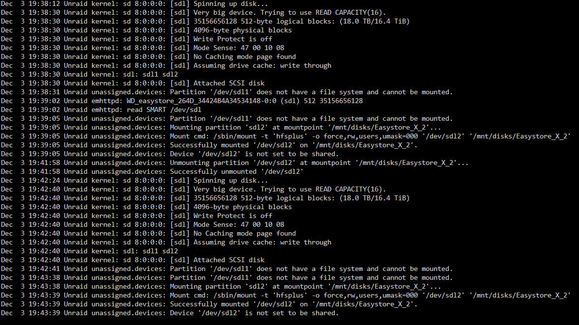

It may be that. This 18TB I'm having issues with was formatted with the latest version of macOS (Sonoma) and my other drives were formatted on earlier versions (Ventura or earlier.) I'll reformat an empty 12TB I have laying around and will see if I run into the same issue with Unraid.
Interesting. I have a few smaller external drives (all WD Easystores), ranging from 12-14TB, and I never had an issue with utilizing them while directly connected to my Unraid server. They show the correct storage space and are all formatted the same way (HFS+ done through macOS' Disk Utility). Possibly the 18TB and larger drives aren't compatible formatted in this file system.

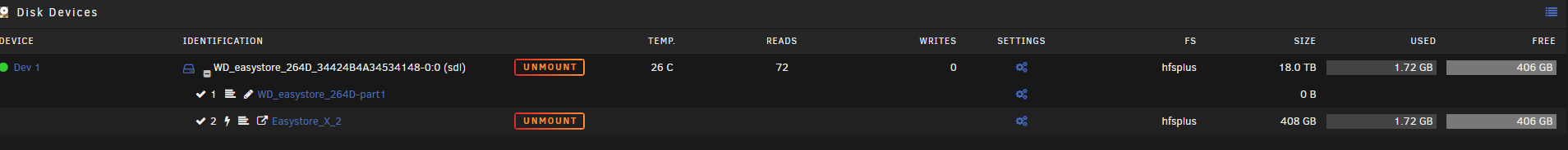

I'm having an issue with Unraid not properly recognizing the available space on an 18TB external drive, freshly formatted to Mac OS Extended (Journaled HFS Plus). It is only showing 400GB free, when the drive is actually completely empty. I have posted my issue in a separate thread here, but it might be better suited posted in this thread? Mounting the drive in either macOS Sonoma or Windows 10 shows only the main partition (18TB free space.) Only in Unraid does it show the drive partitioned out like in the above image, with only 400GB free space available. This seems to only happen when formatting to HFS+ (Mac OS Extended Journaled.) I formatted the drive to exFAT (in macOS) and Unraid now shows the correct size of 18TB free. Formatting it back to HFS+, the same issue arises. I've had major issues in the past with very large drives formatted to exFAT, so I prefer to keep the drive formatted to HFS+. Any clue why this is happening?
Mounting a freshly formatted 18tb external HDD shows the wrong capacity in Unraid (400GB)
I'm not sure how to check that in Unraid, but I made sure not to create any additional partitions when formatting the drive under macOS. When I click on the WD_easystore_264D-part1 link in Unraid under Disk Devices, it just asks me if I want to change the mount point. Mounting the drive in either macOS Sonoma or Windows 10 shows only the main partition (18TB free space.) Only in Unraid does it show the drive partitioned out like in the images I posted, with only 400GB free space available. This seems to only happen when formatting to HFS+ (Mac OS Extended Journaled.) I formatted the drive to exFAT (in macOS) and Unraid now shows the correct size of 18TB free. Formatting it back to HFS+, the same issue arises. I've had issues in the past with very large drives formatted to exFAT so I prefer to keep the drive formatted to HFS+. Maybe this question is better suited for the Unassigned Devices thread? I have a feeling this might be an issue with the plugin not properly recognizing very large external drives formatted to HFS+? I will post my issue in that thread as well.

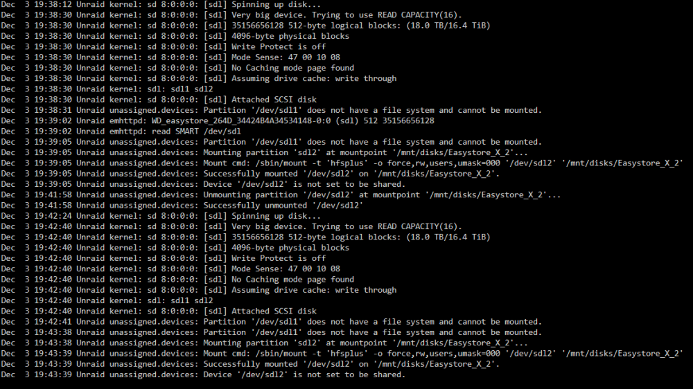

I have an 18TB external drive connected to the USB 3.0 port on my Unraid server, and I am trying to transfer files from my server to the HDD using Krusader. It's a 18TB WD Easystore external, newly formatted to Mac OS Extended (Journaled HFS Plus). When mounting the drive through Unraid, it only shows 400GB available, even though it is empty. Accessing the drive through Krusader also only shows 400GB available. When I try to transfer more than 400GB to the drive, it tells me insufficient space is available. Here's an image of the log when I mount the drive: I have several other external HDD's I've mounted and transferred to successfully in the past, all formatted the same way, but this 18TB drive is the first time I've encountered this issue. Any clue what's happening?
