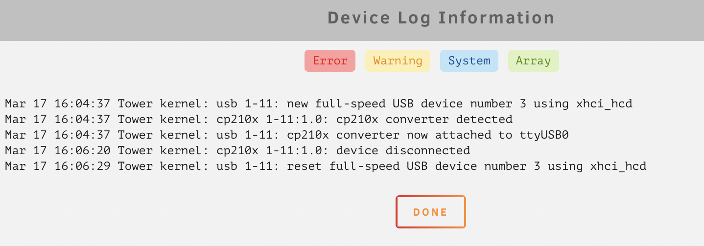

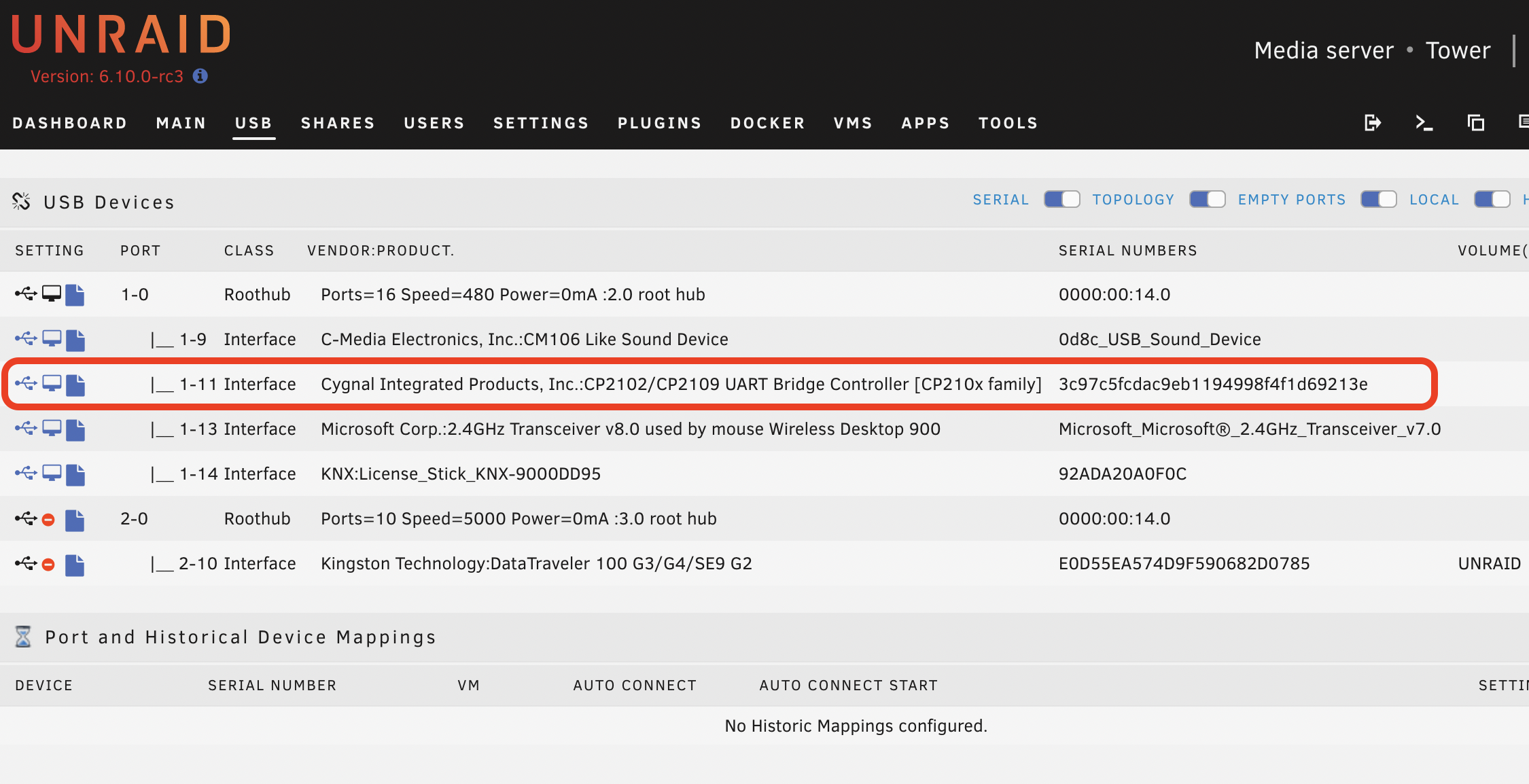

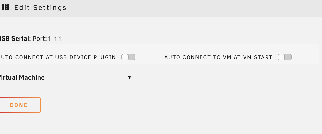

  14. Hi @SimonF thanks for your support. I now updated to Unraid 6.10.0-rc3. I try to explain the issue in english. In the past the marked device was attached to a VM. Now I attached the device to a Docker. But everytime when I restart the VM (for making backups) the VM "grabs" the device and the docker will stop. Here are some screenshots. It would be great when you can have a look on it. Perhaps you have an hint or idea what I can try. Thanks in advance. Thomas

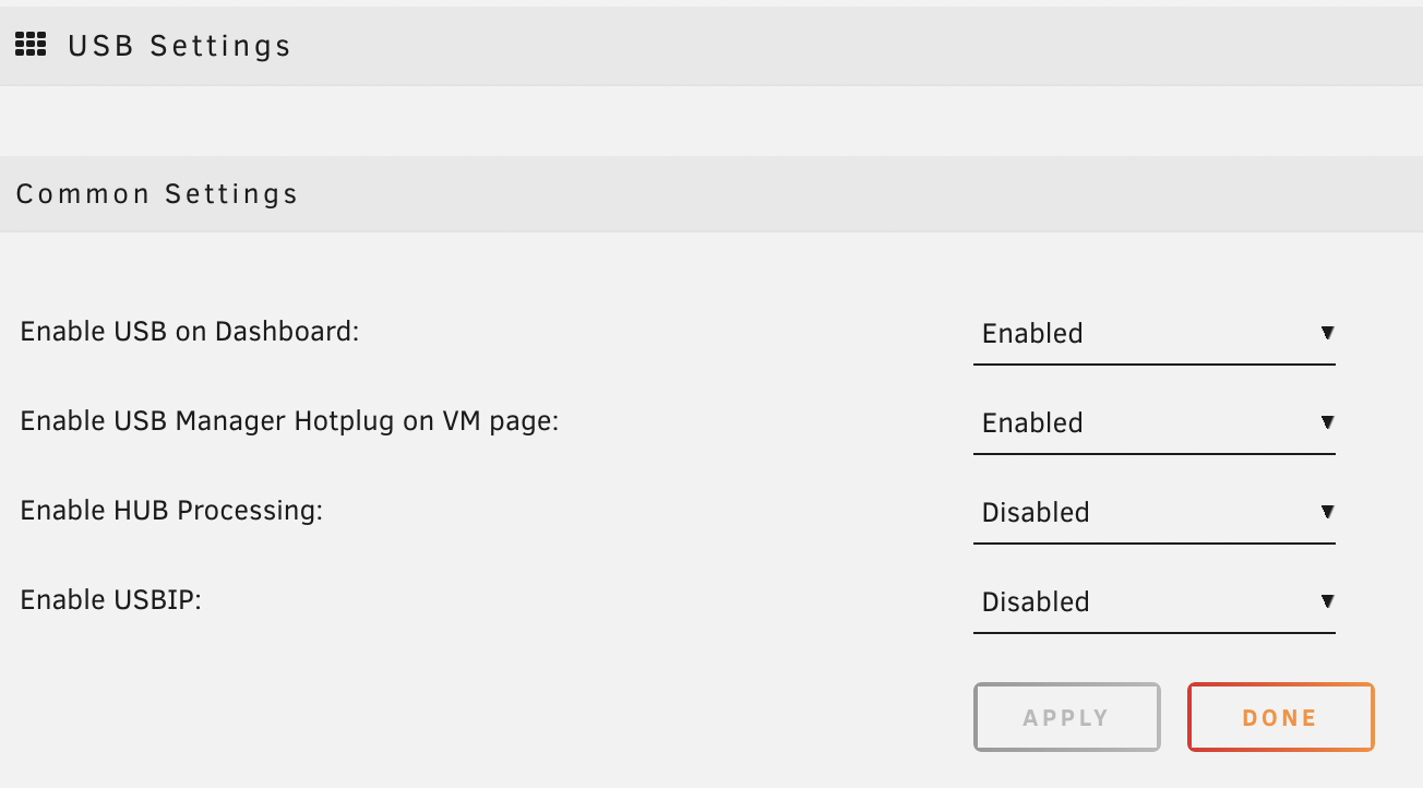

  15. Hallo, sorry, wußte nicht das das relevant sein könnte, sonst hätte ich das natürlich direkt geschrieben, mea culpa. 🙂 Anbei auch noch ein Screenshot von den Einstellungen des Plugins Als Unraid 6.9.2 und das Plugin heißt "USB Manager" aktuelle Version 2022.3.13 Danke!!
