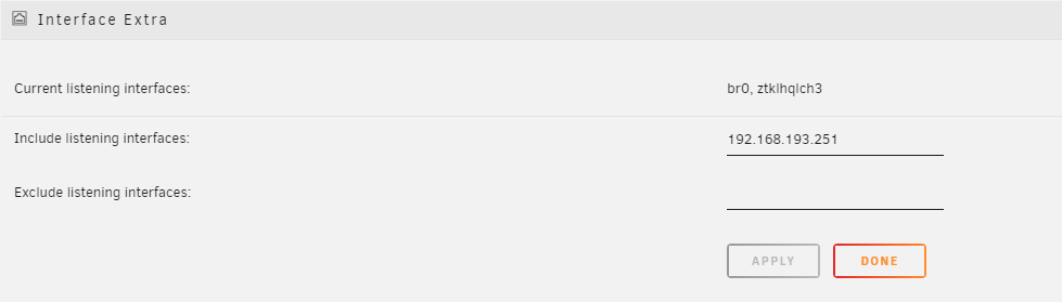

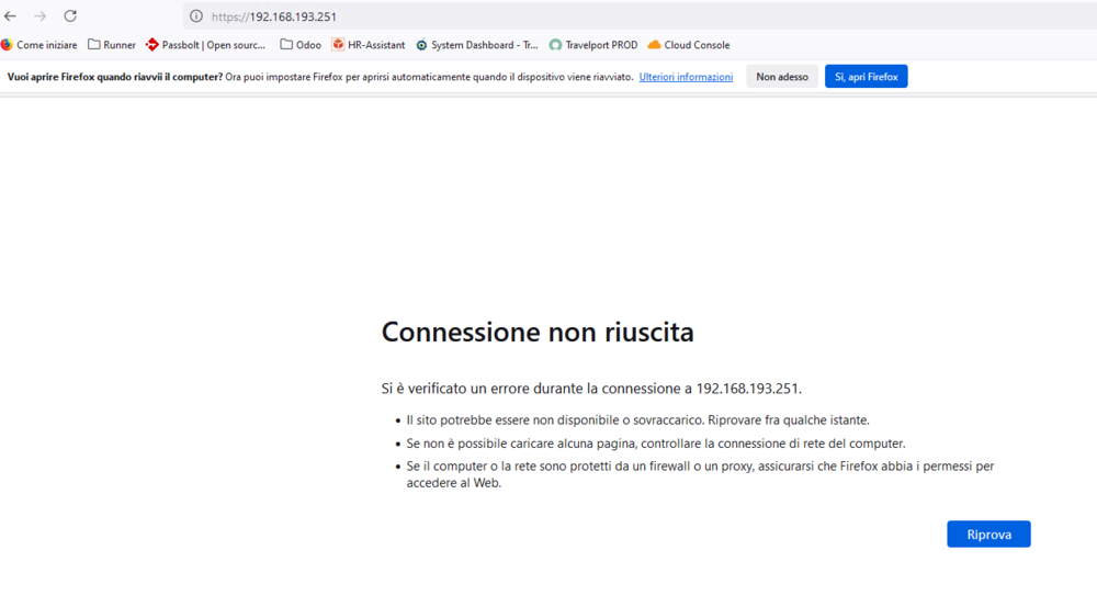

  10. Hi at all. I'm sorry to recup this topic but after some months it doesn's work. I had added this and it worked: but now I don't know why, it doesn't work. I don't know if it's normal that it redirect on https the version is still the same. Thanks!
  11. right response!! it's works!! thank you so much!!
  12. good morning, after upgrading, I can't access to my unraid server using zerotier ip. But I can ping it. What do you think? do you have suggestions? thanks!
  13. It worked! You are Awesome!! Thank you so much!!
