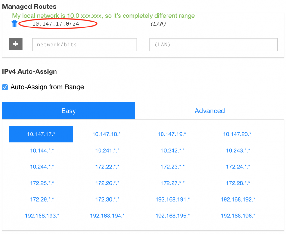

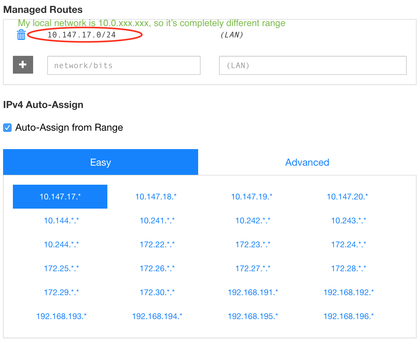

  2. Ensure that "Managed Routes" section of your network settings DOESN'T include the subnet of IPs that is used in your local networks. You can check FAQ at the end of the post for more information.

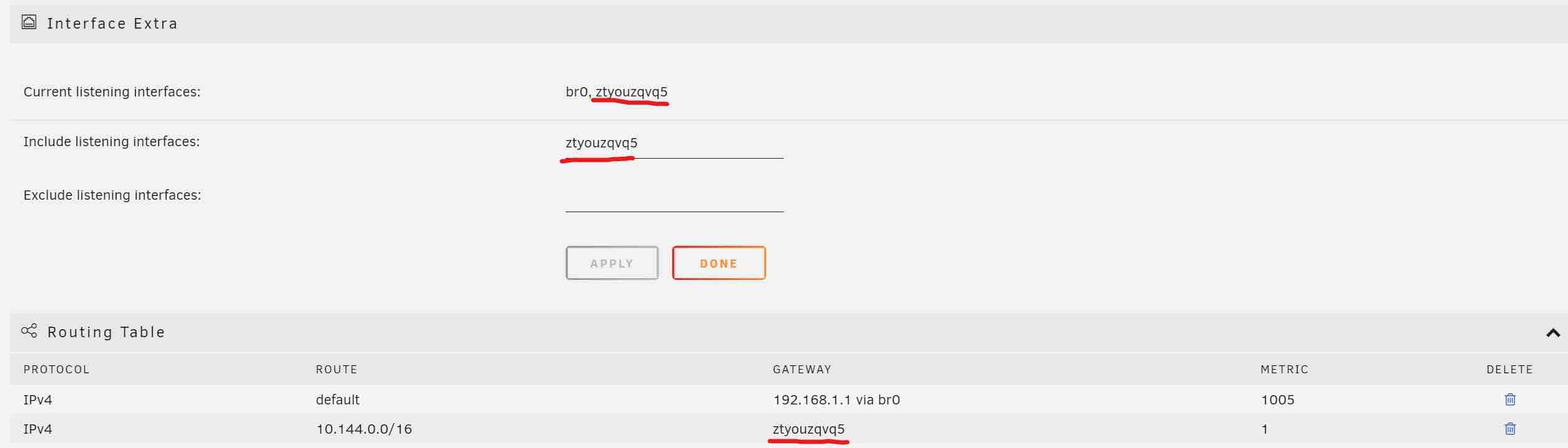

  5. Go to "Settings -> Network Settings -> Routing Table" and find the name of your zerotier gateway. It will have "zt*[0-9]" format, like "ztyouzqvq5".
  6. Go to "Settings -> Network Settings -> Interface Extra" and add zerotier gateway name to "Include listening interfaces".interfaces.thumb.jpg.6bf71d1c2096c521d09490bede78521e.jpg

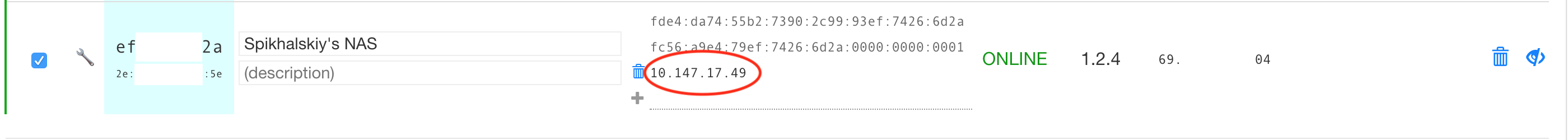

  7. Go to https://my.zerotier.com/network/<NETWORK_ID> to “Members section” area. Check “Auth” checkbox for the new device. Assign a meaningful name to it, copy an IP from "Managed IPs" column - it will be a static IP of your NAS in your virtual network.

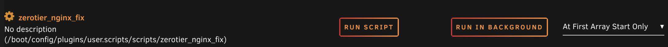

  10. A bug or a change in recent versions of Unraid leads to Unraid UI not being available on zerotier IP after a server reboot. A temporary workaround is to add the following userscript with "At First Array Start Only" scheduling. Video instruction.Screenshotfrom2024-09-2322-09-02.thumb.png.048fc20adf736e8bd1e12d575781a909.png

Q: Should I change "Managed routes" on https://my.zerotier.com/network/<NETWORK_ID> to reflect my unRaid internal IP and subnet in a real physical network?
A: No, ZeroTier creates a virtual network adapter to use in ZeroTier network. If your home IP range is 192.168.1.0/24 and ZeroTier by default selected "10.147.17.*" for example for you managed IPs - it's totally fine. Even opposite, if ZeroTier "Managed routes" intersect with your physical local IPs - change the Zerotier Managed routes range to be different - there was a reported problem with accessing the server remotely if this rule is violated.

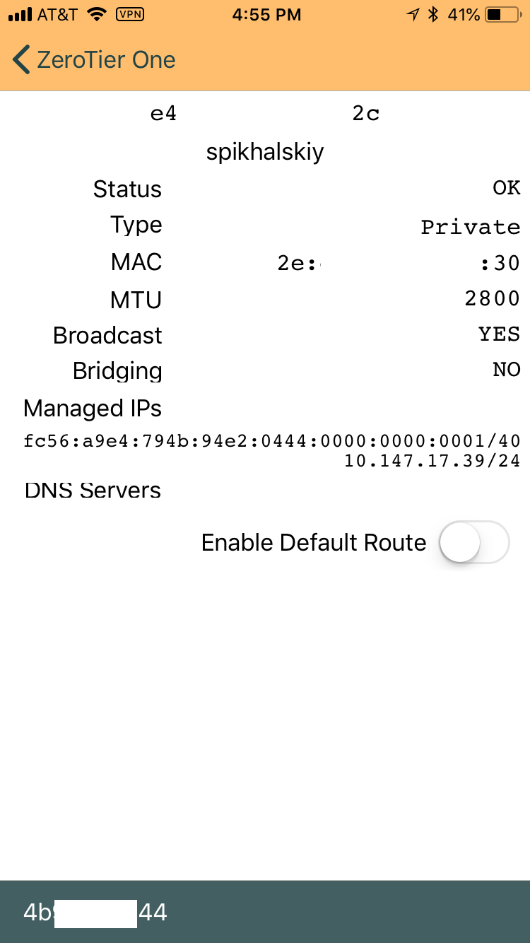

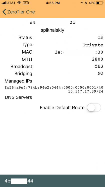

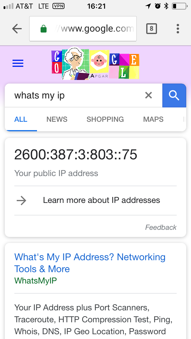

So I have done all the steps above and have gotten the server assigned but when i try to connect my phone i get what you see in the picture.
@RSQtech yeah, but how it's related and what you are going to find there? There is no need to enable "Enable default route" on Zerotier on your phone. If you don't do this - Zerotier doesn't affect anything you see in online "whats my ip" services. It's not a regular VPN that tunnels whole phone traffic thru some server and changes your public IP for google. Zerotier by default does it only with "managed IPs".
If you want to check if everything works - better just open https://my.zerotier.com/network/<NETWORK_ID>, find NAS in your device list, take an IP of your NAS and open a web browser on your phone with that IP and your regular webGui port - 80 by default. If you got webGui authentication window - you good. Also, you may try to skip IP lookup and just use the .local hostname of your unRaid - it usually works too.zerotier_panel.thumb.png.c54ba38ceb4a95f5459e41188272bf1b.png
Edited by Dmitry Spikhalskiy

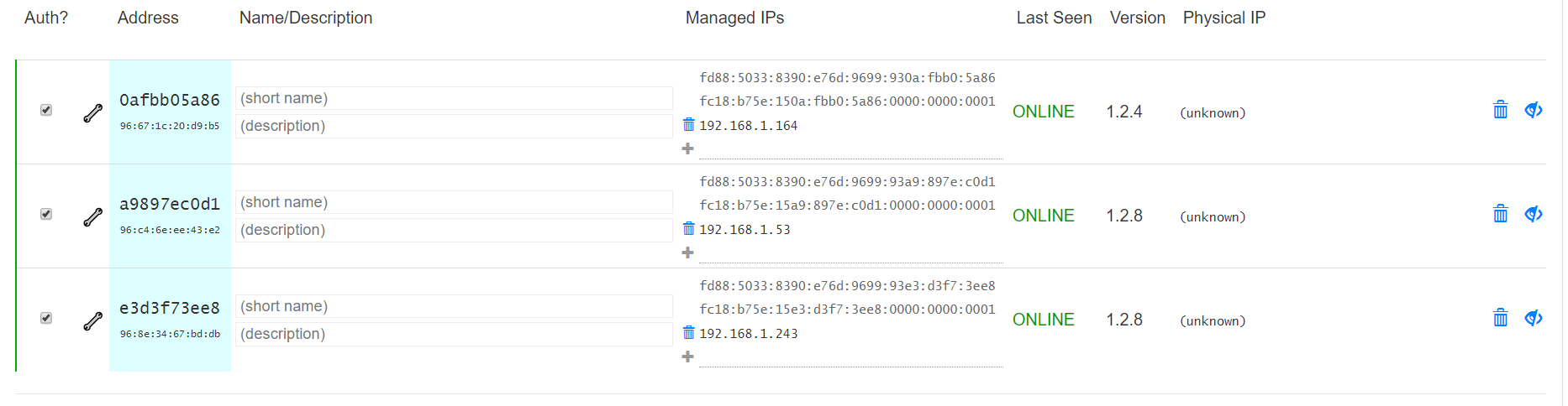

I have looked over my network details and found the network range was wrong ( 192.168.192.0/24 was what was showing... I changed it to 192.168.1.0/24) but when i connect my phone  to the zerotier app it still will not see local ip's on the netwrok.
@RSQtech This is interesting! Looks like you were able to connect all devices to Zerotier network.
I didn't get where did you make this change "192.168.192.0/24 was what was showing... I changed it to 192.168.1.0/24". It doesn't sound right and as something that you should do.
Did you try to make Zerotier Managed addresses exactly same as your physical local network addresses? If you did - I think it's not a good idea. If your local network addresses (where unRaid are) in 192.168.1.x - select something else! Address that your device will have in Zerotier network should be different from its address in a physical local network and it should be on another subnet.

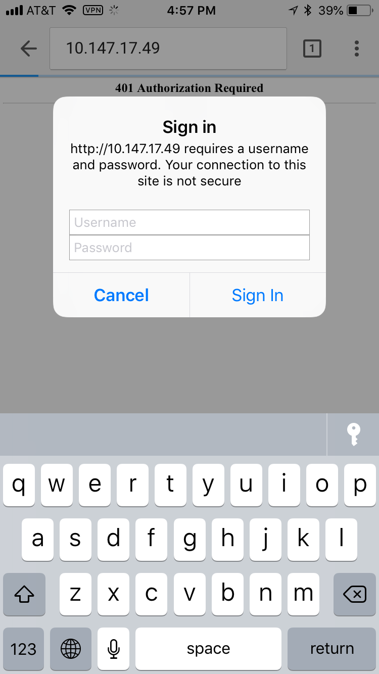

1218049657_Screenshot2018-06-0717_34_36.thumb.png.4374ec00e3d34aff145b237b500c4236.png
The address of my unRaid in a physical local network is 10.0.0.43, in a Zerotier one - 10.147.17.49
