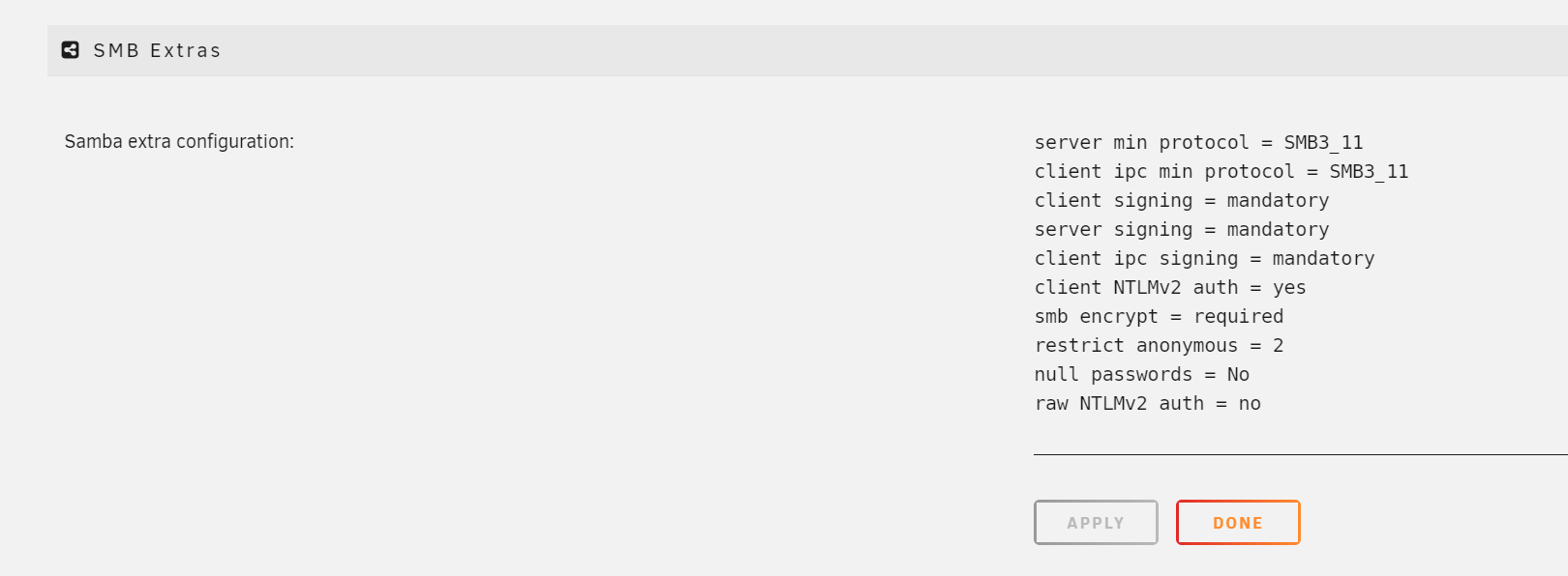

The following config is confirmed working with the test devices I have: server min protocol = SMB3_11 client ipc min protocol = SMB3_11 server signing = mandatory client NTLMv2 auth = yes restrict anonymous = 2 null passwords = no raw NTLMv2 auth = no smb encrypt = required client signing = required client ipc signing = required client smb encrypt = required server smb encrypt = required Note that the line in my previous config: client protection = encrypt Breaks auth attempts. So it shouldn't be used. @dopeytree It Sounds like your issue might be a bug in MacOS Ventura. I don't have a MacOS device running Ventura to test with unfortunately. I can confirm I can access file shares with the following devices and the below config: - MacOS Monterey - Windows 11 - Windows 10 - iOS VLC (using a beta release) - Android VLC Also note that the syntax between releases of Samba has changed and 'mandatory' has become ''required" for some settings.

As expected, some of the syntax changed between versions of Samba (why would they do this for minor versions I have no idea...) This is the current config I believe works. I'll do more testing at a later time to confirm it's all applied correctly. server min protocol = SMB3_11 client ipc min protocol = SMB3_11 client signing = required server signing = mandatory client ipc signing = required client NTLMv2 auth = yes client protection = encrypt client smb encrypt = required server smb encrypt = required smb encrypt = required restrict anonymous = 2 null passwords = No raw NTLMv2 auth = no

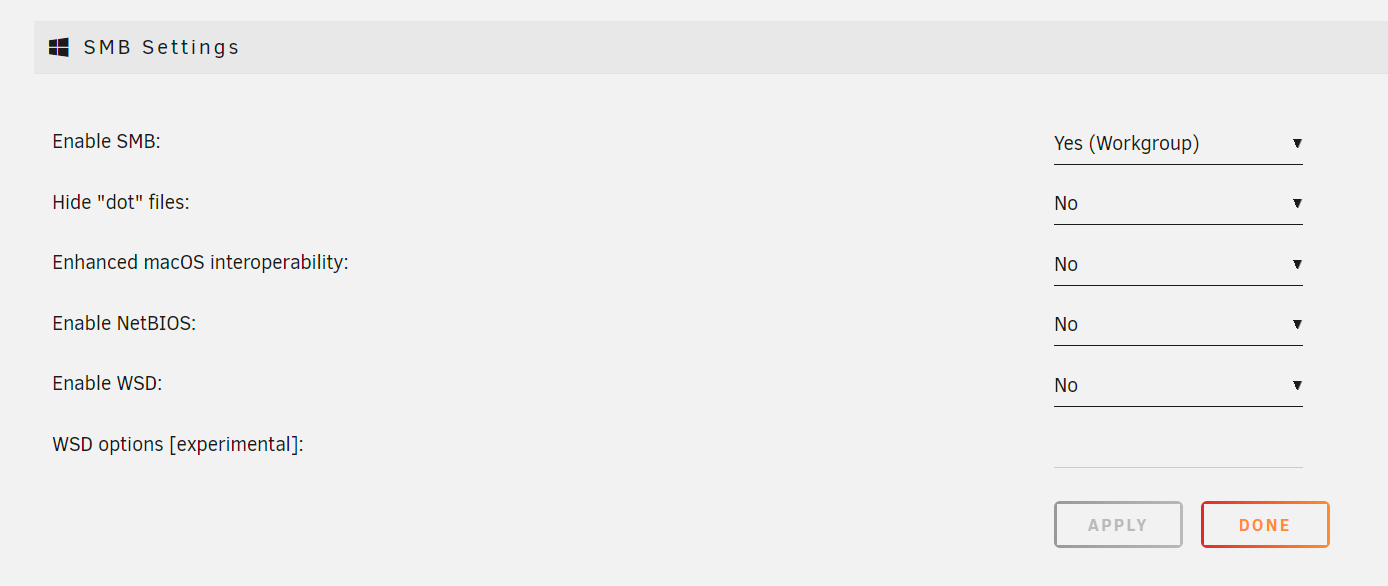

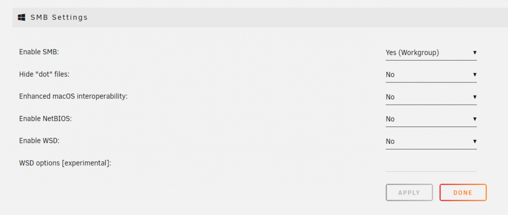

Just a note: In light of the current issues regarding CVE-2021-44142 I would strongly encourage SMB users to disable the 'Enhanced macOS interoperability' setting in the SMB settings page to mitigate the issues until a patch is released: As always seems to be the case in security, if you don't need a feature, disable it and reduce your attack surface.

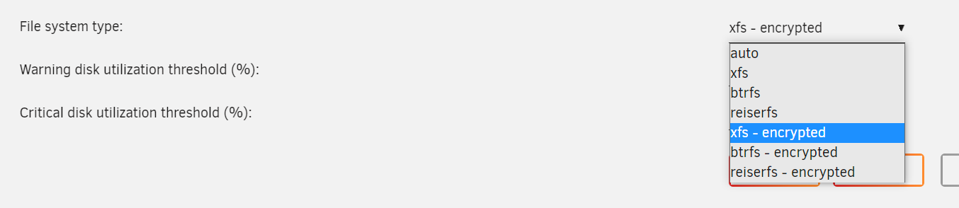

I would like to change the array file system that is currently in place from xfs to xfs - encrypted. However, I already have data stored on the array. The interface warns me that: I assume that means that I cannot change the file system on the disks without either doing one disk at a time and then rebuilding parity, or re-building the array from scratch (likely a faster option with the amount of data I have). Is there anything I can do to efficiently migrate the data from an unencrypted file system to an encrypted one?

Hi folks, after spending a fair bit of time hardening my SMB configuration I figured I'd write a quick guide on what I consider the best settings for the security of an SMB server running on Unraid 6.9.2. First, before we get into SMB settings, you may also want to consider hardening the data while it is at rest by specifying an encrypted file-system type for your array (although this isn't a share specific option). For SMB, first set the SMB settings available: I've settled on this as the following block is what I consider to be a hardened SMB configuration for a standalone server that is not domain joined or using Kerberos authentication: server min protocol = SMB3_11 client ipc min protocol = SMB3_11 client signing = mandatory server signing = mandatory client ipc signing = mandatory client NTLMv2 auth = yes smb encrypt = required restrict anonymous = 2 null passwords = No raw NTLMv2 auth = no This configuration block is to be entered into the SMB extras configuration section of the SMB settings page. These settings will break compatibility with legacy clients, but when I say legacy I'm talking like Windows Server 2003/XP. Windows 10+ clients should work without issue as they all support (but are not necessarily configured to REQUIRE) these security features. These settings force the following security options: All communications must occur via SMB v3.1.1 All communications force the use of signing for communications NTLMv2 authentication is required, LanMan authentication is implicitly disabled. All communications must be encrypted Anonymous access is disabled Null session access is disabled NTLMSSP is required for all NTLMv2 authentication attempts In addition, the following security settings are configured for each available share: Also ensure that you create a non-root user to access the shares with and that all accounts use strong passwords (Ideally 12+ complex characters). Finally, a couple of things to note: If you read the release notes for Unraid 6.9.2, you'll see that Unraid uses samba: version 4.12.14. This is extremely important. If you, like me, google SMB configuration settings you'll eventually come across the documentation for the current version of SMB. But! Unraid is not running the latest version, and that's extremely important. The correct documentation to follow is for the 4.12 branch of Samba and the configuration options are significantly different, enough that a valid config for 4.15 will not work for 4.12. With "null passwords = No" you must enable Secure or Private security modes on each exported Unraid share - guest access won't work. There is currently no way to add per-share custom smb.conf settings. So either the server gets hardened or it does not. Do not apply a [share_name] tag as it will not work. It is not possible to specify `client smb3 encryption algorithms` in version 4.12.x of Samba. Kerberos authentication and domain authentication may be preferable in other circumstances, in this instance, additional hardening options may be considered. If you, like me, use VLC media player on mobile devices, you may find that SMBv3 with encryption makes the host inaccessible on IOS devices. The VLC team is aware of this and there is a fix available if you have the bleeding edge/development version of the app, but not if you download the current store version (last I checked, the fix hadn't been released). Should work fine with Android/Windows VLC. If you have any suggestions for other options that I have not included here or that you think are a mistake. Please let me know and I'd be most happy to look into them and adjust. Some other quick hardening suggestions for unraid hardening in general. Disable whatever services you don't need. In my case, that means I: Disable NFS Disable FTP Disable 'Start APC UPS daemon' If you enable Syslog, also enable NTP and configure it. Disable Docker Quick note on docker, having the services enabled allows for 'ip forwarding' which could, in theory, be used to route traffic via the host to bypass firewall rules (depending on your network toplogy obviously) Hope that helps someone else out there. Cheers!

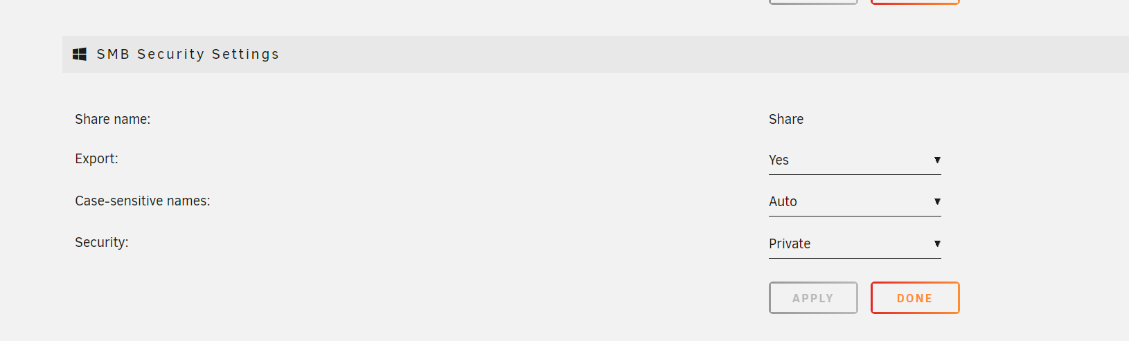

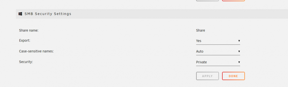

So I stopped the array, modifed the config as per the following screenshot and applied it: Then started the array. When browsing to \\server\ I can no longer see the share Additionally, I am still not seeing SMB3 traffic, but rather SMB2 (viewing the traffic in wireshark) Curiously, if I change the label from [Share] to [global] I can once again see \\server\share\ but alas, that's still being accessed via SMB2 as well Out of interest, can I shut the server down and then modify config from another machine so that it will persist at boot?
Hardening Samba/SMB Configuration
