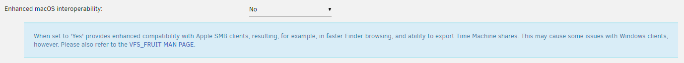

Just a note: In light of the current issues regarding CVE-2021-44142 I would strongly encourage SMB users to disable the 'Enhanced macOS interoperability' setting in the SMB settings page to mitigate the issues until a patch is released: As always seems to be the case in security, if you don't need a feature, disable it and reduce your attack surface.

Hopefully when 6.10 moves into stable it'll also be upgraded to include the patch. The announcement says 4.15.5 has the patch but 6.10.0rc2 is running version 4.15.0. As I understand it, this specifically affects devices that have enabled the vfs_fruit module. The vfs_fruit module provides enhanced compatibility with Apple SMB clients and interoperability with a Netatalk 3 AFP fileserver. The current workaround is to remove 'fruit' from 'vfs objects' lines in Samba configuration files (e.g., smb.conf). Specifically for Unraid, It is my understanding that the "Enhanced macOS interoperability" setting in SMB settings as seen here should be disabled: As this setting is reflected by the offending vfs objects in the smb-shares.conf: vfs objects = catia fruit streams_xattr I do not believe there is currently any PoC available so I can't test to confirm but I believe disabling the "Enhanced macOS interoperability" setting should mitigate this issue for now.
