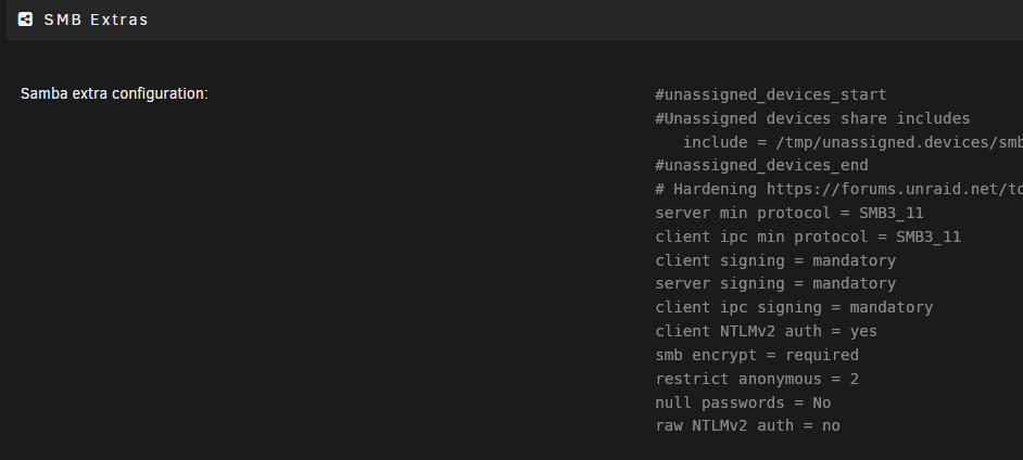

right now it's like this, so it's wrong? Do you mean that I have to add [global] in my config?
like
[global]
server min protocol = SMB3_11
client ipc min protocol = SMB3_11
client signing = mandatory
server....
like
[global]
server....
It probably works, but you should not assume [global].  Add the [global] tag ahead of your settings.
