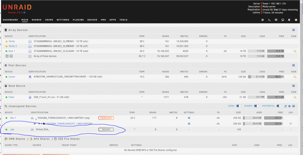

  4. Hi all, Finally getting the hang of Unraid (spaceinvader one videos are gold). Installed this a few days ago and have started messing around with it. I came across this issue where there is a "Virtual Disk_" in unassigned devices (image attached). I have been unable to unmount it. The system tells me it's not mounted. I first noticed that the server was taking a significant amount of time responding when using the GUI (simple operations such as going from Dashboard to Main to Shares). That prompted me to look at the syslog. I tracked it down to the /dev/sda device. Looks like there's a virtual disk. Goal is to remove it. I did go into the BIOS and disabled all IPMI virtual disk, virtual CD-ROMS, virtual anything as well. Has anyone come across this by any chance? Or perhaps can point me to other areas for me to research? This is a custom box from server parts: Supermicro X8SIL-F, Xeon x3430, 4GB of ECC RAM. syslog (4) (1)
  5. Add: Problem is: Because the system is taking a lot of time to respond, I tracked it down to SDA device. Goal is to remove it and see if that improves the system response time. Thnx!
  6. Hi all, Finally getting the hang of Unraid (spaceinvader one videos are gold). Installed this a few days ago and have started messing around with it. I came across this issue where there is a "Virtual Disk_" in unassigned devices (image attached). I have been unable to unmount it. The system tells me it's not mounted I first noticed that the server was taking a significant amount of time responding when using the GUI (simple operations such as going from Dashboard to Main to Shares). That prompted me to look at the syslog. Looks like there's a virtual disk in sda. Has anyone come across this by any chance? Or perhaps can point me to other areas for me to research? This is a custom box from server parts: Supermicro X8SIL-F, Xeon x3430, 4GB of ECC RAM. syslog (4)
