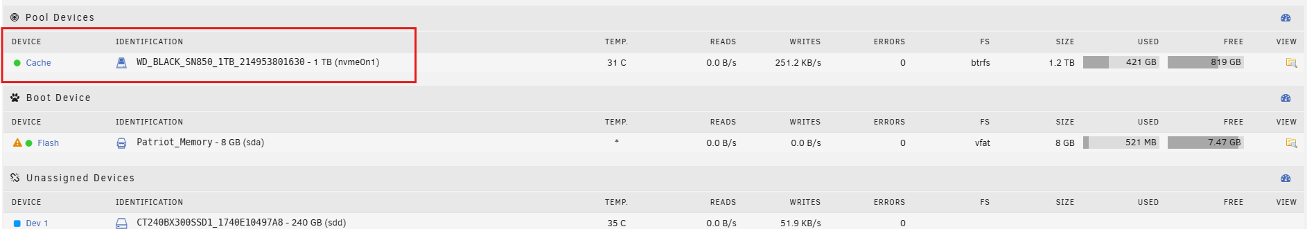

  2. Hello @JorgeB, that is correct. I would like to remove sdd.
  3. I find myself in a very similar situation as the gentleman in this post: Unraid Support Post I migrated my cache pool from a 240 GB SSD to a 1TB NVME and now have an unassigned 240 GB device that, when removed, renders the 1TB NVME unmountable with the following: "Cache pool BTRFS missing device(s)" I didn't go quite as far as the guy in the previous post, so I'm looking for guidance on next steps before I dig the hole any deeper. I'm wondering if I can just backup the cache pool files, delete the pool, recreate it, and restore the files? bitthurmzunraid-diagnostics-20250429-2008.zip
