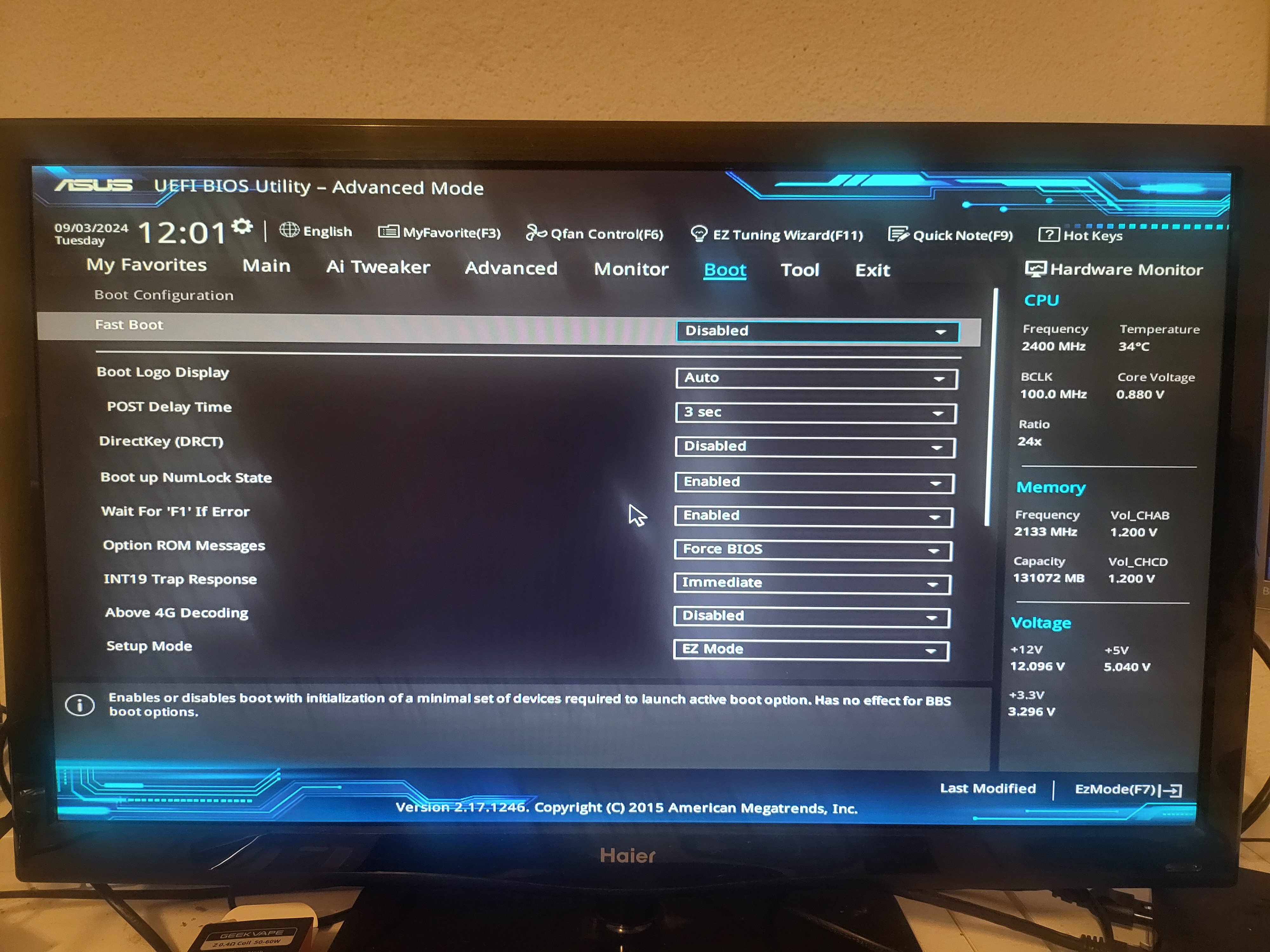

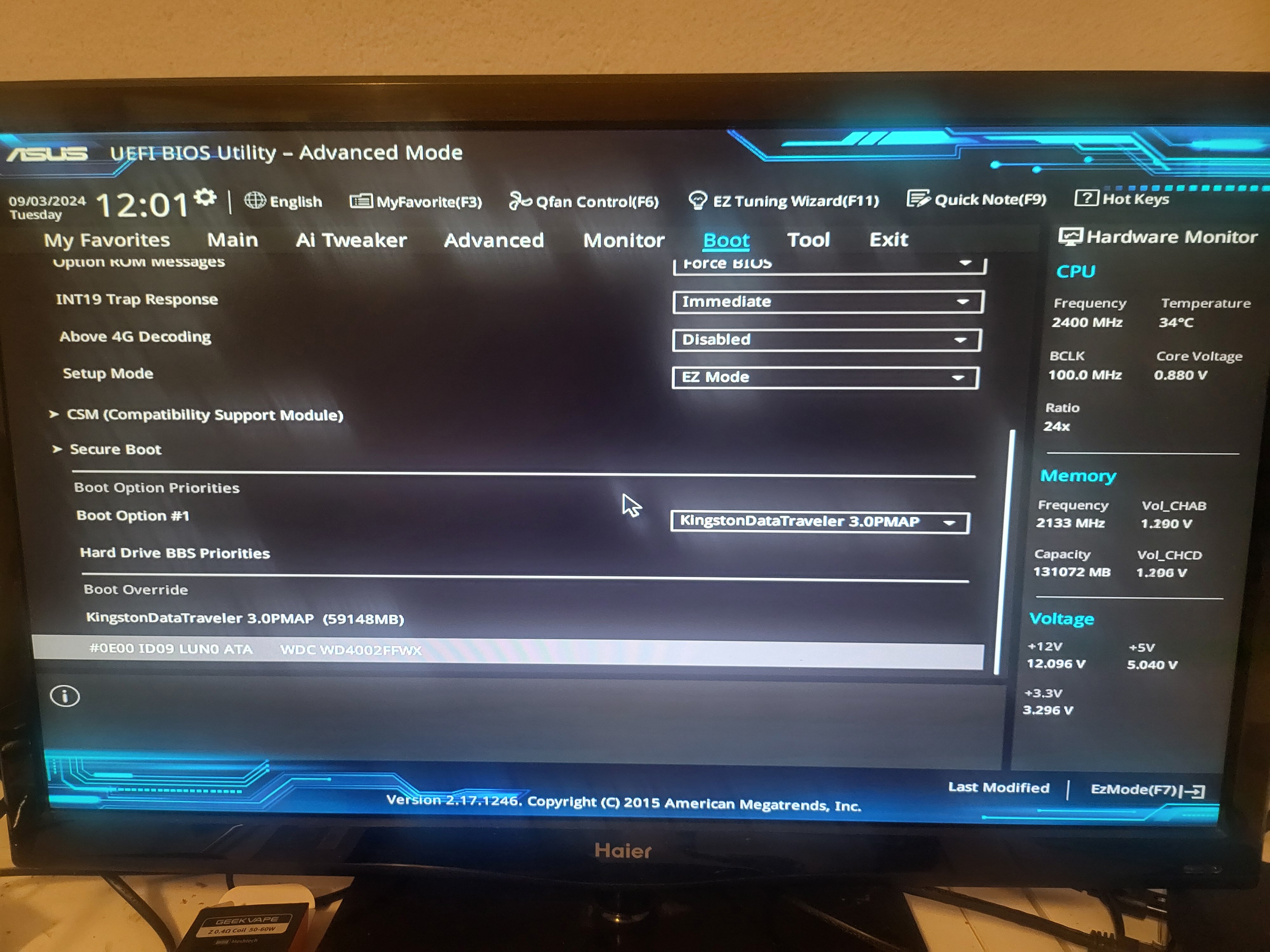

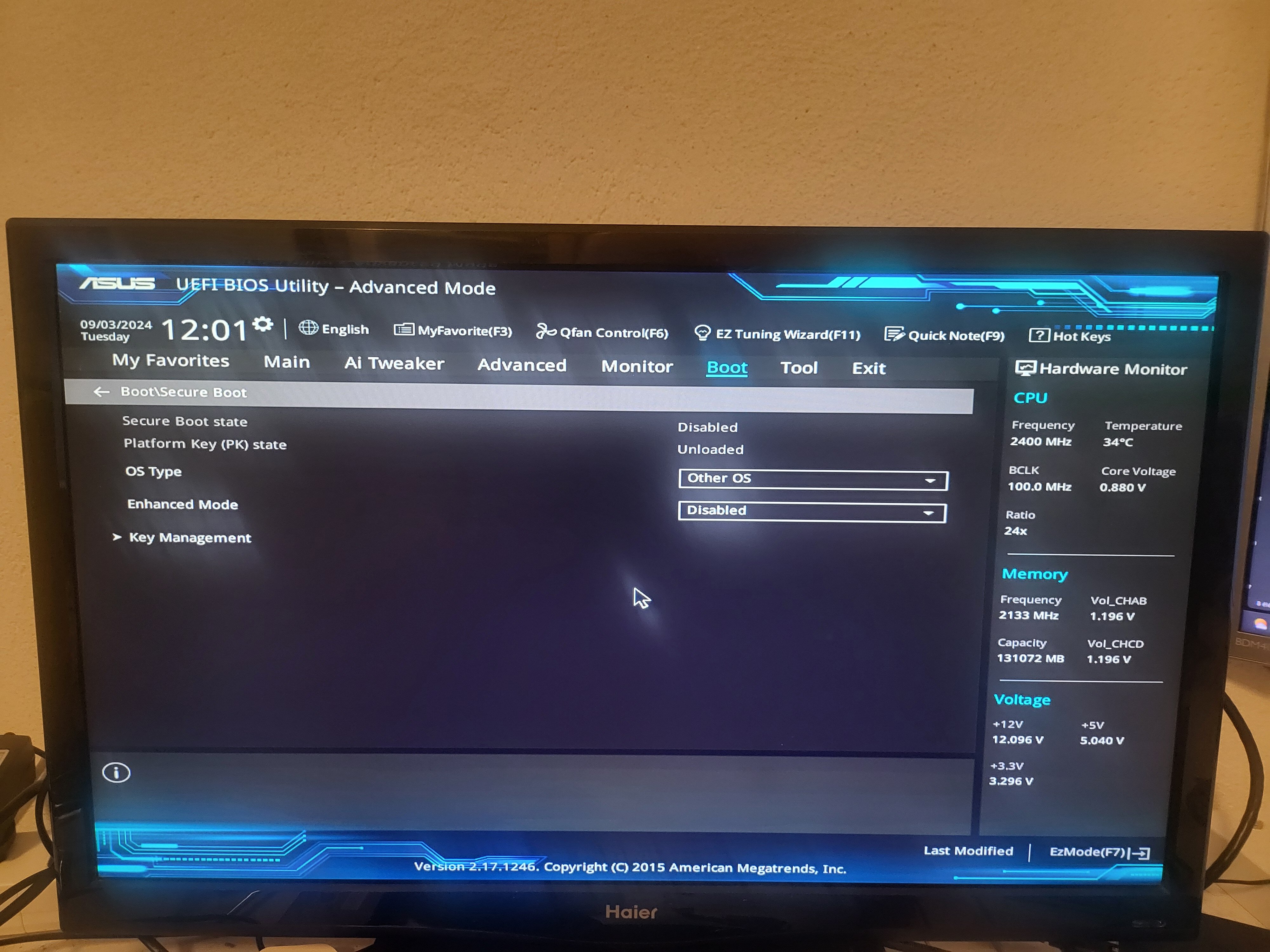

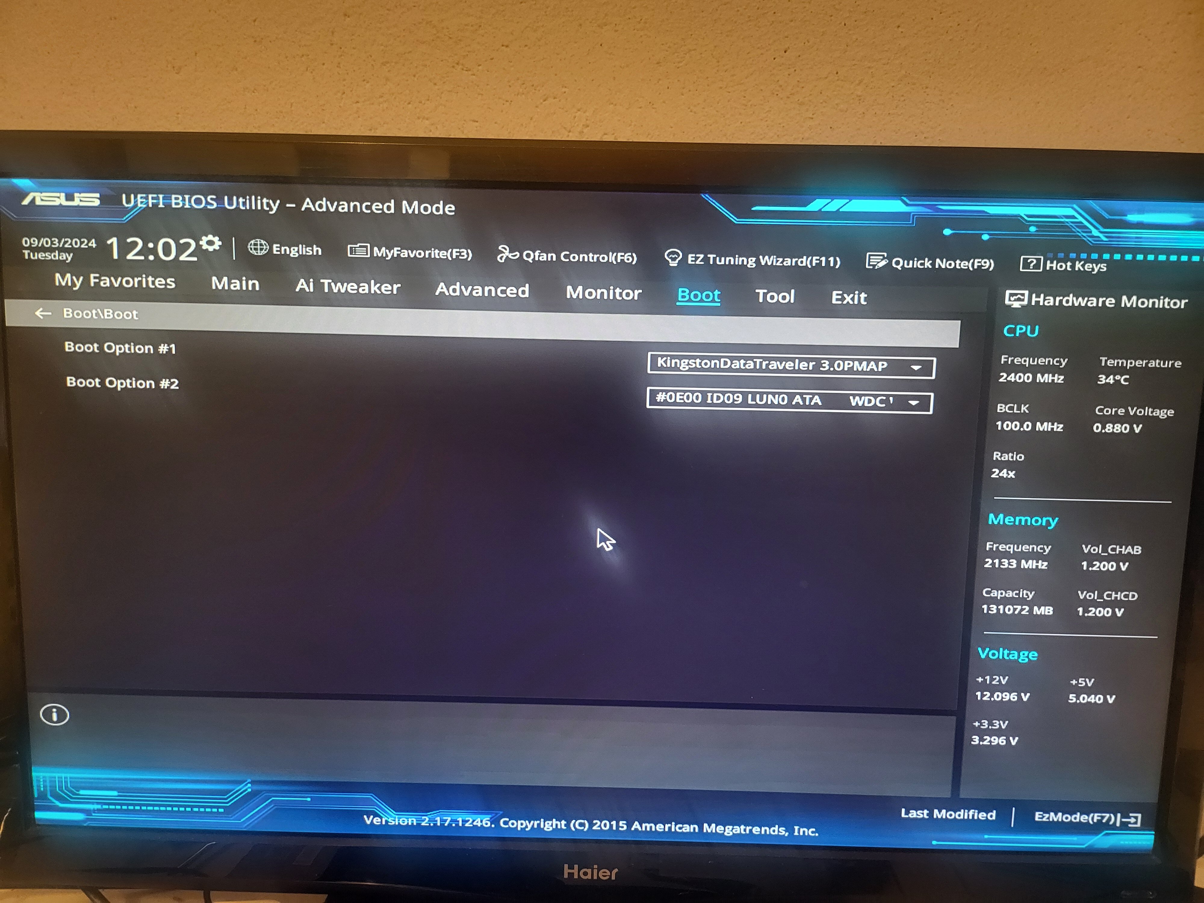

  3. yes I see the flash drive as Bootable. Please find below pics of the BIOS
  4. Legacy. Renamed the EFI folder to EFI- too Indeed, no menu
  5. Hello Unraiders, Got a bit of an issue here: I already have an Unraid server that is working fine (a Poweredge r510), and I'm building a new one with more bays and faster hardware. Specs: Motherboard: Asus x-99 WS USB3.1 2x LSI card in IT-Mode 128 GB or RAM Anyway, I'm creating the USB flash for the OS, popping it in the new server, boot, and.... Nothing.... I'm going back all the time in the BIOS I've disabled fast boot, set the OS to "Other OS", disable Secure Boot. I've tried to set the USB to Auto, Forced FDD, Hard Drive,... Tried many, if not all, combination possible.... Even changed the CMOS battery on the MB Now the strange thing is that.... A live CD version of Ubuntu works, I was able to boot the OS.... Even TrueNAS works! I really want to be able to use Unraid for the versatility of mixed HDDs, and would like to avoid having to resort to using TrueNAS if possible... Anyone have encountered any similar issue with their endeavor using Unraid?
