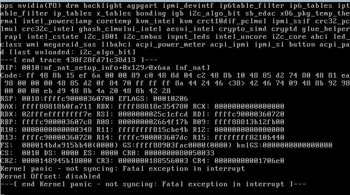

  3. it was set to local syslog to the appdata folder but there are no logs there; i enabeld mirror to flash
  4. ok happened again - screencap of error and diags ZIP = oddly enough around the same time my other one started doing it too and it was stuck; now these were both up earlier this AM i checked so sometime between 6:30a EST and now colossus-diagnostics-20220201-0938.zip

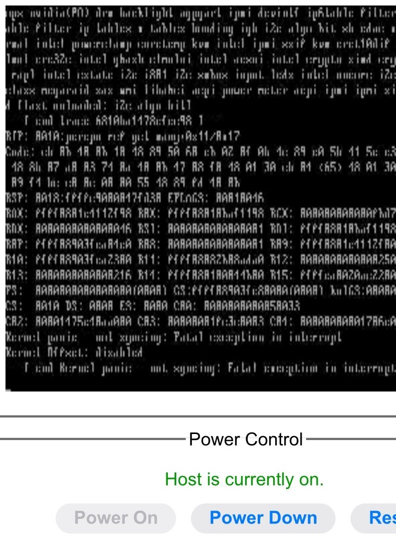

  6. The RAID controller doesn't have an 'IT mode' but it is in JBOD mode; there are no RAID's defined and the 'enable JBOD' option is selected - i forget the model RAID card but I did ensure JBOD was on; the BIOS is similar to a PERC H710 but as this is a SuperMicro system it's using a generic AVAGO/LSI card i believe. Yes, it actually crashes. Its hard to make out since I did it from my phone @ 6:20a this morning when i found it was offline but the screen cap is from the SuperMicro BIOS BMC - next time i will try and do it from the laptop

  8. In the last week my unRAID server has been kernel panicking nearly daily ... specs: - SuperMicro X10SRL-F - E5-2650 v3 - 64GB RAM - unRAID is on latest stable What logs/info can i get to help figure this out?
