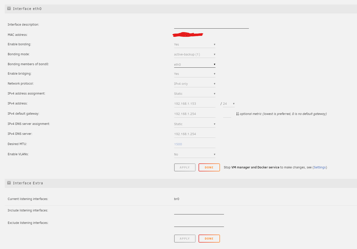

I have two VM's, Debian and Win10. Neither can ping any ip address other than the unraid ip. Pinging the router or any external address fails. Here is my network config:

Turns out the problem was actually with my network settings, when I restarted my unRAID server, the network connections stopped working again for both VM's. To resolve it I discovered that under network settings I had to enable bonding for eth0.
I enabled bonding for the NIC, set the mode to backup and only included eth0 in the bond.
After starting the VM's again, their network connections started working and the connections continued working after an unRAID restart.

I think I am having the same problem, but not certain as I have only tried setting up a VM this weekend, after I had already updated to 6.12. So I've not yet been able to get it running at all, I checked my network settings and bonding appears to be on already. Do these settings look correct for what you guys used to get it working again?
Thanks
Charlie
Edited by Charlie W
Thanks
Charlie

I am having the exact same issue, both bonding and bridging are set to yes. maybe I should try and ever to an older version of Unraid? anyone got any solutions?
