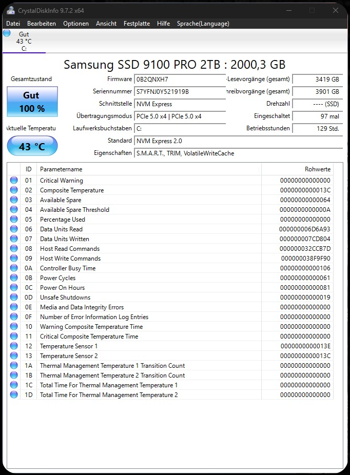

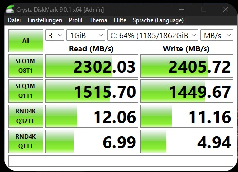

  2. Hi everyone, I have migrated my bare metal Windows 11 installation to an Unraid VM. While the system boots and runs, I am facing severe performance issues, specifically regarding disk I/O latency. Despite having high-end hardware, the VM feels sluggish. Right-clicking on the desktop takes ~3 seconds to open the context menu. Games take forever to load. Benchmarks confirm a massive bottleneck in 4K Random Reads. Hardware: CPU: AMD Ryzen 9 9950X (Zen 5) Motherboard: ASUS ROG Crosshair X870E Hero (BIOS updated to latest AGESA) RAM: [2x48GB DDR5-6000] GPU: NVIDIA RTX 5080 (Passed through) NVMe (System): Samsung 9100 PRO Gen 5 OEM (Passed through via PCI controller) Unraid Version: 7.2.2 The Problem: CrystalDiskMark inside the VM shows: Seq Read: ~2300 MB/s (Seems capped at PCIe 3.0 speeds? The drive is Gen 5). 4K Random Read (Q1T1): ~6 MB/s (This is drastically low and causing the lag). VM Configuration: Machine: pc-q35-9.2 Bios: OVMF TPM vDisk: None (Manual passthrough of the NVMe controller via "Other PCI Devices") CPU Pinning: Isolated CCD 1 completely (Cores 8-15 + Threads) for the VM. Emulator pinned to Core 0/16 (CCD 0). What I have tried so far (Extensive Troubleshooting): 1. BIOS / Host Level: Global C-States: Disabled IOMMU / SVM: Enabled PCIe Link Speed for M.2_1: Tried forcing Gen 5 (resulted in boot loop), currently on Auto/Gen4. Boot args: kernel /bzimage append pcie_acs_override=downstream,multifunction isolcpus=8-15 amd_pstate=disable iommu=pt initrd=/bzroot Note: amd_pstate=disable was necessary to prevent cores from dropping to 600 MHz. Now clocks are stable at 3000-5000 MHz. 2. Windows / VM Level: MSI Mode: Enabled (High Priority) for GPU, Audio Controller, and Standard NVM Express Controller using MSI Utility v3. VirtIO: All drivers installed (Balloon, Serial, NetKVM) via virtio-win-gt-x64.msi. Optimizations: Windows Power Plan: High Performance. Core Isolation / Memory Integrity: OFF. BitLocker: OFF / Fully Decrypted. Write Caching: Enabled in Device Manager (Turning off buffer flushing caused boot loops). Cleanup: Removed old "Ghost" devices (Samsung Magician drivers, old hidden devices) to fix timeouts. Benchmark Results (CrystalDiskMark inside VM): The Question: Why is the 4K performance so abysmal (6 MB/s) on a direct PCIe passthrough of a Gen 5 SSD? It feels like the interrupt handling or the PCIe link negotiation is broken. The sequential speed of ~2300 MB/s also suggests the drive is running at PCIe 3.0 x4 speeds instead of 4.0 or 5.0. Attached is my VM XML. Any help or ideas are greatly appreciated! XML Config: XML <?xml version='1.0' encoding='UTF-8'?> <domain type='kvm'> <name>Windows 11 Q35</name> <uuid>c69ace29-a030-1c38-4a27-ecaf5fe16117</uuid> <metadata> <vmtemplate xmlns="http://unraid" name="Windows 11" iconold="windows11.png" icon="windows11.png" os="windowstpm" webui="" storage="default"/> </metadata> <memory unit='KiB'>50331648</memory> <currentMemory unit='KiB'>50331648</currentMemory> <memoryBacking> <nosharepages/> </memoryBacking> <vcpu placement='static'>16</vcpu> <cputune> <vcpupin vcpu='0' cpuset='8'/> <vcpupin vcpu='1' cpuset='24'/> <vcpupin vcpu='2' cpuset='9'/> <vcpupin vcpu='3' cpuset='25'/> <vcpupin vcpu='4' cpuset='10'/> <vcpupin vcpu='5' cpuset='26'/> <vcpupin vcpu='6' cpuset='11'/> <vcpupin vcpu='7' cpuset='27'/> <vcpupin vcpu='8' cpuset='12'/> <vcpupin vcpu='9' cpuset='28'/> <vcpupin vcpu='10' cpuset='13'/> <vcpupin vcpu='11' cpuset='29'/> <vcpupin vcpu='12' cpuset='14'/> <vcpupin vcpu='13' cpuset='30'/> <vcpupin vcpu='14' cpuset='15'/> <vcpupin vcpu='15' cpuset='31'/> <emulatorpin cpuset='0,16'/> </cputune> <os> <type arch='x86_64' machine='pc-q35-9.2'>hvm</type> <loader readonly='yes' type='pflash' format='raw'>/usr/share/qemu/ovmf-x64/OVMF_CODE-pure-efi-tpm.fd</loader> <nvram format='raw'>/etc/libvirt/qemu/nvram/c69ace29-a030-1c38-4a27-ecaf5fe16117_VARS-pure-efi-tpm.fd</nvram> <boot dev='hd'/> </os> <features> <acpi/> <apic/> <hyperv mode='custom'> <relaxed state='on'/> <vapic state='on'/> <spinlocks state='on' retries='8191'/> <vpindex state='on'/> <synic state='on'/> <stimer state='on'/> <vendor_id state='on' value='none'/> </hyperv> </features> <cpu mode='host-passthrough' check='none' migratable='on'> <topology sockets='1' dies='1' clusters='1' cores='8' threads='2'/> <cache mode='passthrough'/> <feature policy='require' name='topoext'/> </cpu> <clock offset='localtime'> <timer name='hpet' present='no'/> <timer name='hypervclock' present='yes'/> </clock> <on_poweroff>destroy</on_poweroff> <on_reboot>restart</on_reboot> <on_crash>restart</on_crash> <devices> <emulator>/usr/local/sbin/qemu</emulator> <disk type='file' device='cdrom'> <driver name='qemu' type='raw'/> <source file='/mnt/user/isos/virtio-win-0.1.285-1.iso'/> <target dev='hdb' bus='sata'/> <readonly/> <address type='drive' controller='0' bus='0' target='0' unit='1'/> </disk> <controller type='usb' index='0' model='qemu-xhci' ports='15'> <address type='pci' domain='0x0000' bus='0x00' slot='0x07' function='0x0'/> </controller> <controller type='pci' index='0' model='pcie-root'/> <controller type='pci' index='1' model='pcie-root-port'> <model name='pcie-root-port'/> <target chassis='1' port='0x8'/> <address type='pci' domain='0x0000' bus='0x00' slot='0x01' function='0x0' multifunction='on'/> </controller> <controller type='pci' index='2' model='pcie-root-port'> <model name='pcie-root-port'/> <target chassis='2' port='0x9'/> <address type='pci' domain='0x0000' bus='0x00' slot='0x01' function='0x1'/> </controller> <controller type='pci' index='3' model='pcie-root-port'> <model name='pcie-root-port'/> <target chassis='3' port='0xa'/> <address type='pci' domain='0x0000' bus='0x00' slot='0x01' function='0x2'/> </controller> <controller type='pci' index='4' model='pcie-root-port'> <model name='pcie-root-port'/> <target chassis='4' port='0xb'/> <address type='pci' domain='0x0000' bus='0x00' slot='0x01' function='0x3'/> </controller> <controller type='pci' index='5' model='pcie-root-port'> <model name='pcie-root-port'/> <target chassis='5' port='0xc'/> <address type='pci' domain='0x0000' bus='0x00' slot='0x01' function='0x4'/> </controller> <controller type='pci' index='6' model='pcie-root-port'> <model name='pcie-root-port'/> <target chassis='6' port='0xd'/> <address type='pci' domain='0x0000' bus='0x00' slot='0x01' function='0x5'/> </controller> <controller type='pci' index='7' model='pcie-root-port'> <model name='pcie-root-port'/> <target chassis='7' port='0xe'/> <address type='pci' domain='0x0000' bus='0x00' slot='0x01' function='0x6'/> </controller> <controller type='pci' index='8' model='pcie-root-port'> <model name='pcie-root-port'/> <target chassis='8' port='0xf'/> <address type='pci' domain='0x0000' bus='0x00' slot='0x01' function='0x7'/> </controller> <controller type='virtio-serial' index='0'> <address type='pci' domain='0x0000' bus='0x02' slot='0x00' function='0x0'/> </controller> <controller type='sata' index='0'> <address type='pci' domain='0x0000' bus='0x00' slot='0x1f' function='0x2'/> </controller> <interface type='bridge'> <mac address='52:54:00:33:d4:1f'/> <source bridge='br0'/> <model type='virtio-net'/> <address type='pci' domain='0x0000' bus='0x01' slot='0x00' function='0x0'/> </interface> <serial type='pty'> <target type='isa-serial' port='0'> <model name='isa-serial'/> </target> </serial> <console type='pty'> <target type='serial' port='0'/> </console> <channel type='unix'> <target type='virtio' name='org.qemu.guest_agent.0'/> <address type='virtio-serial' controller='0' bus='0' port='1'/> </channel> <input type='mouse' bus='ps2'/> <input type='keyboard' bus='ps2'/> <tpm model='tpm-tis'> <backend type='emulator' version='2.0' persistent_state='yes'/> </tpm> <audio id='1' type='none'/> <hostdev mode='subsystem' type='pci' managed='yes'> <driver name='vfio'/> <source> <address domain='0x0000' bus='0x01' slot='0x00' function='0x0'/> </source> <rom file='/mnt/user/isos/vbios/rtx5080.rom'/> <address type='pci' domain='0x0000' bus='0x03' slot='0x00' function='0x0'/> </hostdev> <hostdev mode='subsystem' type='pci' managed='yes'> <driver name='vfio'/> <source> <address domain='0x0000' bus='0x01' slot='0x00' function='0x1'/> </source> <address type='pci' domain='0x0000' bus='0x04' slot='0x00' function='0x0'/> </hostdev> <hostdev mode='subsystem' type='pci' managed='yes'> <driver name='vfio'/> <source> <address domain='0x0000' bus='0x02' slot='0x00' function='0x0'/> </source> <address type='pci' domain='0x0000' bus='0x05' slot='0x00' function='0x0'/> </hostdev> <hostdev mode='subsystem' type='pci' managed='yes'> <driver name='vfio'/> <source> <address domain='0x0000' bus='0x0a' slot='0x00' function='0x0'/> </source> <address type='pci' domain='0x0000' bus='0x06' slot='0x00' function='0x0'/> </hostdev> <hostdev mode='subsystem' type='pci' managed='yes'> <driver name='vfio'/> <source> <address domain='0x0000' bus='0x79' slot='0x00' function='0x0'/> </source> <address type='pci' domain='0x0000' bus='0x07' slot='0x00' function='0x0'/> </hostdev> <watchdog model='itco' action='reset'/> <memballoon model='none'/> </devices> </domain>
