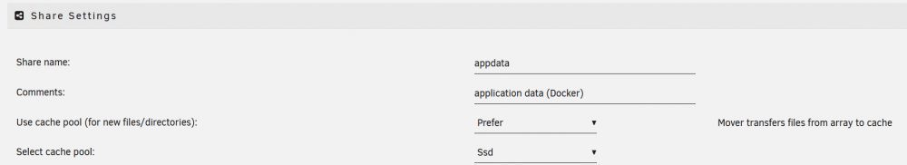

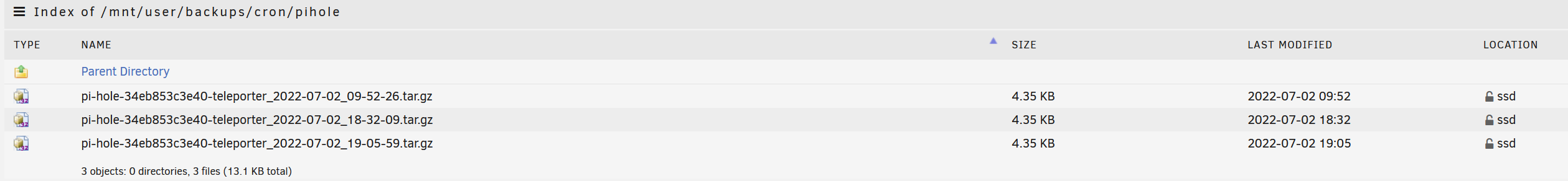

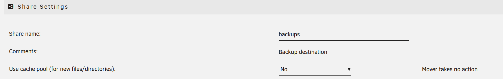

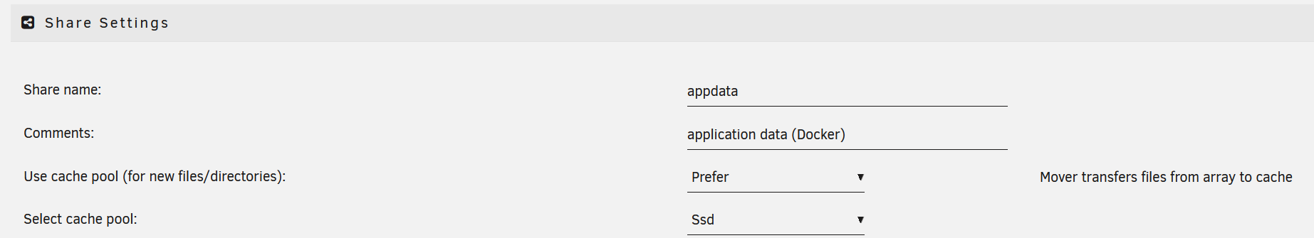

  2. Hi. I have user share 'appdata' which is prefer cache (pool: "ssd"). I have a different user share 'backup' which is on the array only. When I run the following cron job, I expect the pi-hole file in the backup user share to be on any disk in the array, but instead I find it to be on the ssd cache pool (but still in the correct user share). # make backup docker exec pihole bash -c "cd /etc/backups; pihole -a -t" #note: this mounts to volume /mnt/user/appdata/pihole/backups # move backup to share mv /mnt/user/appdata/pihole/backups/pi-hole-*-teleporter_*.tar.gz /mnt/user/backups/cron/pihole/ # remove backups older than 7 days find /mnt/user/backups/cron/pihole/ -type f -name 'pi-hole-*-teleporter_*.tar.gz' -mtime +7 -delete My question is: How do I make the mv command actually move the file from the ssd cache to the disks assigned to the backup share. Thanks for your time!
