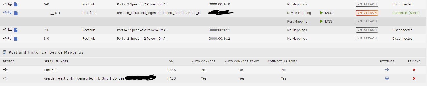

Passthrough of ConBee II Zigbee USB Gateway to Home Assistant Virtual Machine
I had to edit the core.config_entries file is HASS to reflect a change in the device path. Old path: /dev/serial/by-id/usb-QEMU_QEMU_USB_SERIAL_1-0000:00:07.7-4-if00-port0 New path: /dev/serial/by-id/usb-QEMU_QEMU_USB_SERIAL_1-0000:00:07.0-4-if00-port0 All is working again now. I am still getting the serial and console entries but since everything seems to work I am not going to worry with it. <serial type='dev'> <source path='/dev/serial/by-id/usb-dresden_elektronik_ingenieurtechnik_GmbH_ConBee_II_DE24XXXXX-if00'/> <target type='usb-serial' port='1'> <model name='usb-serial'/> </target> <alias name='ua-serial006004'/> <address type='usb' bus='0' port='4'/> </serial> <console type='dev'> <source path='/dev/serial/by-id/usb-dresden_elektronik_ingenieurtechnik_GmbH_ConBee_II_DE24XXXXX-if00'/> <target type='serial' port='1'/> <alias name='ua-serial006004'/> <address type='usb' bus='0' port='4'/> </console>

Is it possible it is because I have the port enabled as well? Should we enable the base USB port or just the device itself?

I shut down my VM and edited the XML file to remove all references of a serial connection and all references of my ConBee II. I then enabled the automatic attachment of the device in USB Manager and selected to attach as serial only. Started up the VM and all seems good. Home Assistant sees the device and my integration and all devices show properly. Great Job!! One question for you though. When I go back to view the VM XML, I see a serial entry and a console entry for the ConBee like in this snippet. Is that normal? <serial type='dev'> <source path='/dev/serial/by-id/usb-dresden_elektronik_ingenieurtechnik_GmbH_ConBee_II_DEXXXXXXX-if00'/> <target type='usb-serial' port='1'> <model name='usb-serial'/> </target> <alias name='ua-serial006002'/> <address type='usb' bus='0' port='4'/> </serial> <console type='dev'> <source path='/dev/serial/by-id/usb-dresden_elektronik_ingenieurtechnik_GmbH_ConBee_II_DEXXXXXXX-if00'/> <target type='serial' port='1'/> <alias name='ua-serial006002'/> <address type='usb' bus='0' port='4'/> </console> Also, for anyone else seeing this. I did not have to edit the "core.device_registry" file under the .storage directory within HASS. What I detailed above is the only changes I had to make.

Is there a setting that we would need to change to specify the serial connection option or is it automatically determined somehow? Nevermind.... After updating the plugin, I now see the toggle for "Connect as Serial Only". Thank you.

Check your VM xml. Mine had a double entry for the ConBee after upgrade where one of the entries was wrapped in a <console> tag. I removed that entry and only left the <serial> tagged entry and everything started working. I have no idea what is adding the second <console> entry though.
