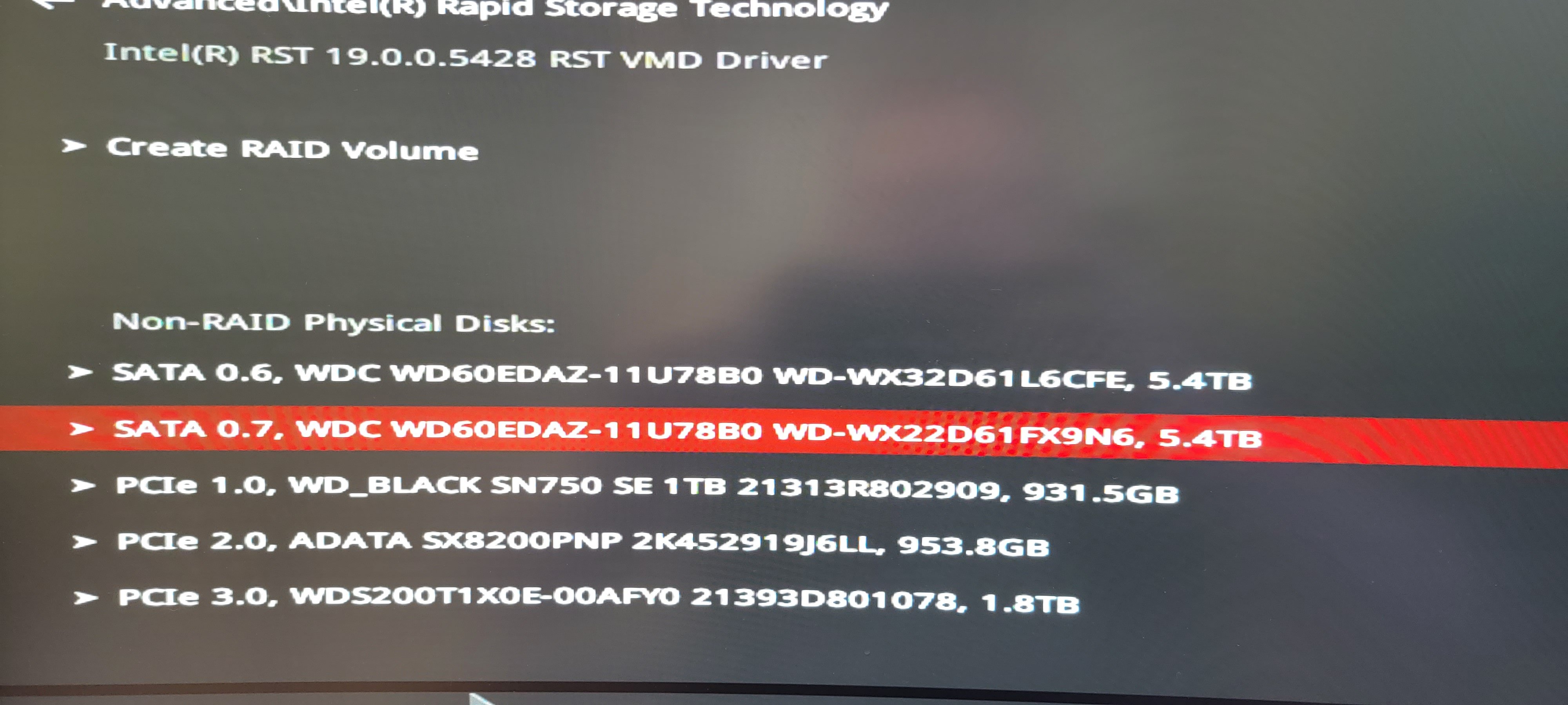

  8. Aha! It seems when I switch CSM compatibility mode off in BIOS an Intel Rapid Storage Technology option appears. When I turn that off then I can now access all drives in Unraid. So weird. This is a new board and slightly different BIOS than I am used to so it's taking some finagling to find certain options. Thanks everyone for your help!

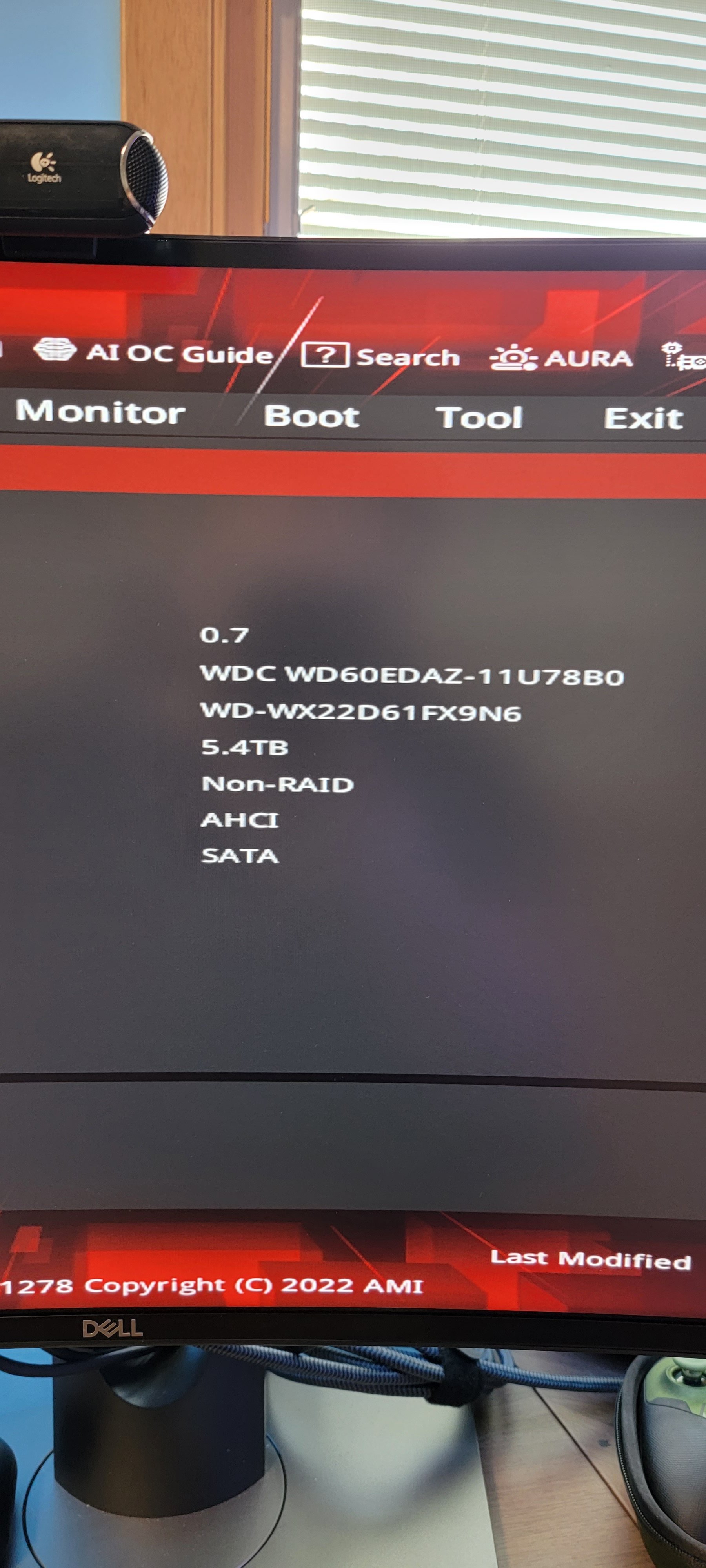

  9. Ok, so changing the ports to the ones you highlighted worked because I can't even do RAID using those ports. Thank you very much. No to try and figure out how to change my ADATA SSD to non-RAID in BIOS. I cannot seem to find it. Even changed it to CSM compatibility mode and still nothing. Moving onto the ASUS forums but every step they say to use for turning off RAID doesn't exist on my BIOS...
  10. I'll give that a try thank you. I currently have them in G3 and G4 SATA ports. According to my BIOS though it says none of my drives are in RAID...
  11. In fact, all of my SSDs and HDDs are non RAID.
  12. The disks look to be in AHCI not raid, according to my BIOS

  14. Here is the diagnostic gingaranga-diagnostics-20220223-1355.zip
