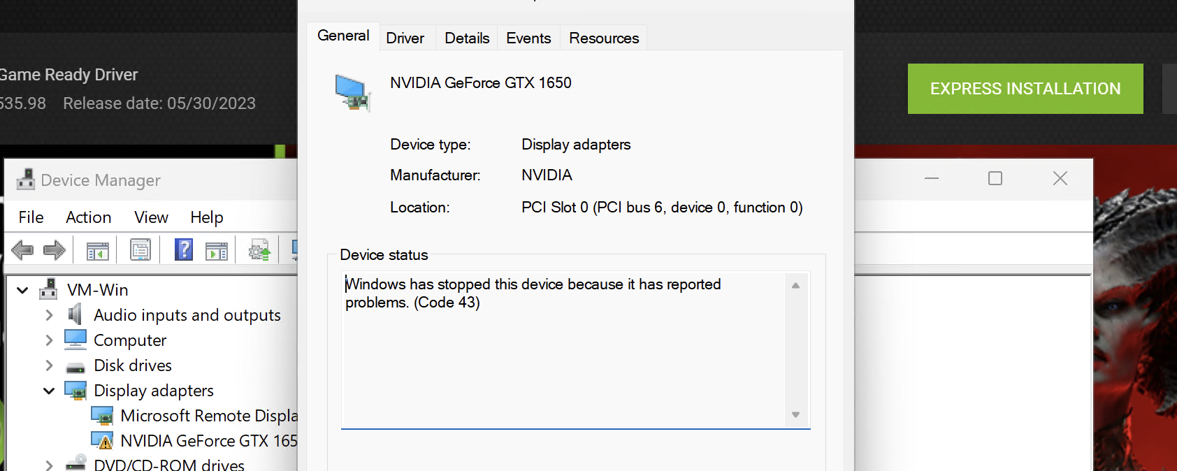

  6. Hi, already did, it kind of does not recognize. I still get error 43 and the Geforce Experience shows that drivers are not installed, no matter how many times I install them.

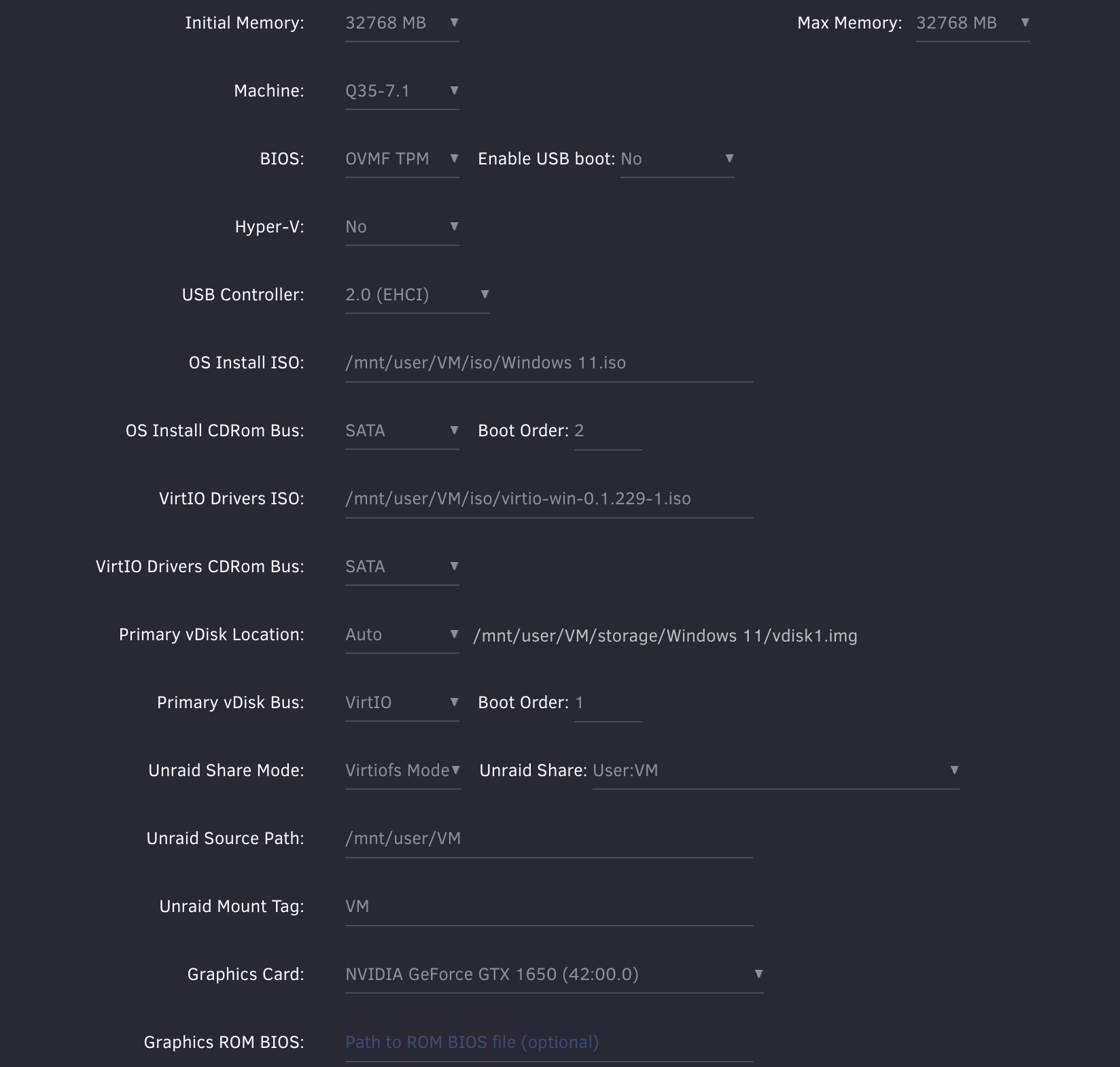

  7. Anyone? I can see the GPU in VM, but it has error code 43 with Yellow warning on it. I have changed xml correctly to have them on same virtual bus etc
