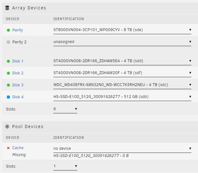

  14. diagnostics attached titan-diagnostics-20230501-1118.zip
