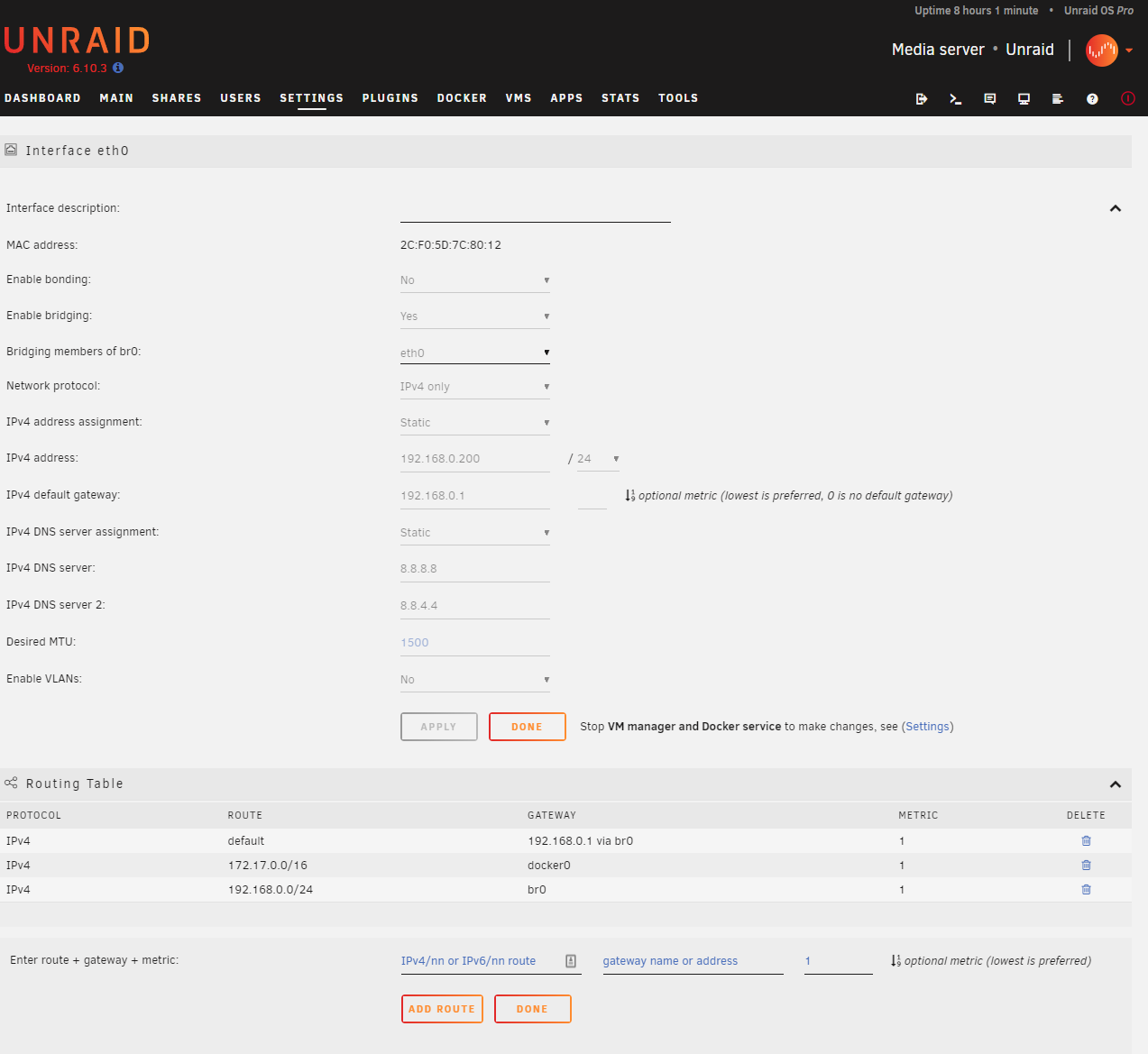

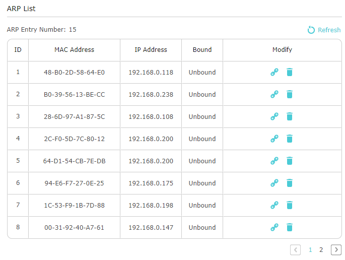

Alright, still struggling but hopefully making some progress? On the ARP list on my router, two entries are coming up for my server (192.168.0.200) - both of them go away when I turn the server off. The 2c.XX one is the mac address of the motherboard - I don't know what the 64.XX one is. But maybe that is the issue? I do have 192.168.0.200 reserved for the 2c.XX mac address in the dhcp menu on my router.

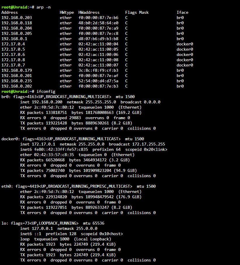

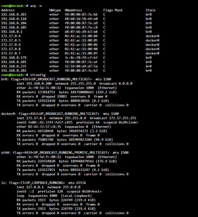

huh, the address and mac address for the server don't show up in arp -n. Should I add it with the arp command? I've never used arp before. The windows VM is showing up on this list. Also the broadcast for br0 is showing up as 0.0.0.0 - not sure if that is also an issue
