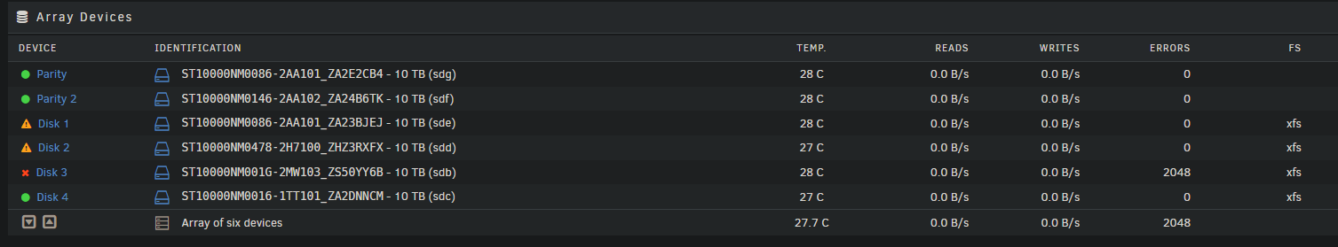

  5. Upgraded to an LSI SAS 9207-8i, booted up, all drives appeared, threw it into maintenance mode, logs and everything looked good. started sync, and it instantly killed another drive with errors. So now I have 2 emulated drives and a disabled drive. vortex-diagnostics-20220427-1946.zip

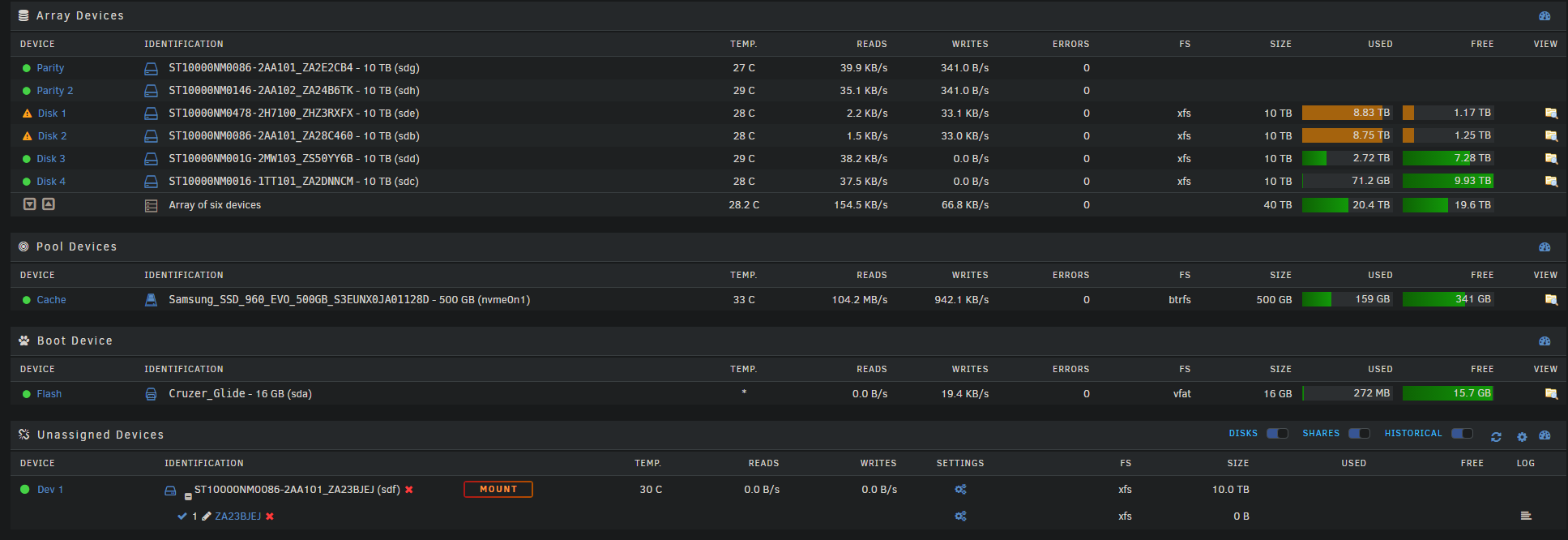

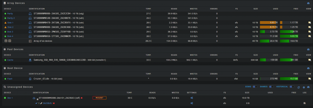

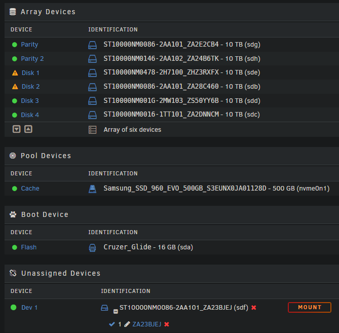

  7. I'm not quite sure what your suggesting I do. However I currently only have a single disk that isn't in the array and unless I'm mistaken I currently couldn't swap the parity disk with another drive anyways since I have 2 emulated data disks. So what is the best path/steps forward to resolve this without data loss? I do currently have another sata controller on the way that I purchased from the list reccomended above and will be moving all sata cables/hdds off the motherboard as well. Should I go ahead and purchase another drive? I'd rather not due to how expensive the 10tb drives are but I can if that's the only solution. Its also worth noting that the currently out-of-array JEJ drive was having the same issues as the current parity #2 drive which is why I swapped it out of the array with the brand new disk.

  9. Hello, I was unable to find any ASPM settings in the BIOS for this motherboard. I'm also unable to swap around any more disks. I currently have 2 emulated data disks and the only disk throwing the drive errors currently is a parity disk. I've uploaded a new diagnostics file while the array is running in maintenance mode. From what I can tell, I need to do a rebuild to get the current drives running however the rebuild runs at like 30kb's while the parity disk spams errors if I attempt to. As it stands with the current configuration all disks are working properly without spamming the previous errors except for parity disk 2. vortex-diagnostics-20220416-1055.zip
