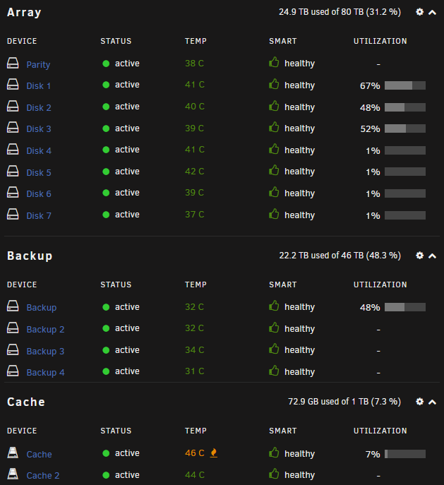

  3. I have what looks like a bug in Unraid. No shares use or have selected the newly created "Backup" pool. This new pool is used entirely to back up contents from the array. The existing "Cache" pool is for copying to the server only. However, when accessing files I frequently have to wait for the Backup pool drives to spin up from sleep mode. As well, the shares are reporting the time stamps of the files in the Backup pool instead of the Array. Based on how I understand the documentation and expect this to work then this should be classified as a bug.
