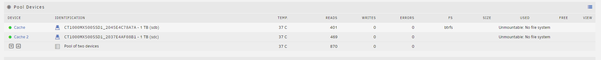

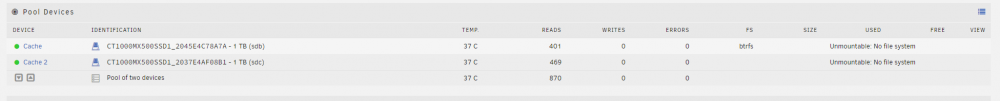

I'm having it too with standard SSD's.. find any cause?
Jun  8 03:18:34 FortyTwo kernel: BTRFS error (device sdb1): block=455832535040 write time tree block corruption detected
Jun  8 03:18:34 FortyTwo kernel: BTRFS: error (device sdb1) in btrfs_commit_transaction:2438: errno=-5 IO failure (Error while writing out transaction)
Jun  8 03:18:34 FortyTwo kernel: BTRFS info (device sdb1): forced readonly
Jun  8 03:18:34 FortyTwo kernel: BTRFS warning (device sdb1): Skipping commit of aborted transaction.
Jun  8 03:18:34 FortyTwo kernel: BTRFS: error (device sdb1) in cleanup_transaction:2011: errno=-5 IO failure
Jun  8 03:18:36 FortyTwo kernel: blk_update_request: I/O error, dev loop2, sector 29152 op 0x1:(WRITE) flags 0x100000 phys_seg 1 prio class 0
Jun  8 03:18:36 FortyTwo kernel: BTRFS error (device loop2): bdev /dev/loop2 errs: wr 1, rd 0, flush 0, corrupt 0, gen 0
Jun  8 03:18:36 FortyTwo kernel: blk_update_request: I/O error, dev loop2, sector 458944 op 0x1:(WRITE) flags 0x1800 phys_seg 1 prio class 0
Jun  8 03:18:36 FortyTwo kernel: BTRFS error (device loop2): bdev /dev/loop2 errs: wr 2, rd 0, flush 0, corrupt 0, gen 0
Jun  8 03:18:36 FortyTwo kernel: blk_update_request: I/O error, dev loop2, sector 983232 op 0x1:(WRITE) flags 0x1800 phys_seg 1 prio class 0
Jun  8 03:18:36 FortyTwo kernel: BTRFS error (device loop2): bdev /dev/loop2 errs: wr 3, rd 0, flush 0, corrupt 0, gen 0
Jun  8 03:18:36 FortyTwo kernel: blk_update_request: I/O error, dev loop2, sector 459392 op 0x1:(WRITE) flags 0x1800 phys_seg 2 prio class 0
Jun  8 03:18:36 FortyTwo kernel: BTRFS error (device loop2): bdev /dev/loop2 errs: wr 4, rd 0, flush 0, corrupt 0, gen 0
Jun  8 03:18:36 FortyTwo kernel: blk_update_request: I/O error, dev loop2, sector 983680 op 0x1:(WRITE) flags 0x1800 phys_seg 2 prio class 0
Jun  8 03:18:36 FortyTwo kernel: BTRFS error (device loop2): bdev /dev/loop2 errs: wr 5, rd 0, flush 0, corrupt 0, gen 0
Jun  8 03:18:36 FortyTwo kernel: blk_update_request: I/O error, dev loop2, sector 460448 op 0x1:(WRITE) flags 0x1800 phys_seg 8 prio class 0
Jun  8 03:18:36 FortyTwo kernel: BTRFS error (device loop2): bdev /dev/loop2 errs: wr 6, rd 0, flush 0, corrupt 0, gen 0
Jun  8 03:18:36 FortyTwo kernel: BTRFS error (device loop2): bdev /dev/loop2 errs: wr 7, rd 0, flush 0, corrupt 0, gen 0
Jun  8 03:18:36 FortyTwo kernel: blk_update_request: I/O error, dev loop2, sector 984736 op 0x1:(WRITE) flags 0x1800 phys_seg 8 prio class 0
Jun  8 03:18:36 FortyTwo kernel: BTRFS error (device loop2): bdev /dev/loop2 errs: wr 8, rd 0, flush 0, corrupt 0, gen 0
Jun  8 03:18:36 FortyTwo kernel: BTRFS error (device loop2): bdev /dev/loop2 errs: wr 9, rd 0, flush 0, corrupt 0, gen 0
Jun  8 03:18:36 FortyTwo kernel: BTRFS: error (device loop2) in free_log_tree:3451: errno=-5 IO failure
Jun  8 03:18:36 FortyTwo kernel: BTRFS info (device loop2): forced readonly
Jun  8 03:18:36 FortyTwo kernel: BTRFS warning (device loop2): Skipping commit of aborted transaction.
Jun  8 03:18:36 FortyTwo kernel: BTRFS: error (device loop2) in cleanup_transaction:2011: errno=-5 IO failure
Jun  8 03:18:36 FortyTwo kernel: blk_update_request: I/O error, dev loop2, sector 32928 op 0x1:(WRITE) flags 0x800 phys_seg 2 prio class 0
Jun  8 03:18:36 FortyTwo kernel: BTRFS error (device loop2): bdev /dev/loop2 errs: wr 10, rd 0, flush 0, corrupt 0, gen 0
Jun  8 03:28:38 FortyTwo root: Restoring original turbo write mode
Jun  8 03:28:38 FortyTwo kernel: mdcmd (129): set md_write_method auto
Jun  8 03:44:08 FortyTwo kernel: blk_update_request: I/O error, dev loop2, sector 29152 op 0x1:(WRITE) flags 0x100000 phys_seg 1 prio class 0
Jun  8 03:44:08 FortyTwo kernel: BTRFS error (device loop2): bdev /dev/loop2 errs: wr 11, rd 0, flush 0, corrupt 0, gen 0
BTFRS has been the single most unstable thing with my UnRAID experience thus far..
Please post the complete diagnostics.
yeah BTFRS is completely unmountable now.. never had it this bad before..
even set up a script to regularly monitor for corruption. Damn thing just keeps screwing up.
It just says the filesystem is unmountable now, like it's all gone.. thinking I'll just to xfs from now on.. haven't had btfrs be stable despite changing s-ata connections, cables, power delivery and even switching to new SSD's entirely.
Annoying.
Please advise, otherwise I think I'll just have to recover from backup appdata.
Edited by Froberg

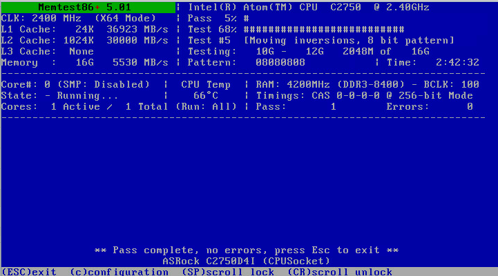

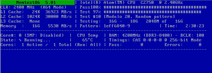

Errors you're having suggest a possible RAM issue, start by running memtest, after that there are some recovery options here.
What makes you suspect a memory issue? It's ECC memory and it's been put through memtest before.. I'll usually get 8-12 months out of the btfrs cache before it implodes..
This means btrfs detected corruption before writing the data to the disk, it usually indicates RAM or other kernel memory corruption.

So thread necrophilia is a thing. I just switched to a new system and I am putting this old one through its paces before deciding whether to use it as an upgrade for my backup-server, that's only running intermittently.
One thing I did notice recently was the log drive filling up quite rapidly, but I couldn't see any immediate issues. Switched to running single-disk cache, now back to running btfrs raid1 in the new system.
Here's the new system:
Uptime is close to five days. The old one would rise to 30% log usage within a day usually. Usually with the btfrs issue I found out when the log was full and related issues started to occur, rebooting fixed the log-issue and then I'd be able to tell that btfrs was FUBAR'ed.
It's been happening with varying frequency. I did discover just now, that since I'm using Dynamix I was supposed to increase the size of the log, so I changed it to 512 megs with mount -o remount,size=512m /var/log - maybe that will help with the issue I was having.
Can btfrs corrupt if the system runs out of memory somehow?
Memtest is currently running on my test bench and is showing no issues, running the latest version of memtest.. going to let it complete regardless.
Any specific memtest config or something you want me to try out to be sure? I don't want to rely on the board and memory for my backup box if it's the cause of my issues after all.
A 24H memtest while not definitive will catch most issues.
Four hours to complete the test.. all passed.
Memtest free won't let you run more than four passes, not sure how I'd accomplish a 24 hour test from looking at the settings.
I'm running another test now though.
I've re-run the tests five times now.. still going strong with zero errors.
