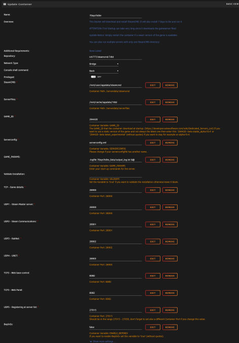

  6. I have been banging my head with the satisfactory hammer for the past 2 hours trying to get this to run I have uninstalled the docker cleared the remains via appdata clean up reinstalled check game parameters for the so called mulithome (did not find it) left everything else as is started the docker it did the download the logs show as seen in this paste bin https://pastebin.com/f8bG1WUM Satisfactory logs unraid dedicated docker Tried force updating TOTAL DATA PULLED: 0 B restarted again https://pastebin.com/0TYRA5yF Satisfactory logs unraid dedicated docker #log2
  7. So i couldn't figure out where the heck i needed to get this docker run thing to go Since posting yesterday i have managed to get the docker to run but i am unable to connect to the actually server i have set up the config i have port foorwarded the IP but it wont let me connect when i try to look at logs/console for the docker it almost instantly closes on me and now unraid is giving Have deleted the docker did adddataclean up deleted the template readded teh docker the game has downloaded the files can access logs and CMD currently but am unable to access the server via IP have port forwarded 26910 have set -nographics -batchmode changed default prot from 8080 to 8083 as it conflicted

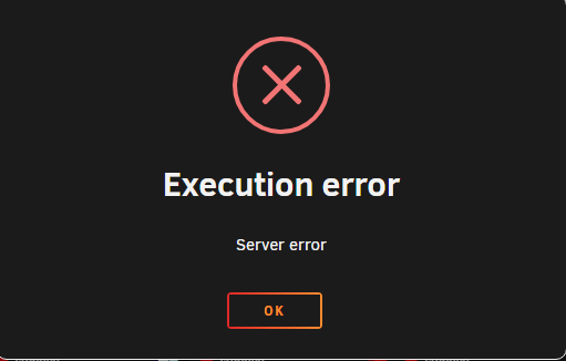

  10. Hi i am trying to run the 7days to die docker i install it attempt to run it but it just gives these logs Have tried restarting unraid have tried deleting and reinstalling the dock tried restarting unraid again but still giving the same errors
