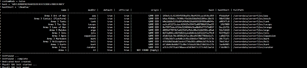

  17. Much love! That all works now Is there any statements about what requirements it takes for a arma 3 server to run? Its mainly just guna be me and 4 friends, but i just was wondering what reqs this game would have for hosting a server I have a i5 10600k and 32GB of ram
  18. Ok will give that a go, im on that version as well =============== 2:20:04 modsReadOnly = true 2:20:04 safeModsActivated = false 2:20:04 customMods = false 2:20:04 hash = '60553D404402468A1D2B383E1CDDE67BBD3FA0E9' 2:20:04 hashShort = 'c8ea65ac' 2:20:04 name | modDir | default | official | origin | hash | hashShort | fullPath 2:20:04 ---------------------------------------------------------------------------------------------------------------------------------------------------------------------------------------------------------- 2:20:04 Arma 3 Art of War | aow | true | true | GAME DIR | 149e4c4c41345f559ba55c9bdf193cacb53bc859 | f5dda9af | /serverdata/serverfiles/aow 2:20:04 Arma 3 Contact (Platform) | enoch | true | true | GAME DIR | b4acf58bbcc74306cf3e16d18dd9d1104ec18e31 | 98b4320d | /serverdata/serverfiles/enoch 2:20:04 Arma 3 Tanks | tank | true | true | GAME DIR | b0e1db8e52f6d8fd49b0d26dd66928f09ba0b94e | a003f7c0 | /serverdata/serverfiles/tank 2:20:04 Arma 3 Tac-Ops | tacops | true | true | GAME DIR | ea3cdf2272cdac419425e594f1a08780df19ae55 | 1fb7009 | /serverdata/serverfiles/tacops 2:20:04 Arma 3 Laws of War | orange | true | true | GAME DIR | 8ef9975ebc6f24e5194944d3ba0b0fd773f5d03f | 9ec21f31 | /serverdata/serverfiles/orange 2:20:04 Arma 3 Malden | argo | true | true | GAME DIR | 4099df70f3b7a41354fa7b1c08a312b6501cd9a4 | 56e7d619 | /serverdata/serverfiles/argo 2:20:04 Arma 3 Jets | jets | true | true | GAME DIR | 8d72a046ce82fb8211a2a6b8cbe143222f1a79c0 | 923f8a63 | /serverdata/serverfiles/jets 2:20:04 Arma 3 Apex | expansion | true | true | GAME DIR | d5db51dc74c18501267ac28ea9150b7781bd2a7c | ca0d2721 | /serverdata/serverfiles/expansion 2:20:04 Arma 3 Marksmen | mark | true | true | GAME DIR | c550a36b7cae4d8c2c91e26b66ef7083dffc5f3b | 20c71afc | /serverdata/serverfiles/mark 2:20:04 Arma 3 Helicopters | heli | true | true | GAME DIR | 4fb168d3dadb3aedc6754a182ca89de2d37b3b3b | 7bb134af | /serverdata/serverfiles/heli 2:20:04 Arma 3 Karts | kart | true | true | GAME DIR | df3db4c8eb8d771c8bc5f6da2658e27db116c27b | 3ae8d985 | /serverdata/serverfiles/kart 2:20:04 Arma 3 Zeus | curator | true | true | GAME DIR | a763c29776a6f98aeecd3d3b4f7c277c4d13ae5d | f3dc8b55 | /serverdata/serverfiles/curator 2:20:04 Arma 3 | A3 | true | true | NOT FOUND (Empty) | | | 2:20:04 ========================================================================================================================================================================================================== 2:20:04 InitSound ... 2:20:04 InitSound - complete 2:20:04 Dedicated host created. 2:20:04 PhysX3 SDK Init started ... 2:20:04 PhysX3 SDK Init ended. 2:20:07 Warning Message: You cannot play/edit this mission; it is dependent on downloadable content that has been deleted.\na3_characters_f 2:20:07 Loading movesType CfgGesturesMale 2:20:07 MovesType CfgGesturesMale load time 54.0 ms 2:20:07 Loading movesType CfgMovesMaleSdr 2:20:11 Warning: looped for animation: a3\anims_f_epa\data\anim\sdr\cts\hubcleaned\briefing\hubbriefing_loop.rtm differs (looped now 0)! MoveName: hubbriefing_ext 2:20:13 Warning: looped for animation: a3\anims_f_epa\data\anim\sdr\cts\hubcleaned\spectator\hubspectator_stand.rtm differs (looped now 1)! MoveName: hubspectator_stand_contact 2:20:13 MovesType CfgMovesMaleSdr load time 5827.0 ms 2:20:13 BattlEye server updated to version: 217 2:20:13 BattlEye Server: Initialized (v1.217) CAppInfoCacheReadFromDiskThread took 4 milliseconds to initialize Setting breakpad minidump AppID = 107410 2:20:13 Initializing Steam server - Game Port: 2302, Steam Query Port: 2303 2:20:13 Game Port: 2302, Steam Query Port: 2303 Arma 3 Console version 2.08.149102 x86 : port 2302 2:20:13 Host identity created. 2:20:13 Connected to Steam server This is the response now, theres no crashing of the logs so i can finally read it, is it okay in that table of hashs that Arma 3 cannot be found?
  19. I'm having issues with installing Arma 3 on a docker container to host a server, I've added my username and password, opened the ports in the config on my router, this appears to be the last section in the log from what I can see before the logs window closes itself, i think at least anyway, i can try and grab more of the logs before it crashes if needs. Im not sure what to do so could anyone give me some advise? I also have a video recording of the logs as it runs before it crashes 15:49:57 InitSound ... 15:49:57 InitSound - complete 15:49:57 PhysX3 SDK Init started ... 15:49:57 PhysX3 SDK Init ended. 15:49:59 Warning Message: You cannot play/edit this mission; it is dependent on downloadable content that has been deleted.\na3_characters_f 15:49:59 Loading movesType CfgGesturesMale 15:49:59 MovesType CfgGesturesMale load time 53.0 ms 15:49:59 Loading movesType CfgMovesMaleSdr 15:50:03 Warning: looped for animation: a3\anims_f_epa\data\anim\sdr\cts\hubcleaned\briefing\hubbriefing_loop.rtm differs (looped now 0)! MoveName: hubbriefing_ext 15:50:04 Warning: looped for animation: a3\anims_f_epa\data\anim\sdr\cts\hubcleaned\spectator\hubspectator_stand.rtm differs (looped now 1)! MoveName: hubspectator_stand_contact 15:50:04 MovesType CfgMovesMaleSdr load time 4220.0 ms CApplicationManagerPopulateThread took 0 milliseconds to initialize (will have waited on CAppInfoCacheReadFromDiskThread) CAppInfoCacheReadFromDiskThread took 4 milliseconds to initialize RecordSteamInterfaceCreation (PID 68): SteamGameServer012 / GameServer RecordSteamInterfaceCreation (PID 68): SteamUtils009 / Utils Setting breakpad minidump AppID = 107410 15:50:04 Initializing Steam server - Game Port: 2302, Steam Query Port: 2303 RecordSteamInterfaceCreation (PID 68): SteamGameServer012 / GameServer RecordSteamInterfaceCreation (PID 68): SteamUtils009 / Utils RecordSteamInterfaceCreation (PID 68): SteamNetworking005 / Networking RecordSteamInterfaceCreation (PID 68): SteamGameServerStats001 / GameServerStats RecordSteamInterfaceCreation (PID 68): STEAMHTTP_INTERFACE_VERSION002 / HTTP RecordSteamInterfaceCreation (PID 68): STEAMINVENTORY_INTERFACE_V002 / Inventory RecordSteamInterfaceCreation (PID 68): STEAMUGC_INTERFACE_VERSION010 / UGC RecordSteamInterfaceCreation (PID 68): STEAMAPPS_INTERFACE_VERSION008 / Apps /opt/scripts/start-server.sh: line 63: 68 Segmentation fault ./arma3server_x64 ${GAME_PARAMS} 15:49:57 Dedicated host created. 15:50:04 BattlEye Server: Initialized (v1.217) 15:50:04 Game Port: 2302, Steam Query Port: 2303
