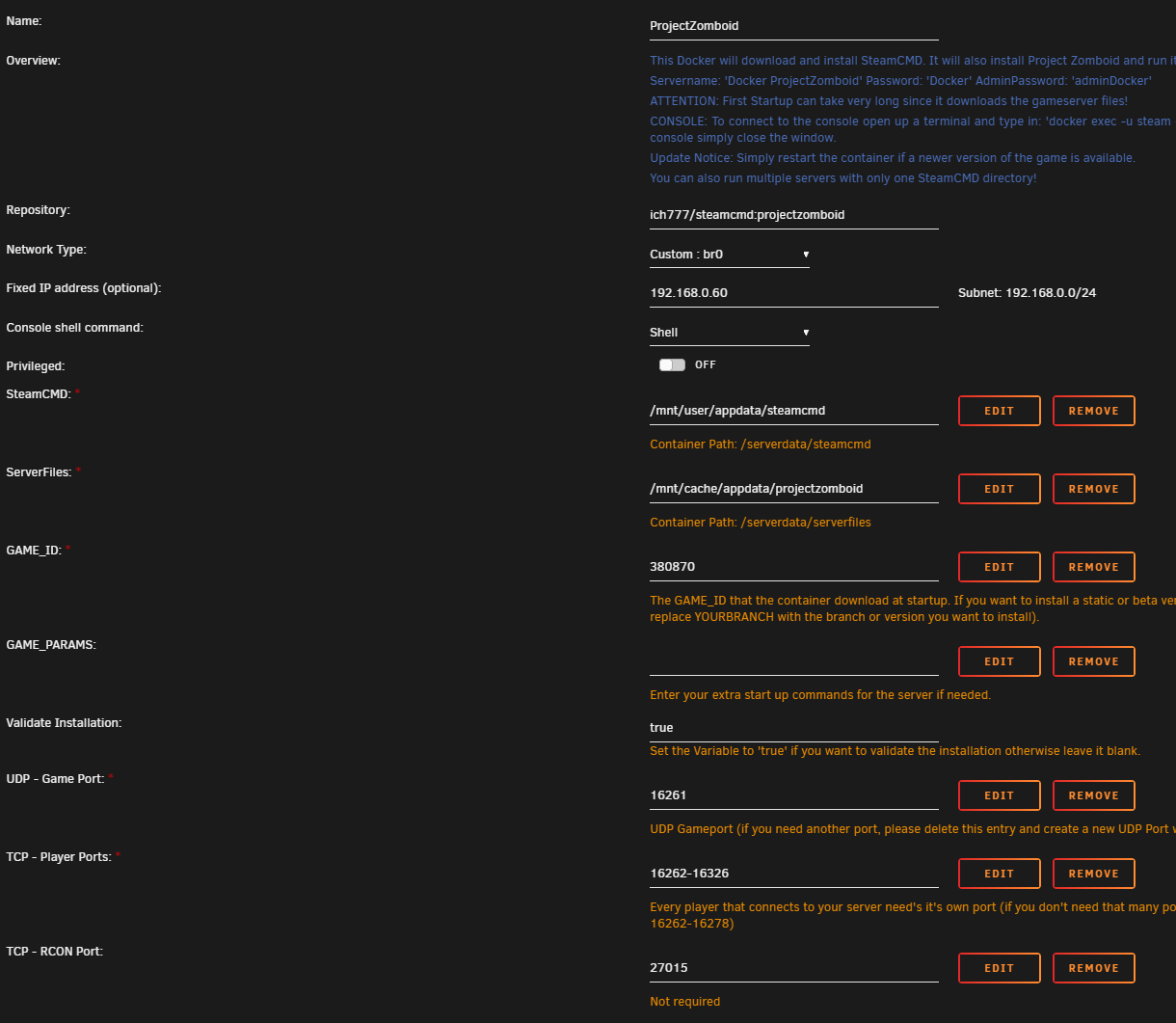

  8. @ich777 Wow that fixed it! All it took was reverted to default installation instructions. Thanks for the support! Out of curiosity, what does the Validate Installation setting refer to?
  9. All appdata is stored on the cache with Preferred settings. Cache is a Kingston M.2 1TB drive with 80% capacity still available. Is the below screenshot what you're looking for? Following this guide for setting recommendations (https://unraid.net/blog/project-zomboid)
  10. Comparing the example you shared, looks like my install is failing part way though. It hangs on the "LOADING ASSETS" step with my whole server CPU bottled necked and almost crashing. Is it possible the CPU is under-powered for the job (4 core / 3.6GHz)
