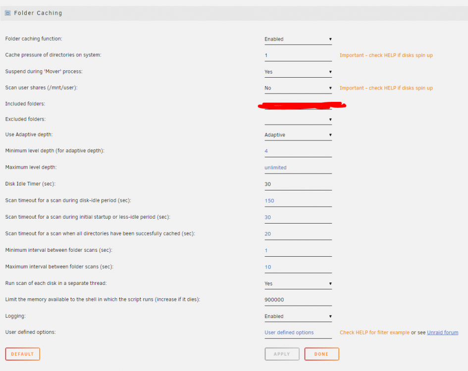

I am running the latest unRAID 6.10.3 with Folder Caching implemented and activated, with cache_pressure of 1 set. I have a few directories/shares that have thousands of files in the top level. Formerly these shares were on a Windows Server box, and SMB browsing of the directories was a bit slow in Windows Explorer, but after indexing, was fine. From the command line after a single file listing (to presumably cache the file structure), access was nearly instant. This is not the case on unRAID. I have batch scripts that require listing the files from the directory nightly, and the slowdown is somewhere between 200-1000x slower despite the Folding Caching plugin, a 10G-SFP connection, local access, and RSS support enabled (along with a client reboot and server samba restart command issued). Checking the Folder Caching logs doesn't seem like it's doing much, just repeating an "Executed find" log message every ten seconds or so despite a client machine requesting a directory listing and hanging for several minutes: I applied these fixes without much change: Any suggestions? Screenshots of my Folder Caching uploaded along with Diagnostics. And heck, while you're here, if you can look into why I can't bind my Mellanox 10G-SFP card to eth0, feel free to have a look at this thread that has been dying a slow death: morra-diagnostics-20220807-1625.zip

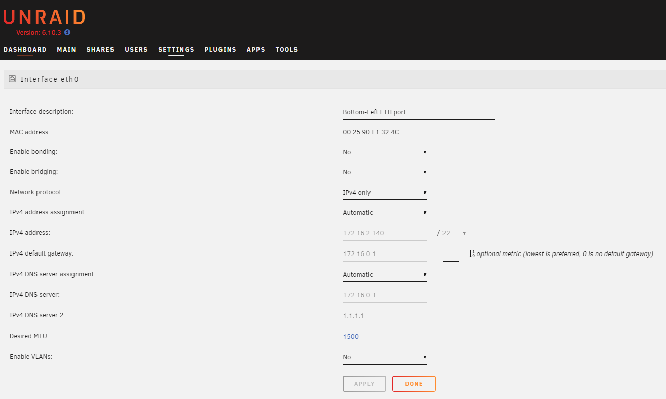

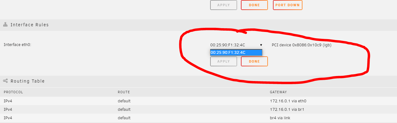

Just in case anyone asks, no, there are no other MAC addresses in the pulldown menu under Interface eth0 in Interface Rules:

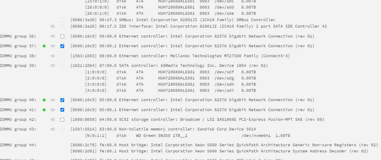

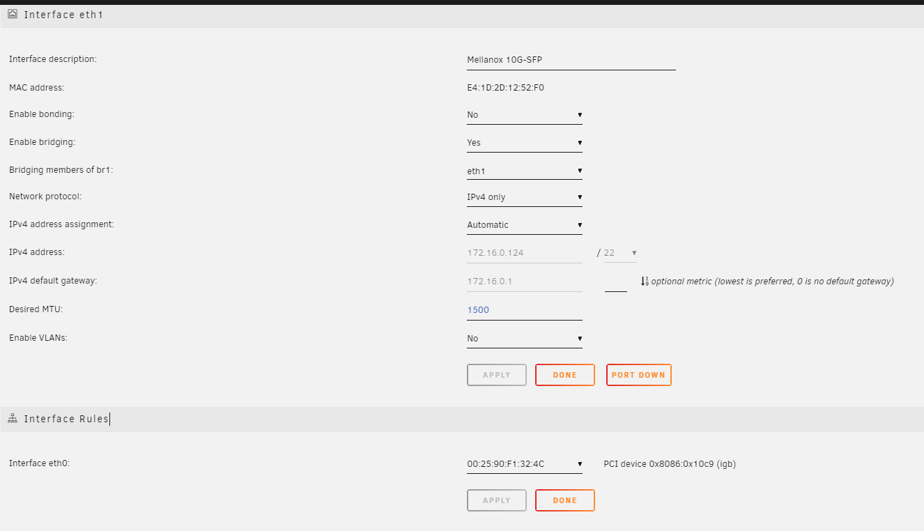

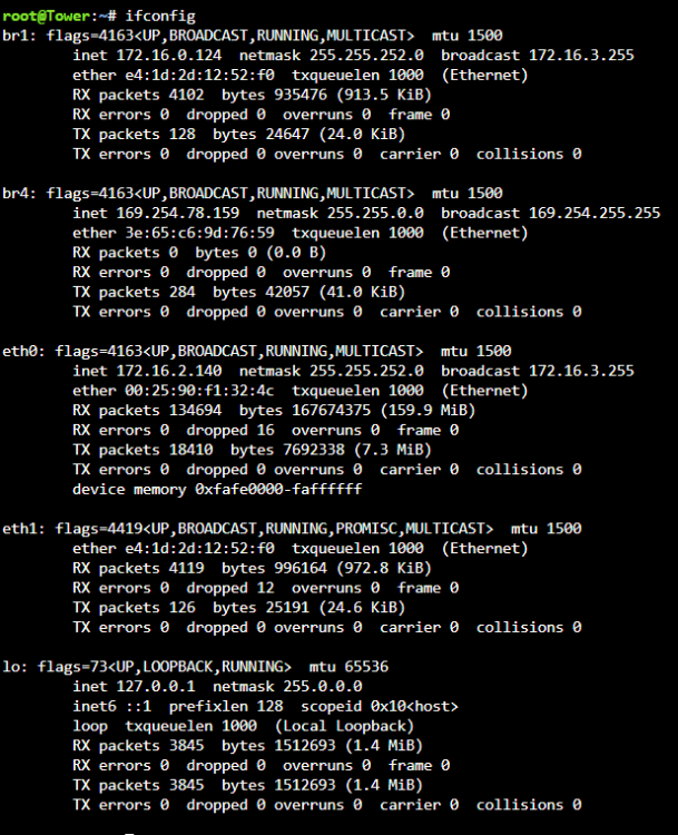

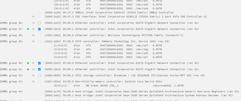

I successfully was able to bind eth2-4 to vfio-pci which removed them from unRAID. However, the Mellanox card still does not show up in the Interface Rules list, as shown by the images attached. I have also attached anonymized Diagnostics. Can someone please look into this or advise me to file a bug ticket? I can try binding the last 1G ethernet port to vfio-pci and rebooting and seeing what happens, but I doubt that would fix the problem. ifconfig on the command line clearly shows eth1 = Mellanox card, and when it isn't bridged to br1, it gets the same IP (static IP set from the router of 172.16.0.124). Thanks for reviewing. This seems like a pretty serious bug. @JorgeB @bonienl tower-diagnostics-20220731-1837.zip

I'm going to try the vfio-pci method next week when I have some downtime I can schedule, but wanted to bump this one more time to see if anyone had any ideas before I do so. Thanks.

I'm not sure I can on this machine - it's a Supermicro X8DT3-LN4F motherboard, and I looked at doing this a few days ago and saw no options to do that. I pulled the motherboard manual from the website and disabling onboard LAN ports is not featured in it. https://www.supermicro.com/manuals/motherboard/5500/MNL-1062.pdf
