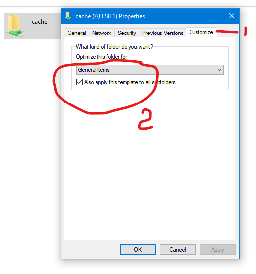

You might also try this setting in Windows Explorer.  It tends to eliminate a lot of overhead compared with  the other selections, Windows does a lot of file reading to compile the data for the other choices.  Begin by opening up the Server in Windows Explorer.  Then right click on the share with the issue.
Edited by Frank1940
Good advice - I do have this set along with other settings on client-side computers to improve the access speed, and it's still 200x+ slower in unRAID.
