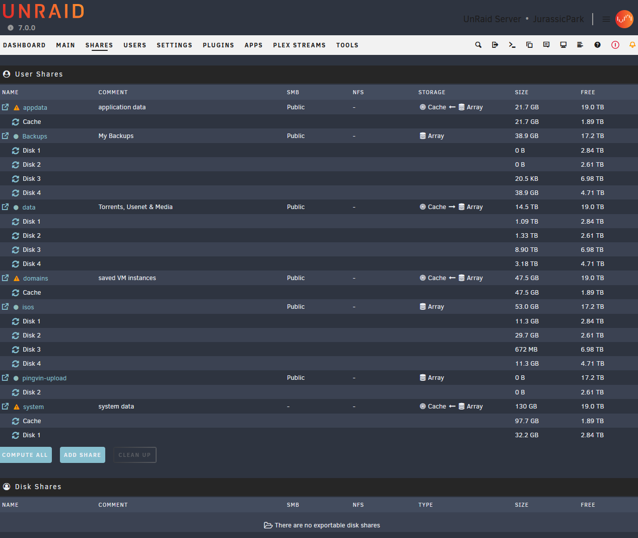

Share SYSTEM set to cache-only, but files / folders exist on the array. Cannot move files from the settings share off Array to Cache.
How can I tell which one is active? I'm assuming the one on the Cache drive is the one I am using but is there any way to double check? Or do I just have to delete the one on Disk 1 (after downloading the file for backup) and hope for the best?
Looks like the only thing in there is a docker.img file. Stopped the docker service and VM service. Ran the mover again with mover logging enabled. The docker.img file refuses to budge. Attached is the updated diagnostics. fossiltower-diagnostics-20251028-1443.zip
How do I get the system share off of disk1? I thought following the steps here (https://forums.unraid.net/topic/120220-fix-common-problems-more-information/?tab=comments#comment-1098683) would take all my system shares off of disk 1 and onto my cache.

How can I fix "Share system set to cache-only, but files / folders exist on the array... You should change the shares settings appropriately or use the dolphin / krusader docker applications to move the offending files accordingly. Note that there are some valid use cases for a set up like this. In particular: THIS More Information"? I followed @Squid 's steps found on his post back in 2022 (https://forums.unraid.net/topic/120220-fix-common-problems-more-information/?tab=comments#comment-1098683). Changed the "Secondary Storage" from "none" to "Array". Set the mover to "Array -> Cache" and then ran the mover. Then realized I forgot to stop my Docker containers and VMs. So I went into my Unraid Settings turned off Docker and VM and then ran the mover again multiple times. Changed the "Secondary Storage" back to "none". Still got the same error. Restarted my server. Still got the same error. Tried all the steps one more time. Still got the same error. Even ran the mover with "Secondary Storage" set to "none" just in case. No change. What am I doing wrong here? I've attached to Diagnostic files to help with debugging. fossiltower-diagnostics-20251028-1229.zip

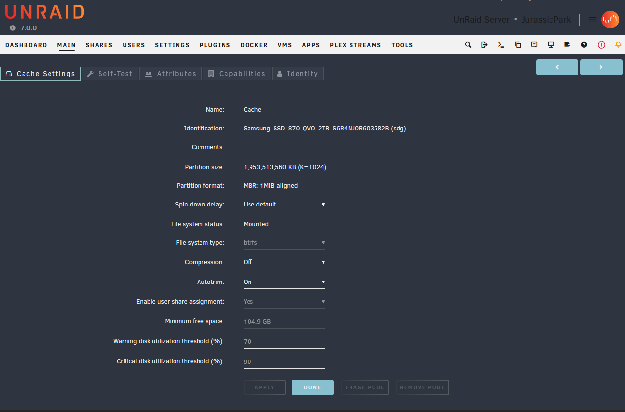

Cache drive suddenly full. Running Mover does not seem to do anything. Need help understanding Diagnostics files to learn how to debug.

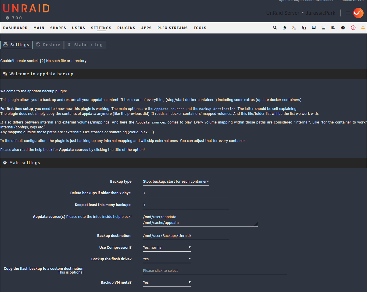

You make a very good point. How do I backup to an off server location? Unrelated to backups. But do you have a recommendation for Mover settings/schedule?
My license key is tied to my Unraid.net account. And this is probably a big no no but I just have everything being backed up to the server itself

You are 100% right. 1.5TB was a bad choice. So I did change it but wanted to play things a bit safe. So I set it to 100G

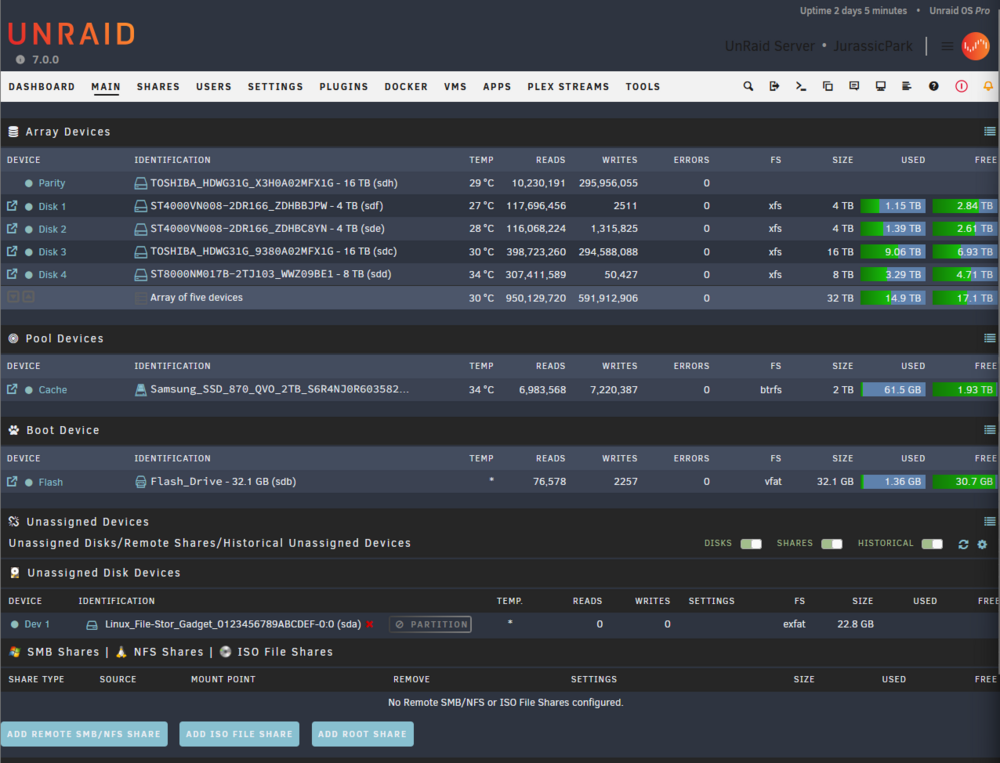

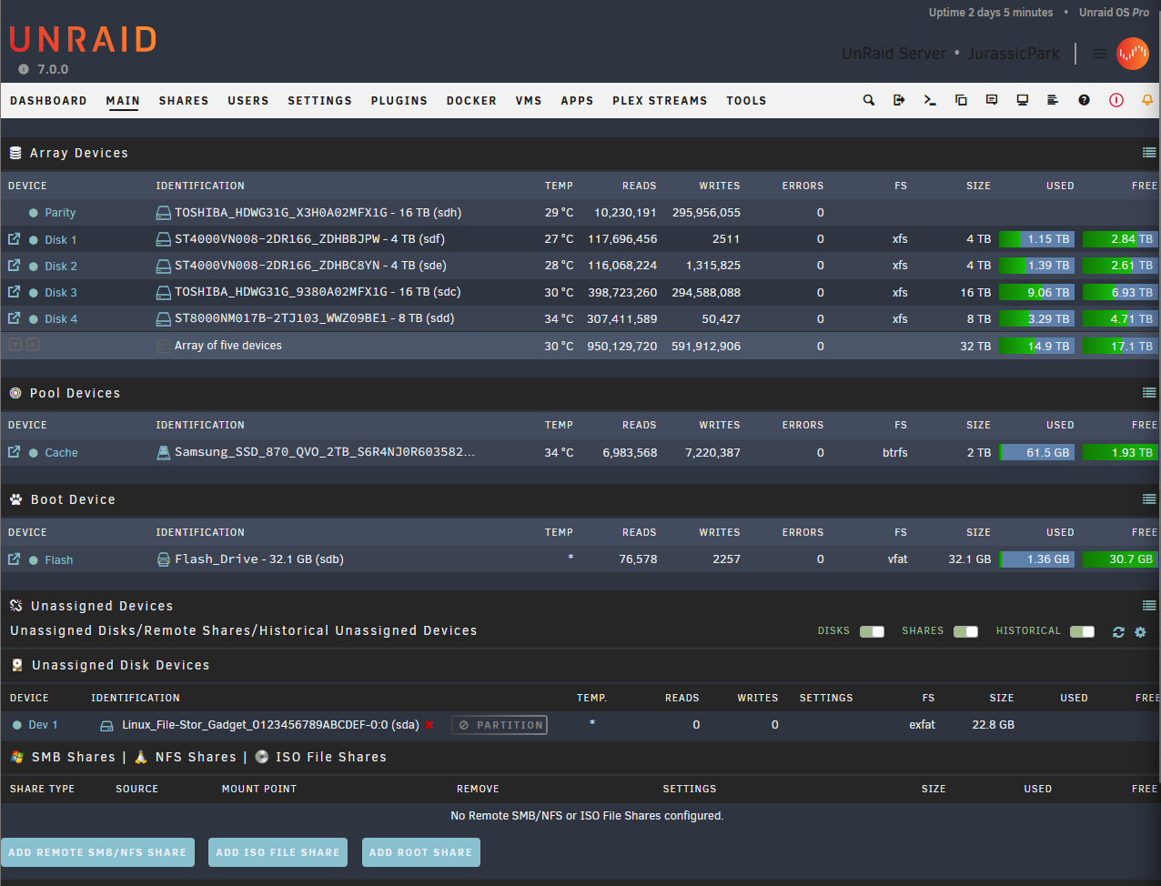

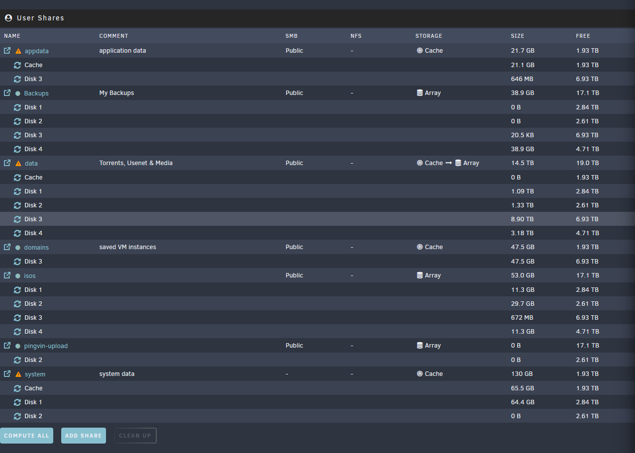

Sorry for my slow response. It has been another busy day and I cannot get to my hobbies as quickly as I like to more often than not. So I have not read your most recent 3 comments. Before I do I wanted to give you a server update. It looks like good news. My server has successfully freed up my entire cache drive (see pic). The bad news. I have no idea why. I have attached a new diagnostics file in case it can provide any insight on what changed since last night. jurassicpark-diagnostics-20250206-0117.zip
