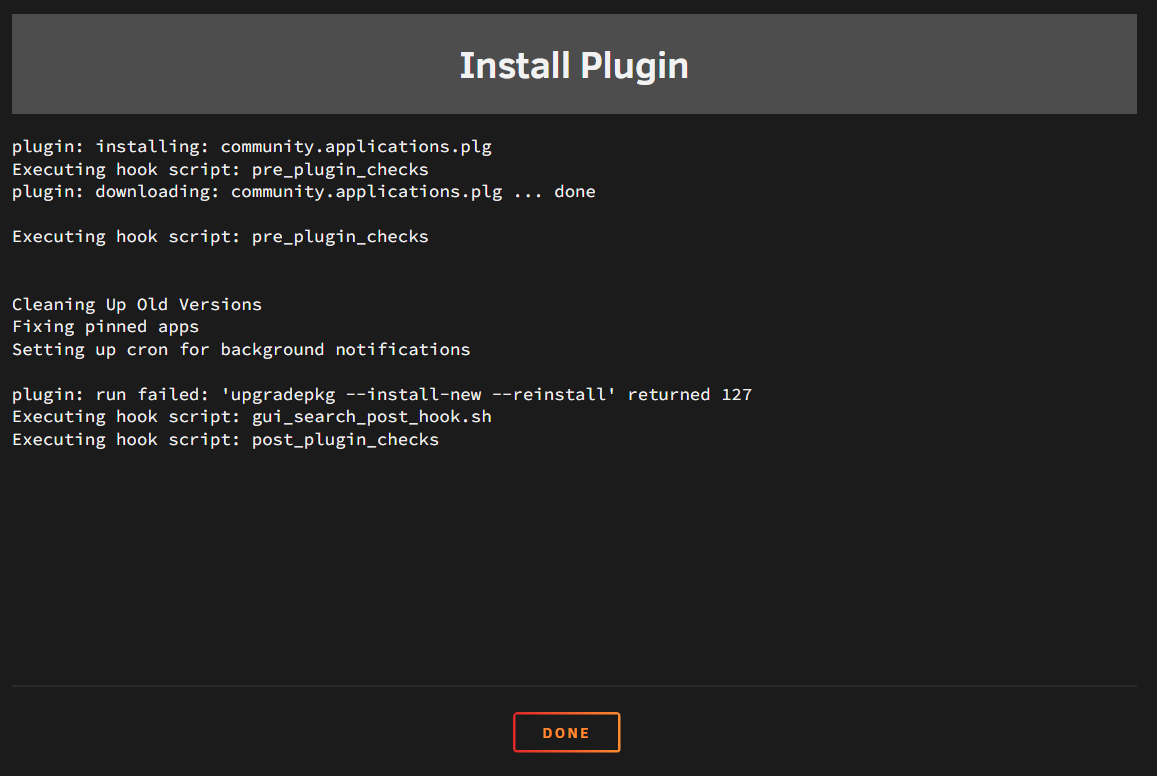

  1. Tried to update CA, now i have no app store and get this error. Running 6.12.13 plex-diagnostics-20250309-2358.zip
  2. How would I go about testing the GPU or what should I do next to try and determine the issue?
