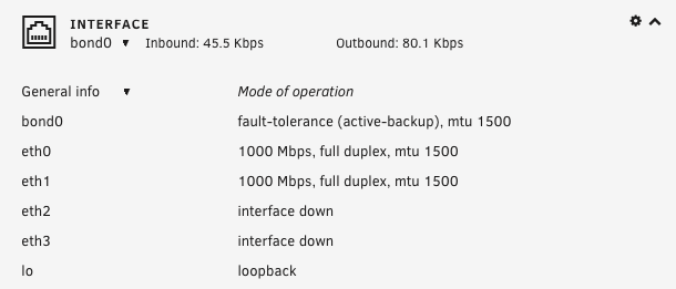

  1. Hello, My motherboard has two gigabit ports, after I configure bond4 and enable 802.3ad dynamic aggregation on the peer end, I find that the access is very slow. Whether it is accessing the management page or the docker service, I don't know if there is a problem with the configuration, as long as the peer end closes the dynamic aggregation, it can be accessed normally again, please help me to take a look. thanks tower-diagnostics-20230309-2336.zip

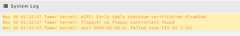

  4. Hello I found the following warnings in the system log, but I can't figure out what is causing the problem? 85:00:0 The device is one of my sata controllers, I don't know what happened to it, what can I do to get rid of this warning? Thanks
  5. Hello I found the following warnings in the system log, but I can't figure out what is causing the problem? 85:00:0 The device is one of my sata controllers, I don't know what happened to it, what can I do to get rid of this warning? Thanks
  6. Yes, this command works, but there are still warnings in the boot log, the warnings are a little different, the card still doesn't work, I give up, I'm going to sell the card, thank you very much for your help

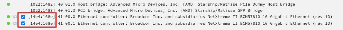

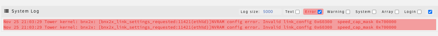

  12. Yes, I have a bcm57810 network card, and I also saw an error about it in the system log, as shown in the picture below, so this problem is because of the compatibility between this card and unriad?

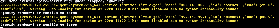

  13. After I pass through the NIC to the virtual machine, there are the following alarms in the virtual machine startup log, what does this mean, how to solve it, or can it be ignored? But I can't dial up to the Internet normally through the network card please help me thanks

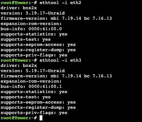

  15. I have upgraded to the latest version of firmware in linux 1. but syslog still has the same error 2. the network interface can be seen on the web UI 3. the ethtool command can also see the correct information What is the reason for the log error, can solve it?
