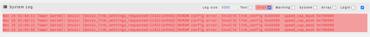

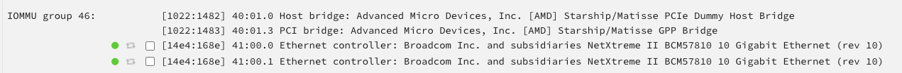

  12. Yes, I have a bcm57810 network card, and I also saw an error about it in the system log, as shown in the picture below, so this problem is because of the compatibility between this card and unriad?

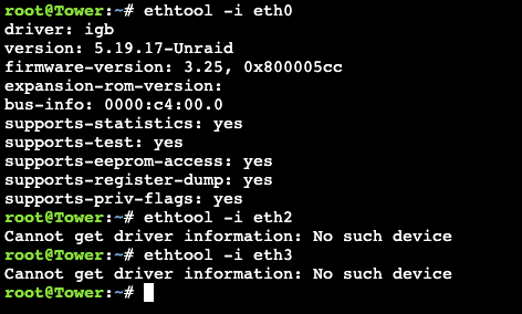

  15. I have upgraded to the latest version of firmware in linux 1. but syslog still has the same error 2. the network interface can be seen on the web UI 3. the ethtool command can also see the correct information What is the reason for the log error, can solve it?

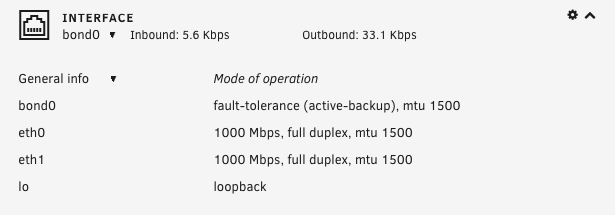

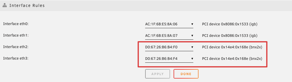

  18. There is an official rpm package, how can I install it?
