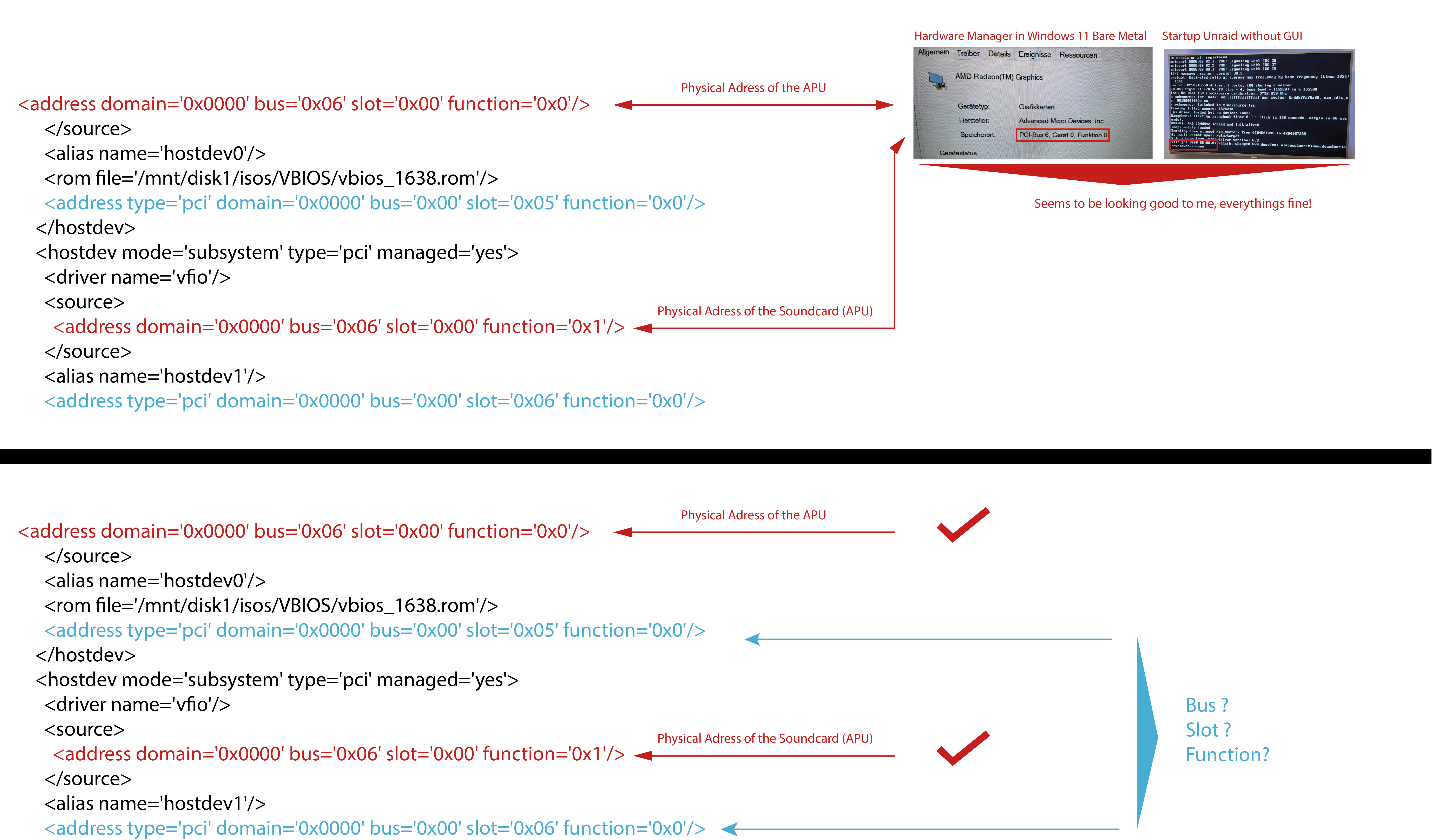

  4. Thank you very much for your help! today i will try this way. I made a small thoughts about the adressing. As you can see, I really try to understand the XML-Startup script. One Question about the alias adress types, can they be assigned as i want? For example I tried differend settings for the Bus and yes it where be assignt in the VM. And also i´ve no idea about the "function=0x0" command. In the end my last hope is that i will work with the SEABIOS installtion. And I forgot to assign a "vendor_id value", Maybe thats the tipping point... Thanks to all! and ofcourse to chaosclarity and Name_0901. You did a good work by explaining everthings 🙂

  6. That sounds very good. So for me, the graphics card seems to be free in any case and I can dedicate myself to the VM settings. Again, I can boot into my Windows VM and connect via RDP. In the hardware overview I can see that the APU is detected. Driver is installed (RADEON) and also the RadeonResetBug is installed. Unfortunately I had already looked at the configuration of the startup script several times and tried to make changes. I don't have deep knowledge for resource addressing. I only know that there is a hardware resource whose values I can't change logically. And then there are addresses to the devices (graphics & Sound-Cards), which are more or less aliases for the VM. These seem to be redirected to the hardware addresses.Right? Here I need a wokshop unfortunately I can't figure out Spaceinvader One's instructions. Okay, I also installed the VM as OVMF. Here are some explanations about that... https://wiki.archlinux.org/title/PCI_passthrough_via_OVMF I think the Windows 10 VM works for you, because you started it as SEABIOS and so without TMP. Windows 11 also requires TMP without Tweak. Maybe you could tell me if you start via the SEABIOS.

  9. I was able to test this weekend once and followed your instructions. And I am first of all happy to be able to say that I am once again a step further. The Radeon graphics was found in the hardware management and I was able to install the AMD driver. However, I still have one main problem, namely error 43. This means apparently, that not cleanly to dei graphics card was passed. I have also entered the syntax according to the instructions, so that Ubnraid really staret headless and also releases the graphics card. Here I found a problem. Unraid starts clean (headless) but I still see a blinking cursor in the post. Is this an indicator that the graphics card is still in use? I had already read that an image or the last image in the framebuffer of the graphics card is still in use. image which is in the framebuffer of the graphics card freezes on the monitor. The boot post ends with me a graphics card output and does not go far, only the flashing corsor unsettles me. I also have a question about the addresses for the devices. You write that soundcard and graphiccard should get the same bus. I would like to understand which syntax is responsible for which things. i always get confused. one time we have the physical device and another time a "virtual address", so this one i can apparently adjust or/and change myself? <hostdev mode='subsystem' type='pci' managed='yes'> <driver name='vfio'/> <source> <address domain='0x0000' bus='0x05' slot='0x00' function='0x0'/> </source> <rom file='/mnt/user/domains/Win10TV/Cezanne.rom'/> <address type='pci' domain='0x0000' bus='0x04' slot='0x00' function='0x0' multifunction='on'/> </hostdev> What does the beginning in the line domain mean? and what does the prefix function mean? <hostdev mode='subsystem' type='pci' managed='yes'> <driver name='vfio'/> <source> <address domain='0x0000' bus='0x05' slot='0x00' function='0x1'/> </source> <address type='pci' domain='0x0000' bus='0x04' slot='0x00' function='0x1'/> </hostdev> Maybe I can post my settings here once and you can help me. Thank you guys! and thanks for any feedback. Alex

  12. Hello dear Unraiders I've been running Unraid on my Asrock 550 mITX with Ryzen 5700g (APU) for a few days. I'm also trying to get the APU to work under a Windows VM and wanted to go through a few things here. This is how I started Unraid Headless and already installed the Windows VM. Unfortunately I hadn't had any success with it pass through the APU. So far I have already dissolved the corresponding iommu groupings and the APU graphic card is individually in it´s own single group (Marked by a green spot). Unfortunately I don't get a picture at the HDMI output after the start with the transfer to the graphics. I also linked the V-Bios beforehand. It's not clear to me why the output isn't on the HDMI switch. Maybe I can post my settings and someone can help me.
