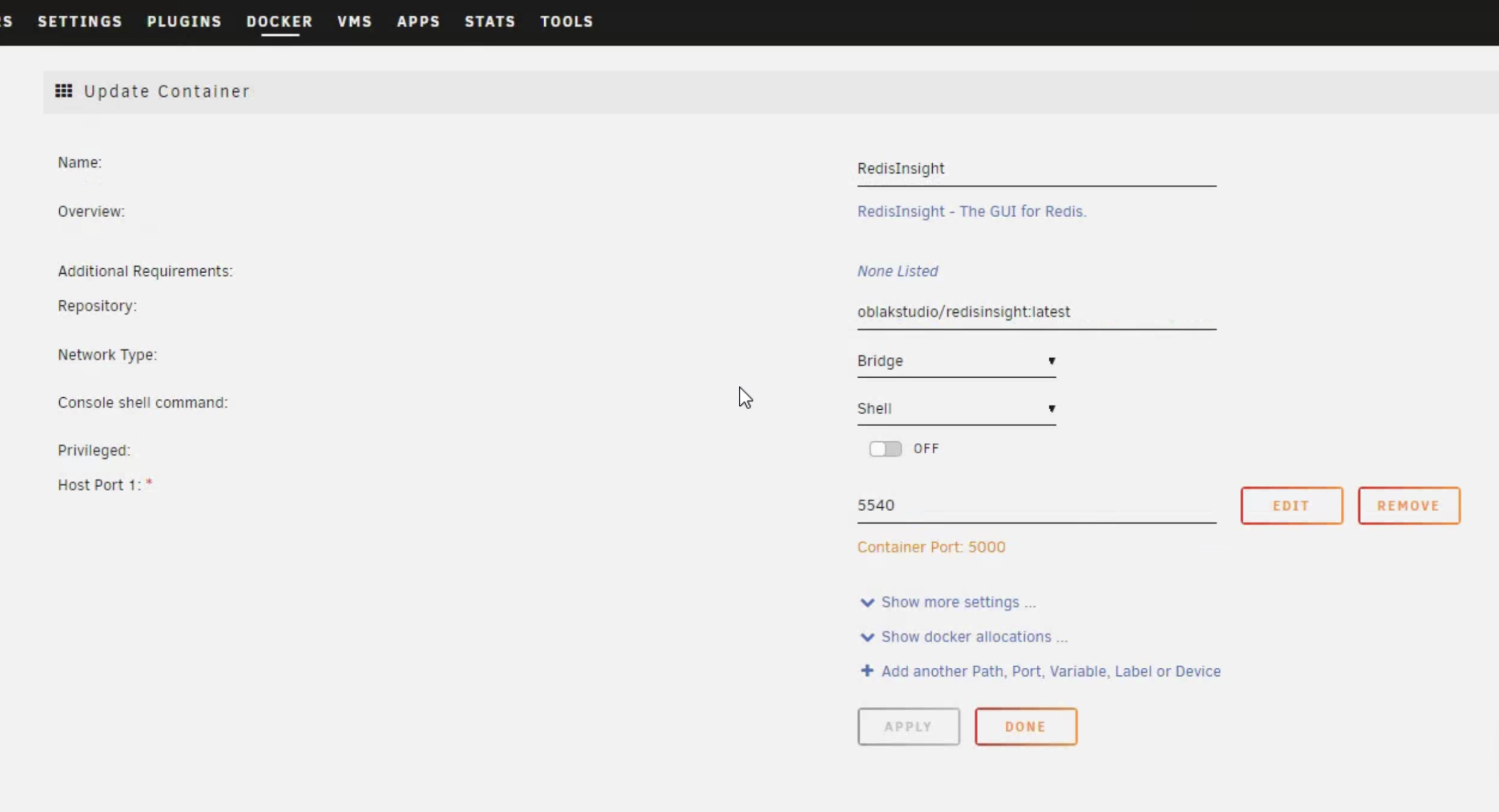

  2. Didn't realize they were different and that worked, thanks! Opening the WebUI still directs it to the dead 5000 port, but typing in 5540 takes it to the working page. Not sure why it's still going to 5000 when that's deleted from the editor, but whatever. Edit: nevermind! Figured out you have to edit it in advanced view, all issues fixed!
  3. Tried both oblakstudio and redis on both ports 5000 and 5540. Only difference between them is that redis actually gives a single log entry while oblakstudio gives no log at all. Ports don't change anything though. Running docker-entry.sh
  4. Tried that version and that port. Still can't reach the page.
