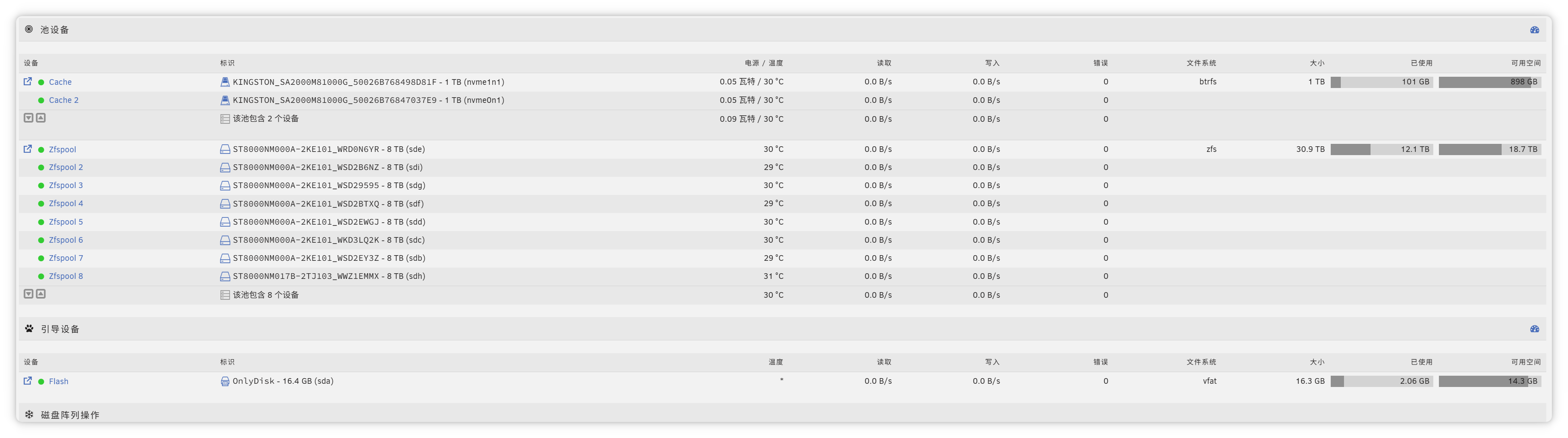

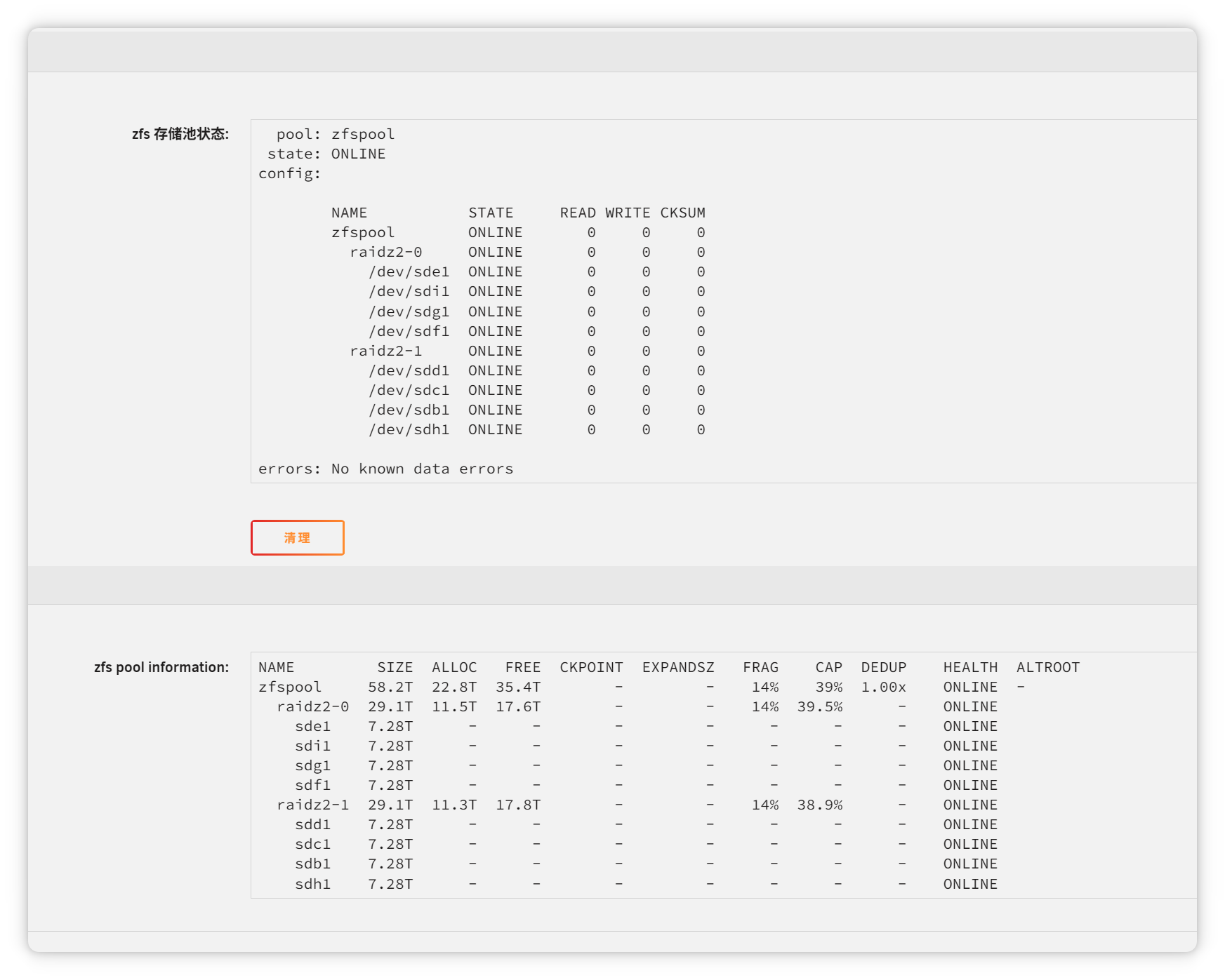

  1. Just to confirm, even with a pool made of two separate 4-drive RAIDZ2 vdevs, there's still no way to remove one of the vdevs? The only solution is to back up all 13TB of data to an external drive, destroy the pool, and rebuild it with 4 drives? I can't add any extra bays or afford new backup drives, so I'm really stuck here. Is there truly no other method? @JorgeB
  2. I have an 8×8TB ZFS RAIDZ2 pool on Unraid, with 32TB total usable space and 13TB used. I'm trying to remove 4 drives from the pool, but when I run zpool remove zfspool raidz2-1, I get the error: cannot remove raidz2-1: invalid config; all top-level vdevs must have the same sector size and not be raidz. What's the correct, safe way to downsize this pool to 4 drives without data loss?

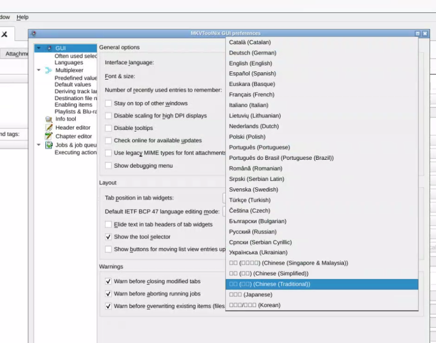

  8. 没人回复吗?我也是一样的问题。
