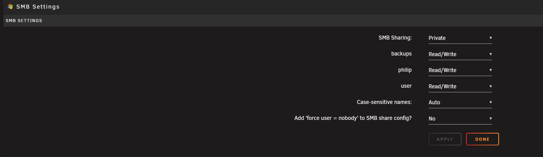

  1. Ive also had this same issue, from what I can remember I had it on version 6.xx, currently on version 7.14. SMB settings here revert to "no access" for each user after a reboot. "private", "auto, and "no" setting do not change after a reboot, only the permissions for each user.
