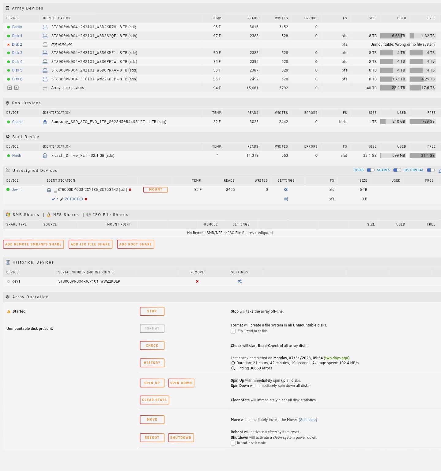

So i that was a dumb idea to format and i shouldnt have but i did start the rebuild and it ran for a couple hours and started showing the same error on the disk. So i replaced the disk with a new larger disk last night. it started the rebuild. Today when i woke up i received notice that the disk failed and was disabled. i now have the same Disk 2ST8000VN004-3CP101_WWZ2NL03 - 8 TB (sde) Unmountable: Wrong or no file system I don't know what to do. I'm thinking I might change the drive port on the motherboard maybe the port has gone bad. I feel I'm grasping at straws at this point.

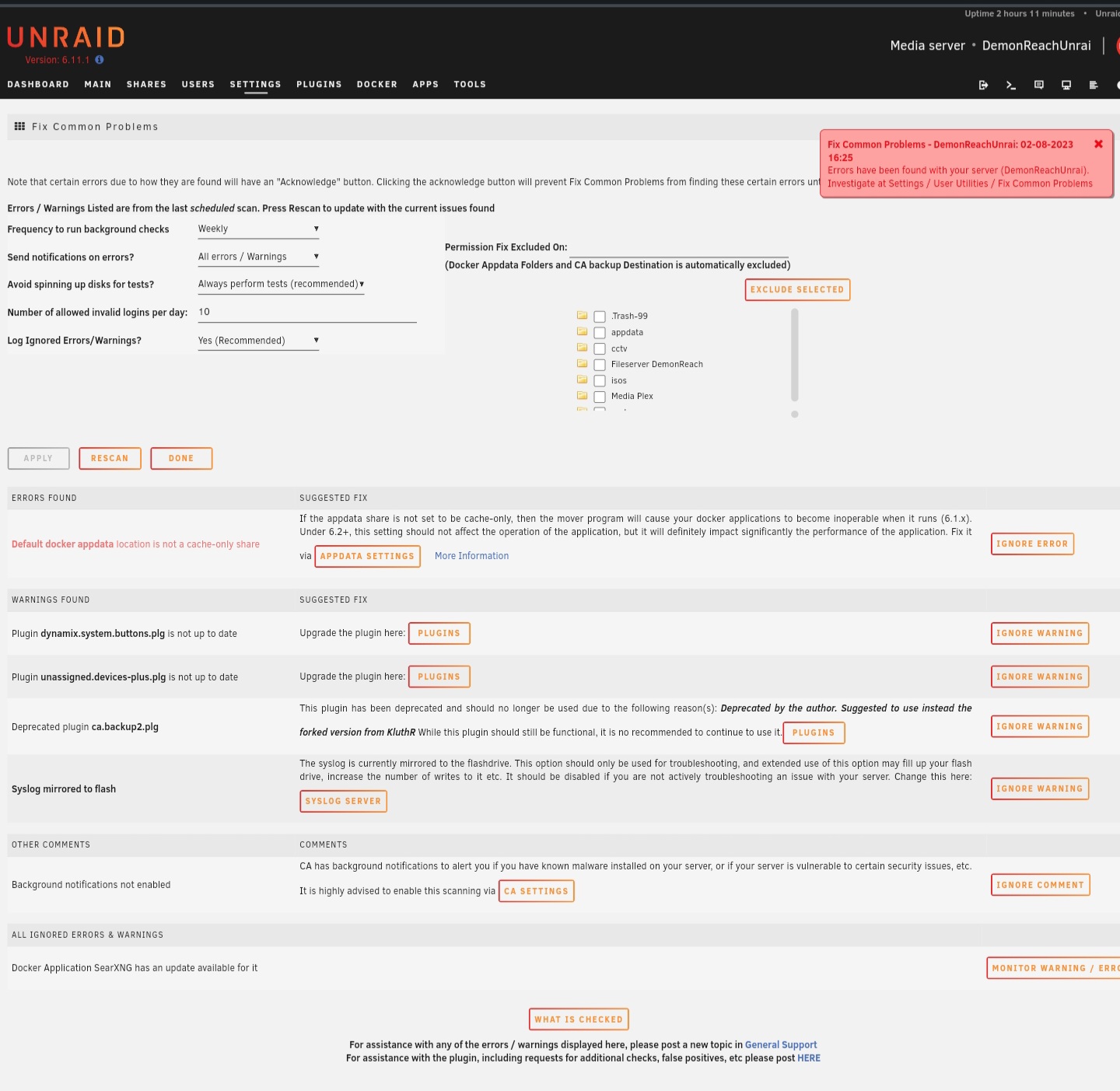

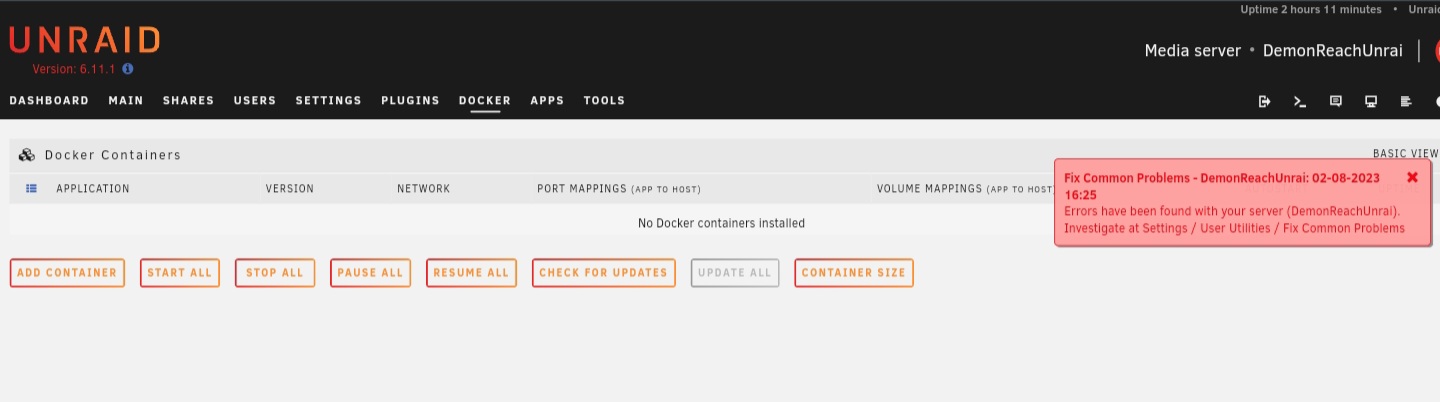

Hello i have had my Unraid running for 2-3 years now and check my drive health quite often and yesterday when i checked it their where ZERO errors and temps where good at 95. Today with out the device crashing or power loss all my docker apps stopped working and i logged in remotely to see what wast up. in the Docker section i have no apps and it stated No Docker Containers Installed. I then checked the main tab and found that Drive 2 stated Unmountable Wrong or no filesystem ( this is a 6 TB drive that had about 4TB on it) i attempted to resolve by restarting the device. I then attempted a repair via starting the array in maintenance mode this failed and did nothing that i could tell. I then removed the drive and tried to re-add the drive which now shows formatted. I was able to get the array started again with out the drive. My issue is what could have caused this and how do i rebuild the drive from the parity. Note- I have a larger drive that i plan swapping for the Parity drive and rotate the 8tb parity drive to replace the 6tb i just haven't done it. it just came in this weekend.demonreachunrai-diagnostics-20230802-1548.zip Attached are what I'm seeing and I am really worried i just lost 2-3 years of setting up programs and tools. Please help. Going crazy here.
