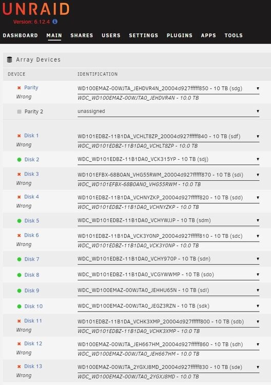

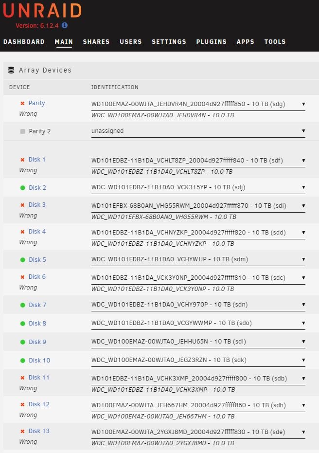

  3. I am moving my 14 disk array on Unraid Pro 6.12.4 to different hardware. I took a picture of my configuration before tearing down the old setup, and after moving my USB stick and booting up the new setup, 6 disks were identified fine with green ball (presumably the ones on the motherboard SATA ports) while the other 8 were showing "missing" initially. I matched each slot with the correct disk from Unassigned Devices, but now each reads "wrong" and I cannot start the array due to "too many wrong and/or missing disks". It does look like the expansion card is assigning a different naming convention, but one can see by the serial numbers that everything matches. What's my next step in this case? Thanks!
