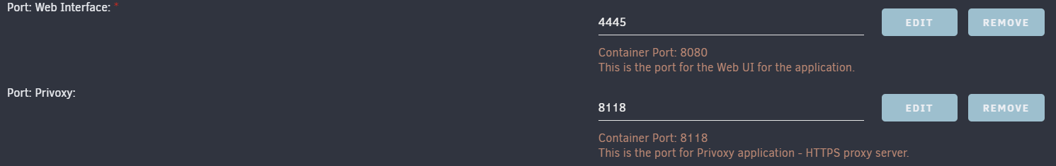

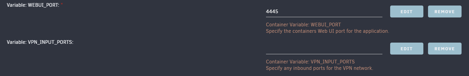

  12. uninstalled the docker and reinstalled it default WEBUI port to 8080. still cant get the webUI docker run -d --name='binhex-qbittorrentvpn' --net='bridge' --pids-limit 2048 --privileged=true -e TZ="Australia/Perth" -e HOST_OS="Unraid" -e HOST_HOSTNAME="TONNYHII" -e HOST_CONTAINERNAME="binhex-qbittorrentvpn" -e 'VPN_ENABLED'='yes' -e 'VPN_USER'='pmp' -e 'VPN_PASS'='' -e 'VPN_PROV'='protonvpn' -e 'VPN_CLIENT'='wireguard' -e 'STRICT_PORT_FORWARD'='yes' -e 'ENABLE_PRIVOXY'='no' -e 'ENABLE_SOCKS'='no' -e 'SOCKS_USER'='admin' -e 'SOCKS_PASS'='socks' -e 'LAN_NETWORK'='192.168.64.0/19' -e 'WEBUI_PORT'='8080' -e 'VPN_INPUT_PORTS'='' -e 'VPN_OUTPUT_PORTS'='' -e 'DEBUG'='false' -e 'VPN_OPTIONS'='' -e 'ENABLE_STARTUP_SCRIPTS'='no' -e 'USERSPACE_WIREGUARD'='no' -e 'NAME_SERVERS'='84.200.69.80,37.235.1.174,1.1.1.1,37.235.1.177,84.200.70.40,1.0.0.1' -e 'PUID'='99' -e 'PGID'='100' -e 'UMASK'='000' -l net.unraid.docker.managed=dockerman -l net.unraid.docker.webui='http://[IP]:[PORT:8080]' -l net.unraid.docker.icon='https://raw.githubusercontent.com/binhex/docker-templates/master/binhex/images/qbittorrent-icon.png' -p '8080:8080/tcp' -p '8118:8118/tcp' -p '9118:9118/tcp' -p '58946:58946/tcp' -p '58946:58946/udp' -v '/mnt/user/appdata/binhex-qbittorrentvpn':'/config':'rw' -v '/mnt/user/appdata/binhex-qbittorrentvpn/qBittorrent/':'/data':'rw' -v 'binhex-shared':'/shared':'rw' --sysctl="net.ipv4.conf.all.src_valid_mark=1" 'binhex/arch-qbittorrentvpn' b1242bfb440ccae9b238a3ea717618162ae8b0c9f67752d7f47b4ce514bfd1c5 The command finished successfully!
  13. i only changed port 8080 to 4445 in settings below, which one is wrong?

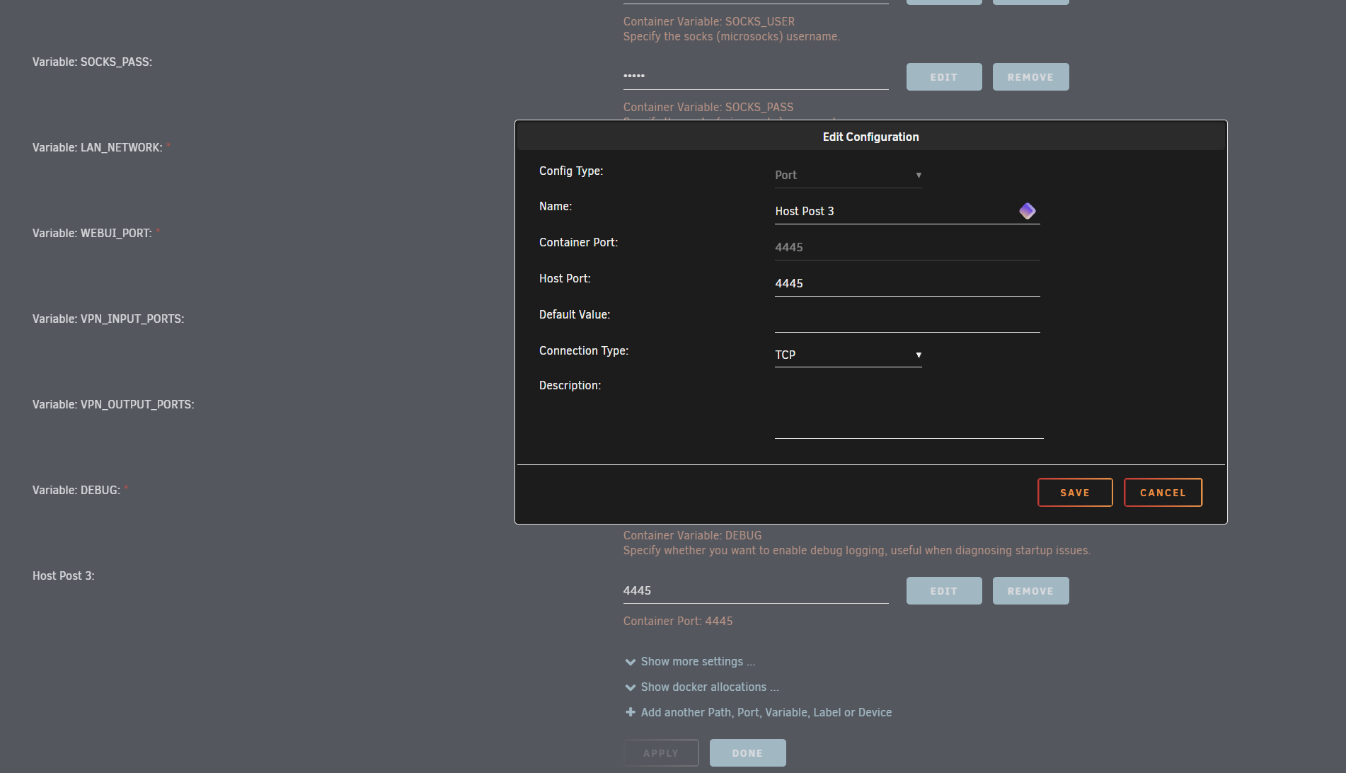

  14. docker run -d --name='binhex-qbittorrentvpn' --net='bridge' --pids-limit 2048 --privileged=true -e TZ="Australia/Perth" -e HOST_OS="Unraid" -e HOST_HOSTNAME="TONNYHII" -e HOST_CONTAINERNAME="binhex-qbittorrentvpn" -e 'VPN_ENABLED'='yes' -e 'VPN_USER'='' -e 'VPN_PASS'='' -e 'VPN_PROV'='protonvpn' -e 'VPN_CLIENT'='wireguard' -e 'STRICT_PORT_FORWARD'='yes' -e 'ENABLE_PRIVOXY'='no' -e 'ENABLE_SOCKS'='no' -e 'SOCKS_USER'='admin' -e 'SOCKS_PASS'='socks' -e 'LAN_NETWORK'='192.168.64.0/19' -e 'WEBUI_PORT'='4445' -e 'VPN_INPUT_PORTS'='' -e 'VPN_OUTPUT_PORTS'='' -e 'DEBUG'='false' -e 'VPN_OPTIONS'='' -e 'ENABLE_STARTUP_SCRIPTS'='no' -e 'USERSPACE_WIREGUARD'='no' -e 'NAME_SERVERS'='84.200.69.80,37.235.1.174,1.1.1.1,37.235.1.177,84.200.70.40,1.0.0.1' -e 'PUID'='99' -e 'PGID'='100' -e 'UMASK'='000' -l net.unraid.docker.managed=dockerman -l net.unraid.docker.webui='http://[IP]:[PORT:4445]' -l net.unraid.docker.icon='https://raw.githubusercontent.com/binhex/docker-templates/master/binhex/images/qbittorrent-icon.png' -p '4445:8080/tcp' -p '8118:8118/tcp' -p '9118:9118/tcp' -p '4445:4445/tcp' -p '58946:58946/tcp' -p '58946:58946/udp' -v '/mnt/user/appdata/binhex-qbittorrentvpn':'/config':'rw' -v '/mnt/user/appdata/binhex-qbittorrentvpn/':'/data':'rw' -v 'binhex-shared':'/shared':'rw' --sysctl="net.ipv4.conf.all.src_valid_mark=1" 'binhex/arch-qbittorrentvpn' 896538015c77c090821ca08e34900be48a1c30bc4fa978554e2ed484c069a976 docker: Error response from daemon: driver failed programming external connectivity on endpoint binhex-qbittorrentvpn (21c37545d78e489eea1f9fdb04d4fca9eaf977179eec1f9c4803727da518b1f8): Bind for 0.0.0.0:4445 failed: port is already allocated. The command failed.
