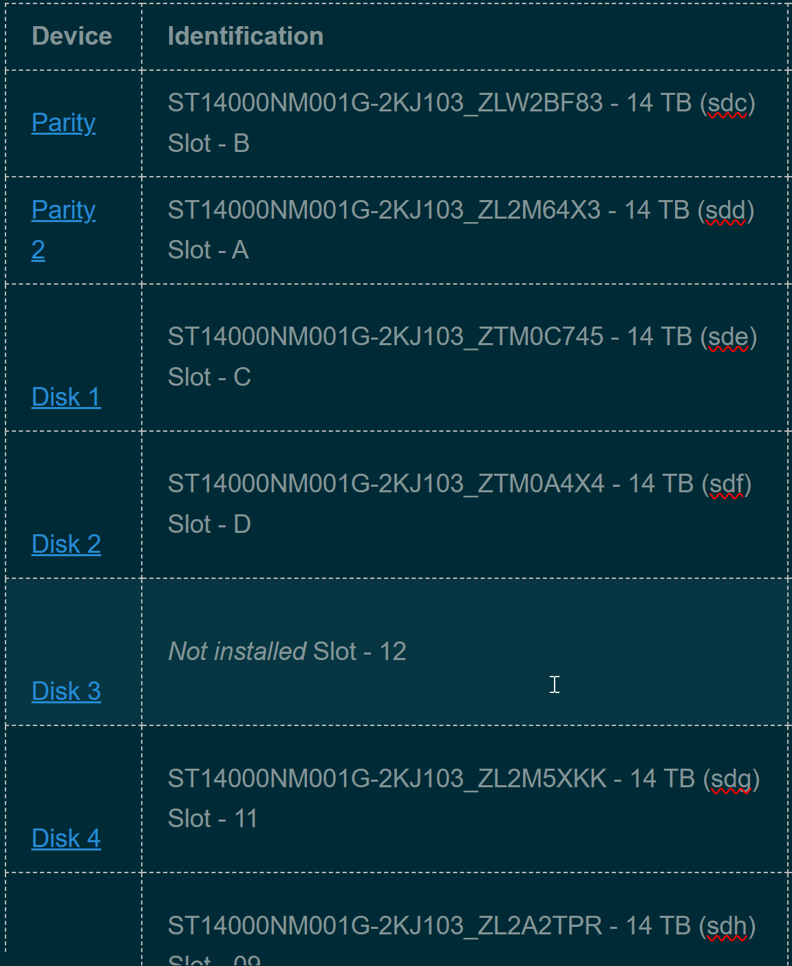

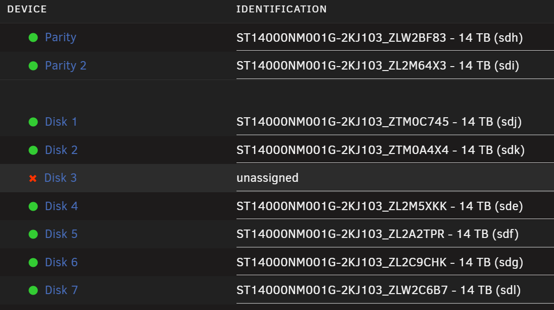

No changes. Still shows the same disk missing. All S/Ns are still the same in the disk and parity locations. There are some differences that I found from when I started this and that would be that the linux drive assignments have changed. Example: Parity 1 was labeled as (sdc) but is now labeled as (sdh) and so on. The S/Ns all stayed in the same number slot (disk 1, disk 2, etc.)

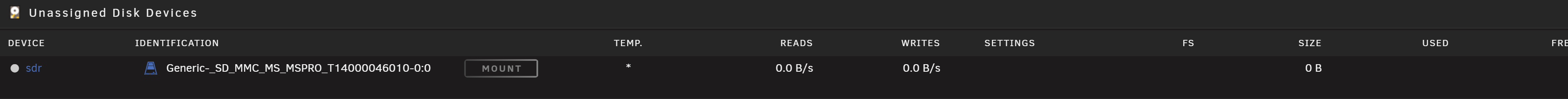

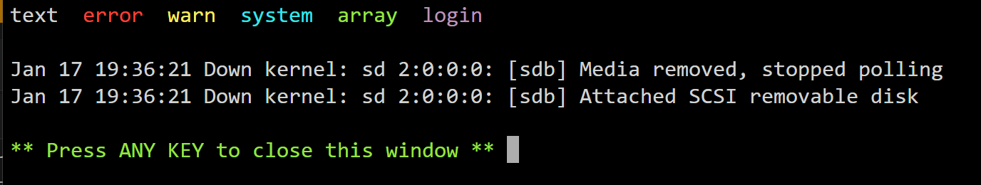

Hello All, Let me start by saying thank you in advance. I have read a lot of posts on these forums looking for answers and appreciate everyone's contributions. So again thank you to the community. In reference to my issue, I have seen similar issues and tried to solve accordingly but to no avail. I will elaborate to all things I remember doing (*unfortunately I have not documented the steps taken like I always intend to do). I am currently on unraid 7.1.4 I had my disk 3 fail. I have tried: Restart. No Luck. I physically replaced the bad drive with a fresh equal size drive. No drive showed up below as unnasigned and allowed me to assign the drive to the array. I tried rearranging the cables from my HBA to make sure the cable was not bad. I then replaced the cable from the HBA and still got same results. I updated the BIOS and Firmware on the HBA through the CLI in the GUI of unraid. I am not able to get into the BIOS of the card during boot up by hitting CTRL+C. I attempted multiple "solutions" from GROK and ChatGPT to return that option to no avail. Updated the motherboard BIOS. No luck Added app Unassigned Devices and the replacement drive now shows but I am unable to do anything with it. I have an extra HBA but am worried about if I switch it out will it destroy my array and I lose my data (* I have it backed up but would prefer not having to rebuild) I wondered if running New Config would possibly help but have the same worry of losing my data. I have uploaded my Diags as well as some screenshots. I hope this is helpful. Please let me know what else you would be looking for to help me get this issue resolved. I also included a screenshot of my shares and would take an criticism of the setup and recommended changes. Hardware is: Asus Pro-Art Z690 Creator Motherboard Intel Core i9-12900K Desktop Processor 16 (8P+8E) Cores up to 5.2 GHz Unlocked LGA1700 600 Series Chipset 125W 4x CORSAIR Vengeance DDR5 32GB (2x16GB) DDR5 5600 (PC5-44800) C36 1.25V - Black LSI 9305-24i x8 lane, PCIe 3.0 Full Height SAS SAS 9305 12 Gb/s SAS Host Bus Adapter 2-14TB Parity drives 14-14TB Array drives utilizing XFS 3-NVME & 1-M.2 2TB drives for Cache Pool using ZFS Corsair HX Series, HX1200, 1200 Watt, Fully Modular Power Supply, 80+ Platinum Nvidia RTX 3060Ti Video Card diags.zip
