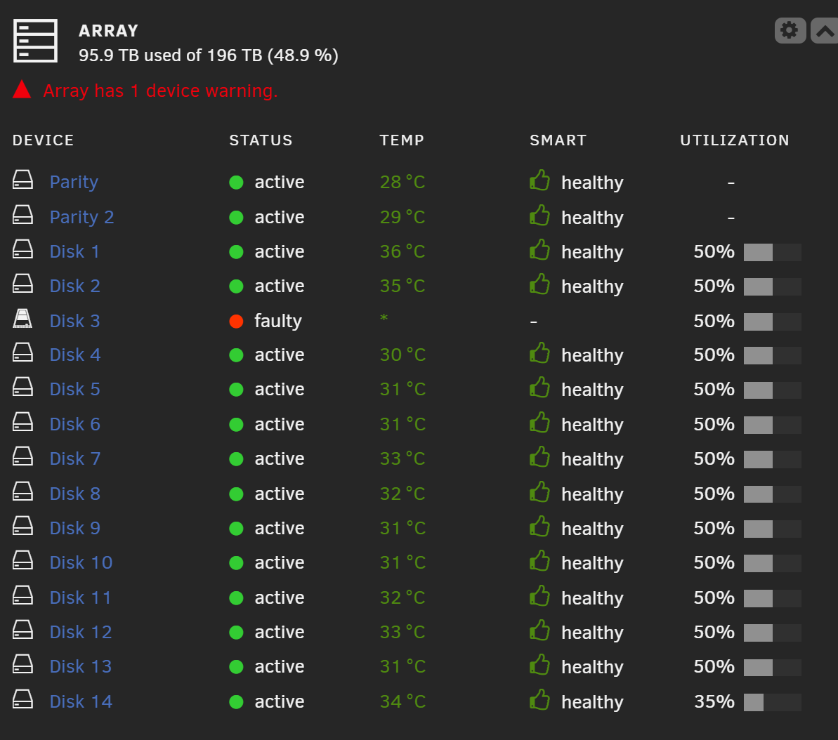

I had my disk 3 fail.

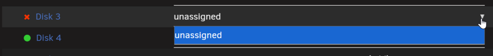

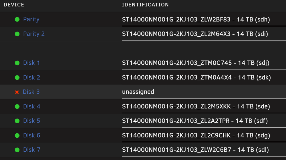

  • I physically replaced the bad drive with a fresh equal size drive. No drive showed up below as unnasigned and allowed me to assign the drive to the array.
  • I tried rearranging the cables from my HBA to make sure the cable was not bad. I then replaced the cable from the HBA and still got same results.
  • I updated the BIOS and Firmware on the HBA through the CLI in the GUI of unraid. I am not able to get into the BIOS of the card during boot up by hitting CTRL+C. I attempted multiple "solutions" from GROK and ChatGPT to return that option to no avail.
  • Updated the motherboard BIOS. No luck

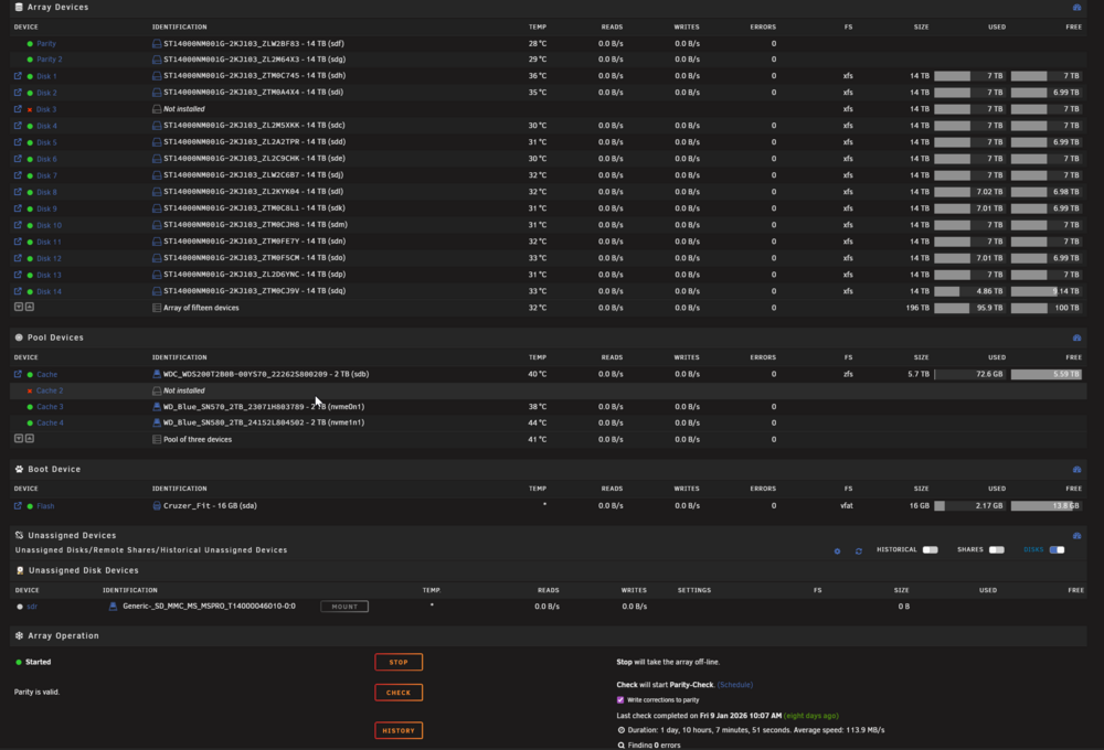

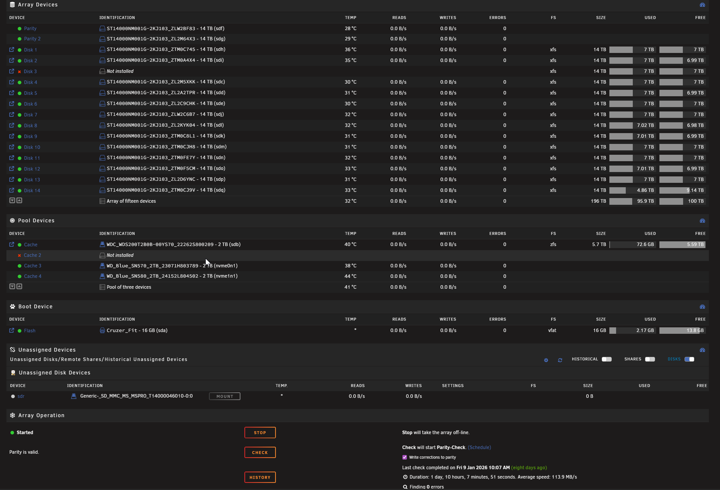

  • Added app Unassigned Devices and the replacement drive now shows but I am unable to do anything with it.image.png
I have an extra HBA but am worried about if I switch it out will it destroy my array and I lose my data (* I have it backed up but would prefer not having to rebuild)
I wondered if running New Config would possibly help but have the same worry of losing my data.
I have uploaded my Diags as well as some screenshots. I hope this is helpful. Please let me know what else you would be looking for to help me get this issue resolved.

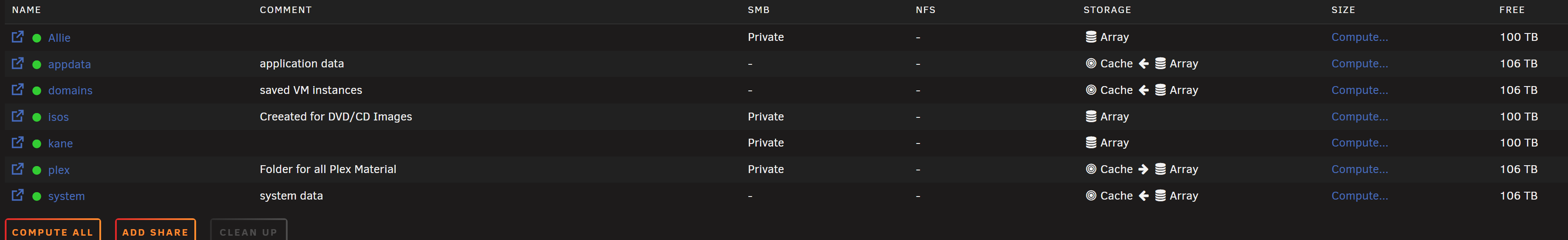

I also included a screenshot of my shares and would take an criticism of the setup and recommended changes.

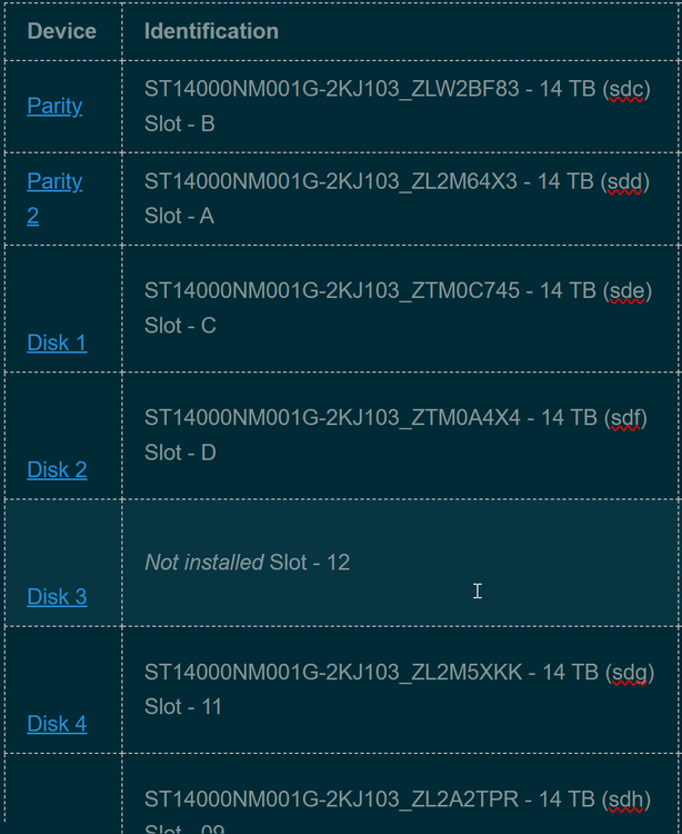

No changes. Still shows the same disk missing. All S/Ns are still the same in the disk and parity locations. There are some differences that I found from when I started this and that would be that the linux drive assignments have changed. Example: Parity 1 was labeled as (sdc) but is now labeled as (sdh) and so on. The S/Ns all stayed in the same number slot (disk 1, disk 2, etc.)
This is normal. Can happen when disks are added, removed, or disconnected, or just on reboot. That is why we usually don't talk about sdX except in very specific situations. Unraid identifies disks by Serial #
