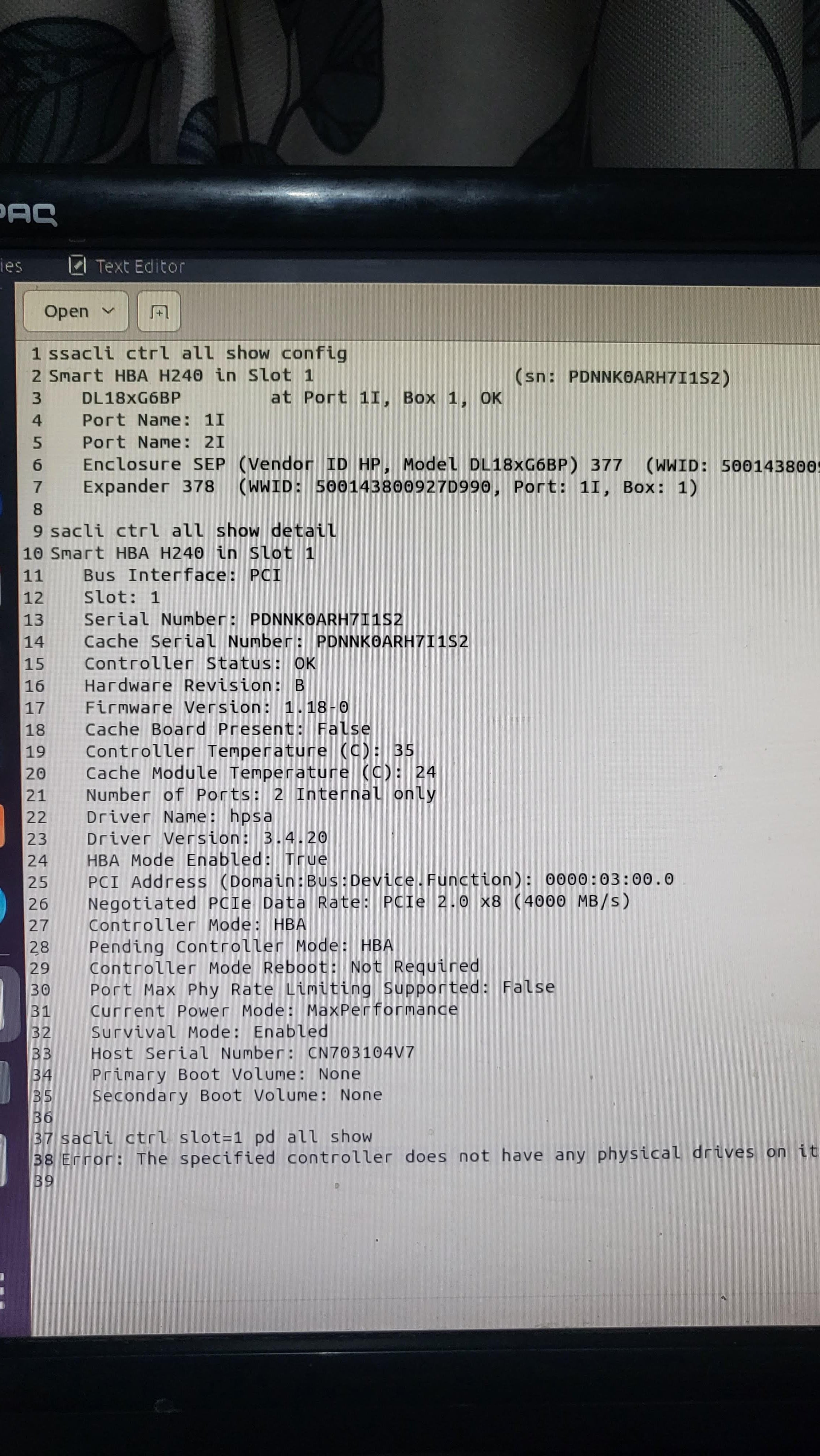

  6. Ok can confirm with a breakout cable that drives are detected by the card in a linux live CD So its not the card, its either the backplane or the cable linking to the backplane.
  7. Reading online the point of this card is a HP card which supports proper IT / HBA and passes the drives though Rather then the other HP raid cards which need volume creation Either way, it still should show the phyisical disks on the command output, regardless of what raid or mode is setup on it as you would use that to create the logical drives from within the command if your using raid mode
  8. The H240 is a HBA card, it has raid, but its set to HBA mode Thats why i got it over the p410 I originally got the LSI card but I thought it might have had problems with the HP backplane, which is why I went for HP's HBA card
  9. Hi all. To keep a long story short, I have a HP DL180G6 server which had a P410 raid card The battery on the card died, and since I wanted to move to unraid anyway, I decided to not replace the battery and just get a new card. I originally got a LSI card, but iv had problems with it (have another thread on that one) but after getting stuck I got a HP H240 HBA card Unraid detects the card fine, and detects the servers backplane, but no drives. I booted to ubuntu live and installed the HP CLI tools, and again, it shows the card and backplane, but no drives. I'm currently googling around trying to find a solution or a direction to head, but I figured it might be smart to ask the community as well, as im sure I'm not the only one running into this I have attached the diagnostics from unraid, and a photo of the output from the cli tool (i tried to save it, but being a live cd I forgot it wouldn't save properly) nas01-diagnostics-20221013-2001.zip

  11. Ok so after messing around I can get it to boot and detect the expander (i think it might be a dodgy cable but not sure) however its still not detecting disks I can boot into the LSI Bios and it says Enclosure - HP GL18xG6BP But when I try to select it, nothing happens and booting into unraid, it detects the enclosure as well, but no disks show up as selectable. So back to thinking its the backplane which isnt liked.
  12. Update Got my hands on a breakout sable, and it is detecting the drive just fine on the LSI card Next step to assume is either backplane or cable is broken or the backplane isnt supported. Is there a way to check this firmware without a HP card? I suspect since my LSI card isnt detecting it, I can't use that for testing.
  13. Thats something I didnt think of, do they have firmware? I thought they were just like a complicated breakout cable?
