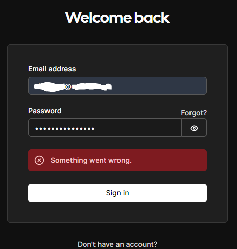

  6. Thanks, yes, the case is that the IDS, the Google API Keys if they work and I can connect Google calendars. But the Giphy API does not work, I thought it was precisely the docker in v3.7.11 and that with the new tag would be resolved. The Giphy API is in normal mode, not in production mode because I understand that it is not necessary, besides complicated to send the requirements that they ask. On the other hand, I still have some notices of NextJS, I hit you, you have any similar? @calcom/web:start: [next-auth][error][JWT_SESSION_ERROR] @calcom/web:start: https://next-auth.js.org/errors#jwt_session_error "exp" claim timestamp check failed { @calcom/web:start: message: '"exp" claim timestamp check failed', @calcom/web:start: stack: 'JWTExpired: "exp" claim timestamp check failed\n' + @calcom/web:start: ' at exports.default (/calcom/node_modules/jose/dist/node/cjs/lib/jwt_claims_set.js:79:19)\n' + @calcom/web:start: ' at jwtDecrypt (/calcom/node_modules/jose/dist/node/cjs/jwt/decrypt.js:9:53)\n' + @calcom/web:start: ' at async Object.decode (/calcom/node_modules/next-auth/jwt/index.js:64:7)\n' + @calcom/web:start: ' at async Object.session (/calcom/node_modules/next-auth/core/routes/session.js:43:28)\n' + @calcom/web:start: ' at async AuthHandler (/calcom/node_modules/next-auth/core/index.js:165:27)\n' + @calcom/web:start: ' at async NextAuthApiHandler (/calcom/node_modules/next-auth/next/index.js:22:19)\n' + @calcom/web:start: ' at async NextAuth._args$ (/calcom/node_modules/next-auth/next/index.js:106:14)', @calcom/web:start: name: 'JWTExpired' @calcom/web:start: } These two are also usually out in the log console. @calcom/web:start: Warning: data for page "/auth/login" is 140 kB which exceeds the threshold of 128 kB, this amount of data can reduce performance. @calcom/web:start: See more info here: https://nextjs.org/docs/messages/large-page-data @calcom/web:start: 12:49:09:827 WARNRateLimit Disabled due to not finding UPSTASH env variables @calcom/web:start: [PERF]: getByViewer(1) took 57.60049295425415ms @calcom/web:start: [PERF]: getByViewer(1) took 4.371723890304565ms @calcom/web:start: [PERF]: getByViewer(1) took 7.092308044433594ms @calcom/web:start: [PERF]: getByViewer(1) took 5.01249098777771ms @calcom/web:start: [PERF]: getByViewer(1) took 4.469022035598755ms @calcom/web:start: [PERF]: getByViewer(1) took 9.372783184051514ms @calcom/web:start: @calcom/web:start: ⚠ metadata.metadataBase is not set for resolving social open graph or twitter images, using "http://localhost:3000". See https://nextjs.org/docs/app/api-reference/functions/generate-metadata#metadatabase @calcom/web:start: `themeBasis` is required for booking page theme support. Not providing it will cause theme flicker. @calcom/web:start: react-i18next:: You will need to pass in an i18next instance by using initReactI18next

  9. Thank you so much for sharing your template, by the way, amazing you have also set up all the API variables for payment gateways (stripe, etc.) for Cal.com and video conferencing systems. So do you have an enterprise-licensed version of cal.com? Because the APIs only work in the paid version, or at least that's what they say, although you can also put the API keys on the web platform, right? Another thing, you have the network in direct custom mode, not in bridge right? I have it in bridge mode, it could affect this maybe. I don't understand why it doesn't work for me, but I appreciate your effort and support.
  10. I'm running the same PostgreSQL engine as you, version 15.6 I don't think the problem should be there, since in previous versions of docker everything goes well, until v3.7.11😩 Edit: These are the current errors when trying to log in with the login @calcom/web:start: [next-auth][error][CLIENT_FETCH_ERROR] @calcom/web:start: https://next-auth.js.org/errors#client_fetch_error Unexpected token < in JSON at position 0 { @calcom/web:start: error: { @calcom/web:start: message: 'Unexpected token < in JSON at position 0', @calcom/web:start: stack: 'SyntaxError: Unexpected token < in JSON at position 0\n' + @calcom/web:start: ' at JSON.parse (<anonymous>)\n' + @calcom/web:start: ' at parseJSONFromBytes (node:internal/deps/undici/undici:4747:19)\n' + @calcom/web:start: ' at successSteps (node:internal/deps/undici/undici:4718:27)\n' + @calcom/web:start: ' at fullyReadBody (node:internal/deps/undici/undici:1433:9)\n' + @calcom/web:start: ' at process.processTicksAndRejections (node:internal/process/task_queues:95:5)\n' + @calcom/web:start: ' at async specConsumeBody (node:internal/deps/undici/undici:4727:7)', @calcom/web:start: name: 'SyntaxError' @calcom/web:start: }, @calcom/web:start: url: 'https://my.domain.com/auth/login/csrf', @calcom/web:start: message: 'Unexpected token < in JSON at position 0' @calcom/web:start: }

  12. Well, I'm still figuring things out. The thing is, the GitHub changelog is not the same as the dockerhub changelog and the tags prove it. https://hub.docker.com/r/calcom/cal.com/tags If you try to pull down the images between V3.7.11 and v3.7.14 they don't exist, because the available images are these and the ones that can be downloaded as upgradable. So this tells me that version V3.7.15 already breaks the docker login of the cal.com app, because in version v3.7.11 everything works. Someone has tried with the latest version to perform the installation, so calcom/cal.com:latest
  13. By the way, this returns the console with the npx prisma generate command. npx prisma generate Prisma schema loaded from packages/prisma/schema.prisma Error: Generator "ts-node --transpile-only ./enum-generator" failed: node:internal/modules/cjs/loader:1137 throw err; ^ Error: Cannot find module './enum-generator' Require stack: - /calcom/imaginaryUncacheableRequireResolveScript at Module._resolveFilename (node:internal/modules/cjs/loader:1134:15) at Function.resolve (node:internal/modules/helpers:188:19) at requireResolveNonCached (/calcom/node_modules/ts-node/dist/bin.js:549:16) at getProjectSearchDir (/calcom/node_modules/ts-node/dist/bin.js:519:40) at phase3 (/calcom/node_modules/ts-node/dist/bin.js:267:27) at bootstrap (/calcom/node_modules/ts-node/dist/bin.js:47:30) at main (/calcom/node_modules/ts-node/dist/bin.js:33:12) at Object.<anonymous> (/calcom/node_modules/ts-node/dist/bin.js:579:5) at Module._compile (node:internal/modules/cjs/loader:1356:14) at Module._extensions..js (node:internal/modules/cjs/loader:1414:10) { code: 'MODULE_NOT_FOUND', requireStack: [ '/calcom/imaginaryUncacheableRequireResolveScript' ] } Node.js v18.19.0 Could you please tell me what release you have installed or when you have installed it because the pace of releases since February 7th when you published your message, has been frenetic. https://github.com/calcom/cal.com/compare/v3.7.10...v3.8.0 Thank you, greetings and have a good weekend.
  14. Should I try to insert that table with pgadmin into the cal.com database? I don't know how to do anything with pgadmin, but I will search if it is possible because that's what the cal.com help says to avoid the error. Anyway, I managed to get it up and running until I reached the platform with the created admin and another user, but I did it using version v3.7.11, because using the later versions breaks the system and either doesn't allow login or doesn't load the login screen. What I don't understand is why this happens with the docker in unraid, since they have released so many versions until today, reaching v3.8.0, because those who use docker on Linux or manually, it does work for them. Some variable or parameter fails, or something inside the docker is not set correctly. If anyone has experience with the latest versions that work for them, please shed some light on the subject.
